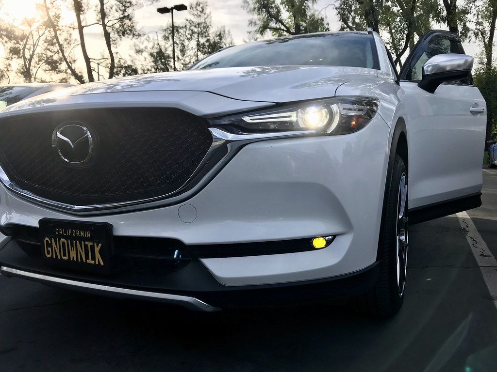

I love the LED headlights, they're great when conditions are good. In rain they do suck especially when there's not many reflectors on the road and our useless fog lights don't make a difference. I honestly believe they're just for show lol White light just bounces off the water. Even HID's are no good in rain. I've always had HIDs and always had poor visibility in the rain at night. When I had my 2009 pontiac vibe gt with halogen headlights and fog lights, I could see quite a bit better when driving in the rain at night. I'm tinting my fogs to make them yellow and see how they do in the rain. I have yellow overlay on but gives a lime greenish hue, waiting on some amber overlay to see if it'll give a deeper yellow and see if that helps visibility in the rain.

Haven't seen much aftermarket options for the 2017+ CX5. I've finally got my amber overlay and tinted the fogs, giving it a deeper yellow color and output. We're expecting some rain here next week so I'll see how it performs, if any better than the stock white LED.
