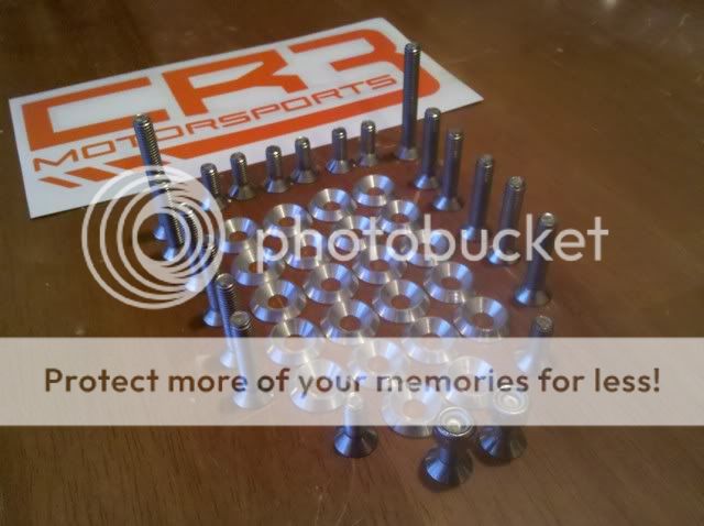

Got some goodies in the mail today. The engine dress up kit from CR3.
