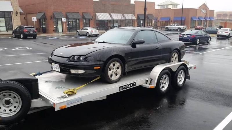

I picked up a 1993 MX-6 LS a friend found on Craigslist for $500. It had some front end damage and leaking oil pretty badly. My one friend drove an hour to check it out and test drive it, then brought it back to MD from VA with him. Then another friend and I drove out to MD from OH to pick it up with his truck and trailer. I can't thank Jose and Will enough for their help!!!
Of all the weekends I had to pick one with freezing rain to go pick up the car...

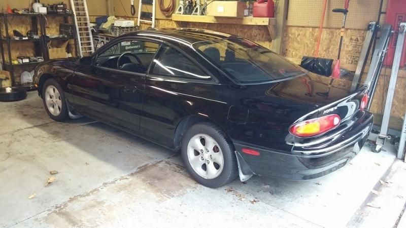

Here she is the day we picked her up in MD;
You can see the light damage to the drivers side headlight area and the hood wouldn't latch completely.
All washed and put in the garage;

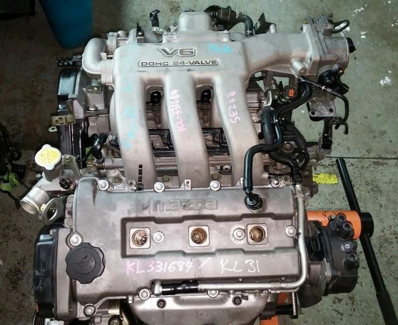

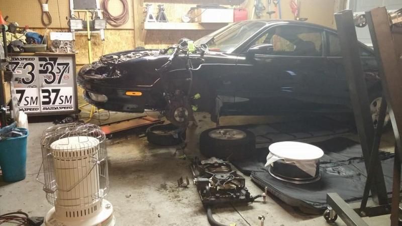

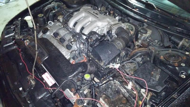

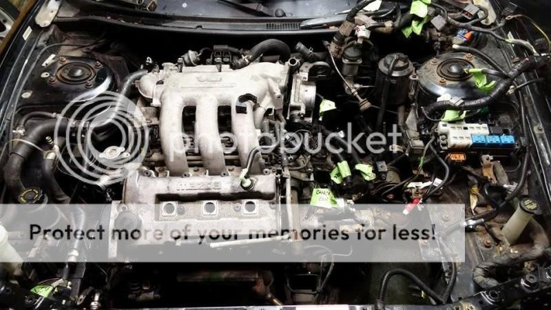

After struggling with trying to figure out where the oil leak was coming from (after a valve cover and front main seal replacement) found the front cam cap was scored really badly. So decided to pull the tired 168k mile KLDE and swap it with a JDM KLZE.
KLDE getting ready to be pulled;
How she sits in the garage as of 02/12/15;

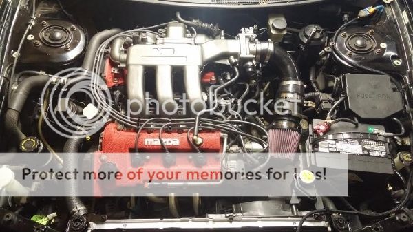

04/05/15 - KLZE installed and running

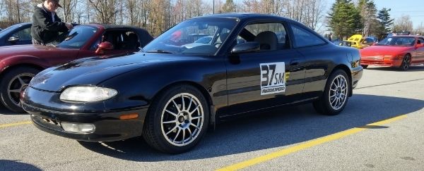

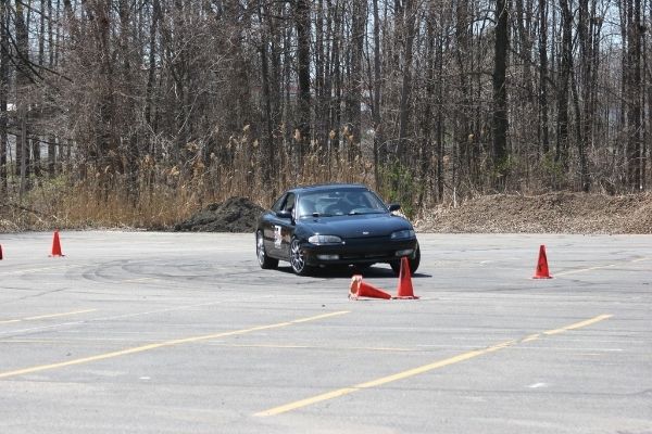

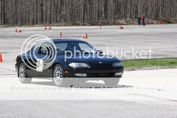

New suspension, wheels and rear sway bar installed and tested (auto-x) 04/26/2015

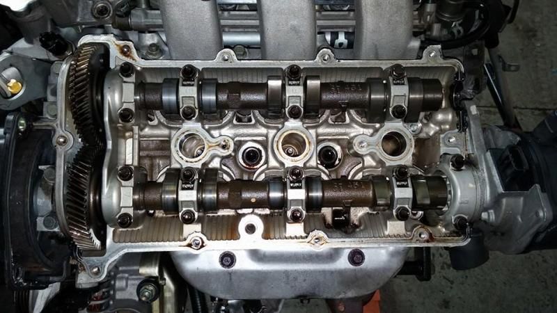

Got the KLZE home from work and on the engine stand. Everything looks good and is very clean so I'm quite pleased.
It's missing one VRIS actuator and solenoid for the IM but I'll steal one from the DE IM and swap it over. I was planning on doing some painting this weekend on the motor but it was just too bloody cold at around 1 degree.
Planning on painting the valve covers wrinkle red and the IM gunmetal.

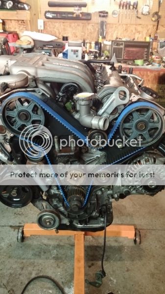

Little update, got the old motor ready to get pulled and the new motor buttoned up with a new TB tensioner, belts and a Gates RACING timing belt. I just liked the color, which will be completely covered up by the timing covers... :(
