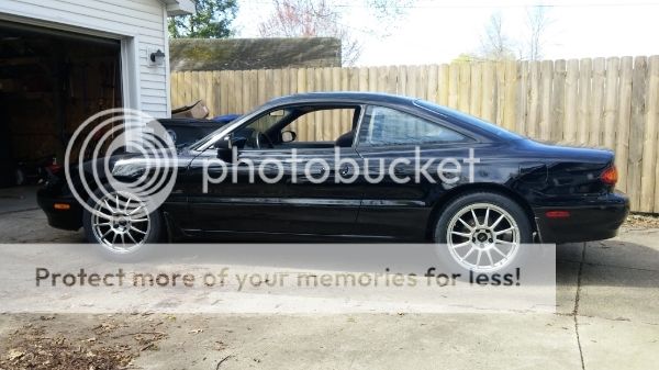

so what's going on the wheels a nice set of Hoosiers?
Motor looks great btw
Haha, no Hoosiers. I got some Hankook Ventus V12 Evo 2 (320 tread wear) summer tires sized 235/45-17. Nothing crazy.

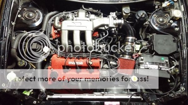

So close! I just need to pick up an oil filter and a good air filter from Summit and I'll attempt to fire her up this weekend. Fingers crossed...
The eBay air intake is designed for the USDM intake mani which is shorter so I had to mess with the couplers to get that angle. It isn't pretty but it's sealed and secure.
It's ALLLLIIIIIIVE!
(photobucket isn't playing nice, just a quick video of idle)
I primed the fuel pump a couple times then after a few cranks it fired up. But I was having a weird electrical surging and some whining from the alternator. I lent a friend my multimeter so I couldn't check it. But I bought a new alternator and all is well. But I was having a rough idle and it wouldn't rev past 2k rpm. I was looking around in the bay and sure enough forgot to hook up the VAF. Doh! Purrs like a kitten now.

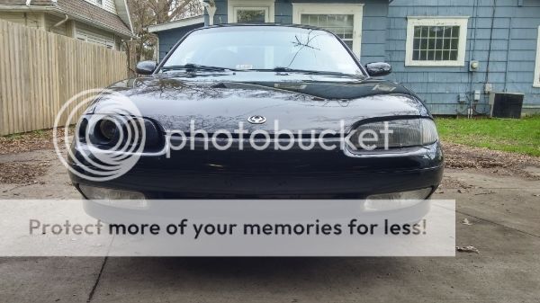

Drove it around the block a couple times and all seems well. I gotta swap out these terrible eBay headlights for the OE units I got. But first off to the BMV for title transfers, tags and e-check. No CEL ftw!

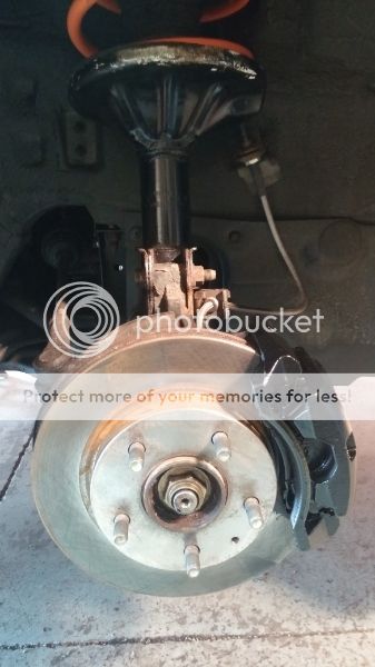

Then I swapped the suspension. I bought some Tokico Illumina's from a friend and paired them with some new Megan Racing lowering springs from eBay. I painted the struts because they were rusty and dirty. I also painted the calipers.
One of the rear struts needs a washer for the top hat nut as it is clunking. But I'll bang that out this weekend. And I believe the 626 struts may be taller than the MX6 struts so the rear is sitting a little higher than the front. Which really bugs me. So I might buy new rear struts. But moving on...

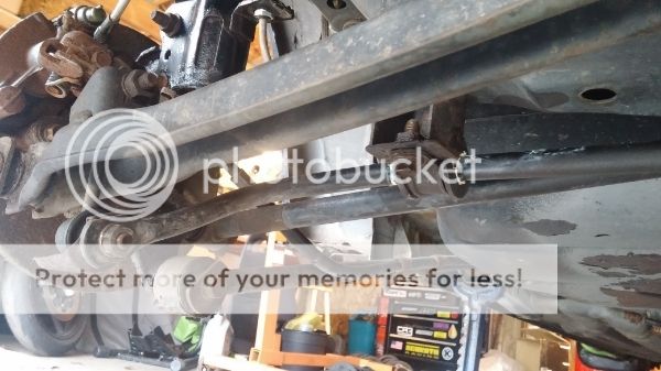

Removed the puny 12mm rear sway bar for a 16mm 626 sway bar.

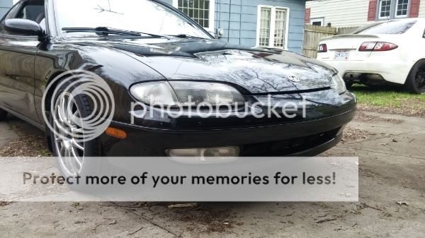

Replaced the hideous eBay headlights that came with the car with OE pieces I bought from a very cool fellow in Canada.
The OE headlights and corner lights look SO much better.

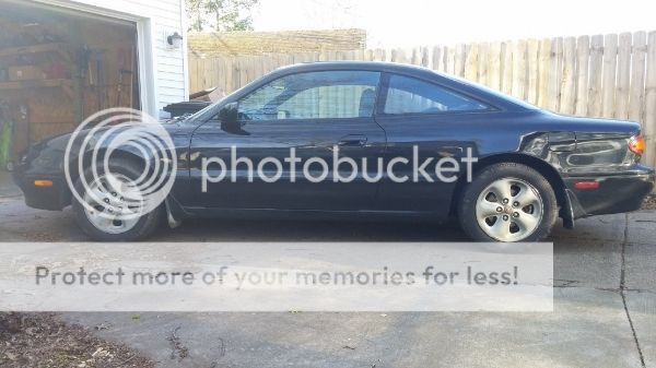

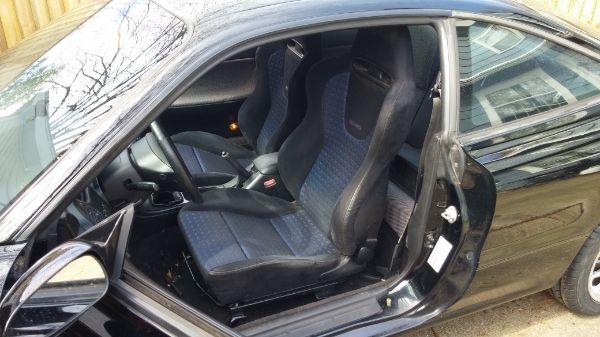

Bought back my old Evo 8 Recaros from a friend but they were way too tall. My head was touching the ceiling and no way I could fit with a helmet so he's taking them back and I put the stock seats back in.
Before;
After;

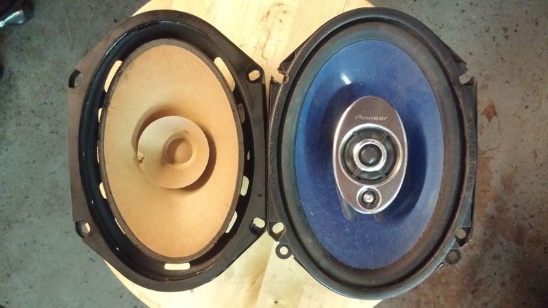

Replaced the rear deck speakers with some Pioneers from Corey. The stock speaker cones were completely blown out on both speakers. No wonder they sounded so bad. Much better now with the Pioneer head unit Fez sold me and the Rockford Fosgate front speakers Pablo sold me. Stereo actually sounds pretty good now.
