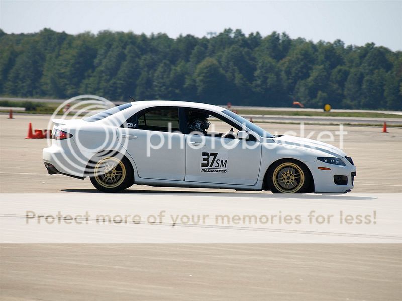

A nugget of knowledge from my Speed6 days...
Aj is right about the front sway upgrade will add understeer.
Back about 4 years ago it was track and autox proven that doing a springs/coilover swap and rear sway gave the perfect setup. Stock the car had understeer. If you add lowering springs or a coilover setup made for the Speed6, you'd get oversteer. Once you added an upgraded rear sway, you'd have a more balanced setup.
Now if you go with a higher spring rate, you may need to upgrade the front sway as well as the rear.
