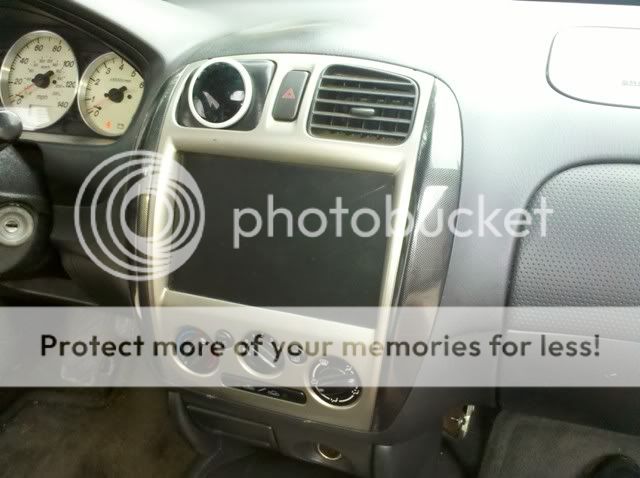

I did some cleaning today and made a block off plate from spare plastic we had at the shop. I'm going to mount a few gauges in it in the winter. After the Milly is running... Ugh, saving for a motor is taking forever. I know when I'm old when I look at an ugly, automatic Millenia and say "Damn, I can't wait to drive that thing.". haha :)
