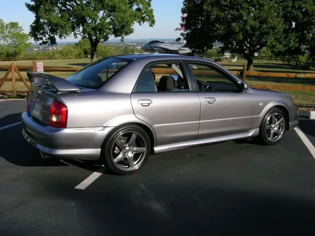

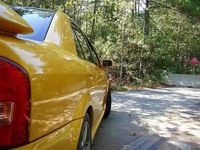

a very, very un-detailed list of my every week process:
Materials Used:
Rain-X Car soap/Cloth Wash Mit/Bug spunge/Tire brush
Meguires Spray Wax/NXT
2001 Tire Gloss/Armor-All
Stoner Invisiable Glass
California Water Blade
Microfiber towels/Shop Towels
Process:
rinse with JUST water throughly
wash rims (ENTIRE rim, width too) and tires (hose out the fender wells while im there)
use bug sponge for front grill and headlights
rinse out bucket and use fresh water and soap
wash roof, rear window, windshield and trunk area, rinse
wash passenger side (windows, doors, 1/4 panels, side skirts), rinse
wash driver side ("...........")
wash hood, several times, rinse several times
re-wash front bumper and headlights, rinse
wash rear bumper and muffler (entire muffler), rinse
wet dry (with water hose minus the nozzle, for maximum sheeting action)
California Water Blade entire car
go back with a microfiber towel and spot dry
open doors, wipe entire door jam down (under the door also)
pop the trunk, gas cap and hood and wipe those areas down
prop hood open and use a shop towel and wipe down the engine bay (everything i can possibly reach with my hand)
wipe down rims and tires with shop towel
use separate towel for glass and use Stoner Invisiable Glass and clean outside and inside windows
use 2001 for the engine bay on everything that is black plastic or rubber
Meguires Spray Wax entire car
Meguires NXT Wax entire car
sit back and enjoy the luster...(cheers)

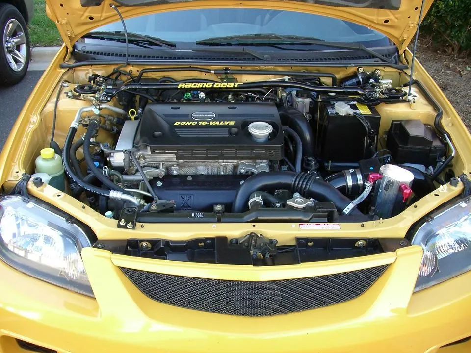

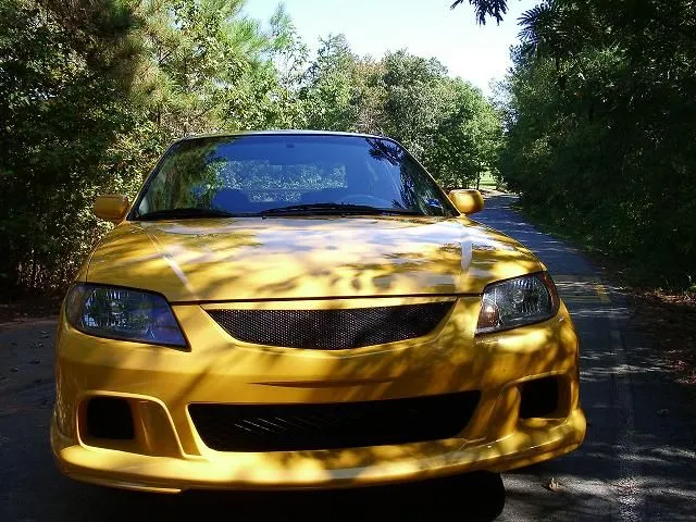

Put some NXT on that muffler tip too. :) I put sealant on my tip. I makes it much easier to clean in the future.
is it not clean enough for ya???? ;)
lol...things are rarely clean enough for me. :)
If you put some NXT on it, make sure to set aside a separate applicator pad for that. You don't want to get muffler soot on it and wipe that s*** back on your paint.

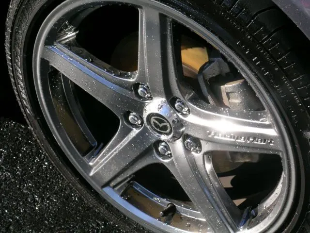

With sealed wheels, this is how easy they are to clean.
2 months worth of brake dust:
10 seconds later, after just a simple wipe with my wash mitt and car soap + water...
And I don't know how dirty the wheels are, but if I ever encounter stubborn brake dust, I use P21S Wheel Cleaner. It's a pH-neutral cleaner that is guaranteed never to harm ANY type of wheel. Some wheel cleaners are made for specific types of wheels (and can harm other types), but they don't always tell you that.
It can tackle some nasty brake dust with a little agitation. These wheels took me about 7-8 minutes each.
