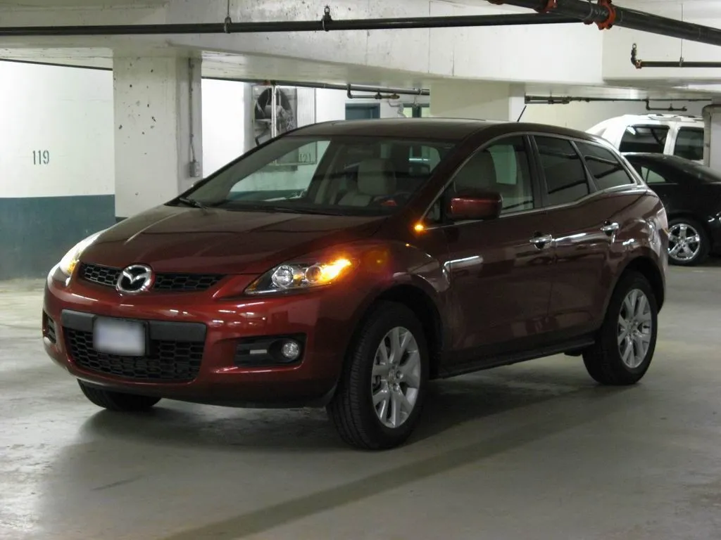

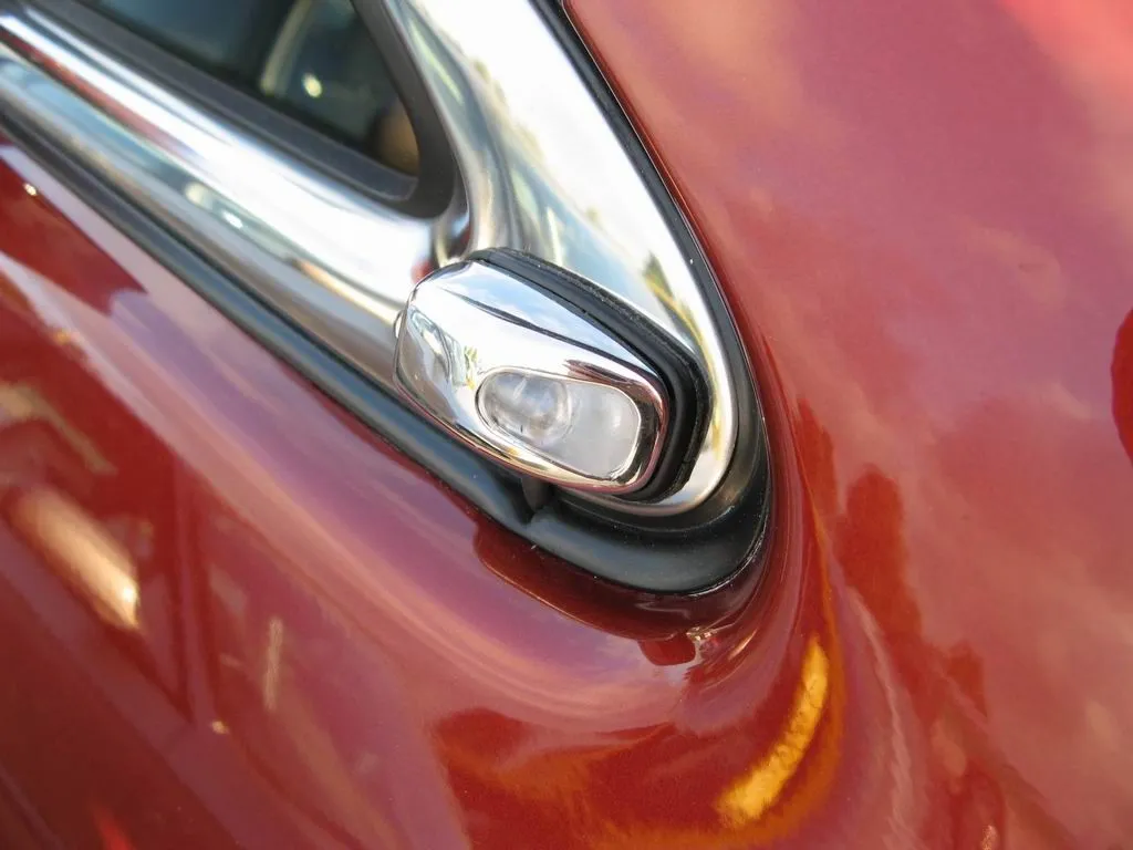

I found a chrome plated product at my local Canadian Tire (auto & home supply store) that is supposed to be an LED windshield washer nozzle replacement. With a bit of modifying it fits quite well on the chrome trim strip by the side mirrors.
The wiring was much easier than trying to get into the side mirrors, and it gives off a pretty good 180 beam

Hey, really ???. Sure it may not be OEM, but it was the best of a number of workarounds.
1. Replace side mirrors
2. Add LED strip to mirrors (product available but wiring more difficult)
3. Make front side marker blink (easy, but still hard to see from side)
4. Add side marker light (usually involves drilling body panel holes)
It sits pretty flush. 60,000mcd, 0.1A is really bright for its size

Ok, fair enough - it was a wiper LED when I started. I drilled out the wiper nozzle to allow for rear facing and front facing lamps. The front has a lens giving a diffused arc for the front quarter. Yellow matches the turn signal colouring front & rear, I'm not a big fan of the red rear turn signals other cars have.
The chrome looks identical to the trim plate, and it's only about 1.5" long anyway. There were some LED strips available, but I wanted something unobtrusive, and everything has mounting issues - unless you want to drill holes. I like the idea of the front fog light LED. Do you see that being turned on with the fog light or separate ?
