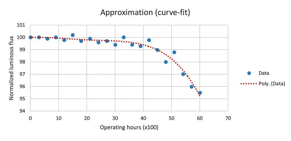

Could it be simple loss of output over time?

But OP’s CX-5 is only one year old? Although we don’t get ALH in the US, the LED headlights with AFS on my 2016 CX-5 GT with Tech are almost 4 years old (replaced both once due to failed LED DRLs at the end of 3rd year), I don’t see any degrading on light output so far. 3,000 ~ 4,000 operating hours are a long time for headlights, even if OP’s CX-5 uses LED headlights as DRLs like the US CX-5 although I highly doubt that would be the case with ALH.
