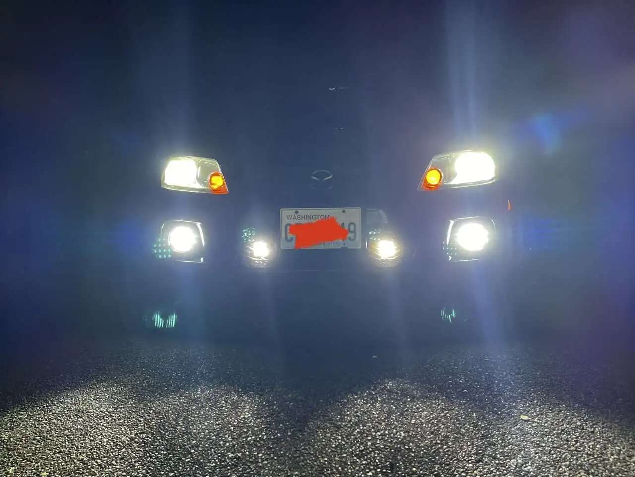

Here is them in action. From what I’ve seen they dissipate heat pretty well. These photos were taken at twilight so they may not show the full brightness

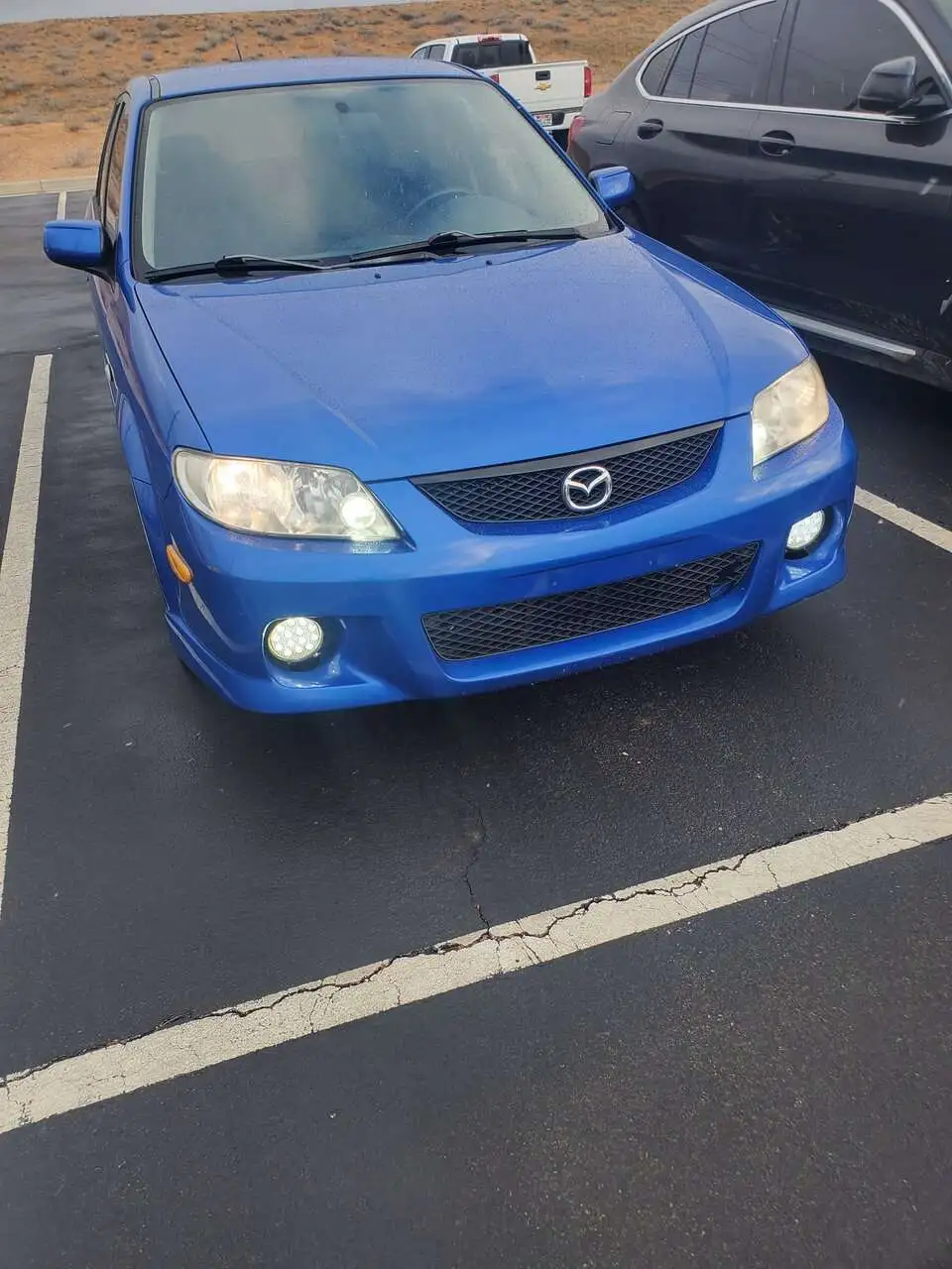

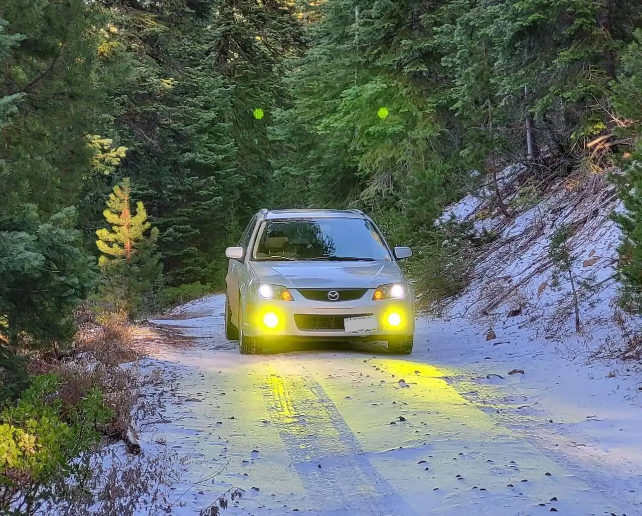

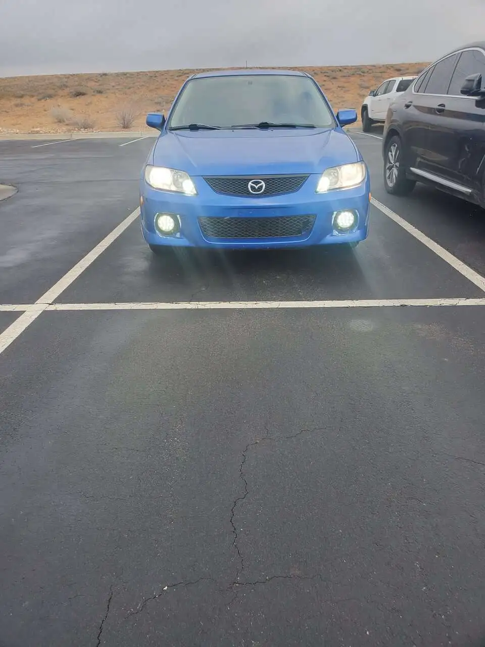

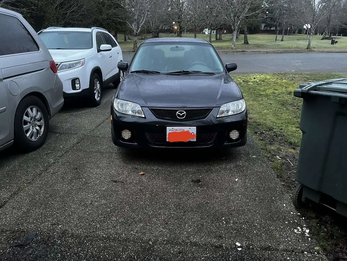

Looking good. The clear white LEDs look clean and almost stock on your black car. At least compared to my silver P5 with the amber version of those lights.
Now we need some pictures of the car from the outside with the lights on!
Nice! I was almost about to get those exact ones and have seen them on other P5s. I would guess they are just as bright and are obviously cheaper than the ones I went with.
I am a perfectionist though and the offset/smaller fitment in the stock fog light positions made me realize It would bother me too much to live with those since they are 4.5" in diameter. Just a personal preference thing though. Good to have functional options at all price points.
Mine are 5.5" diameter I believe and they're still a little small but don't bother me too much.
