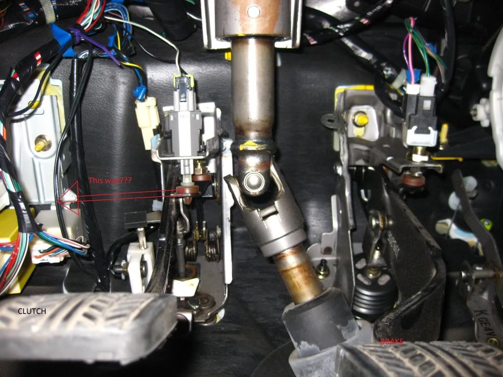

Uhh yeah So I can't find that black and white relay with lavender wires... can someone direct me? This is from a 2003 P5.
This is looking up at the steering column.

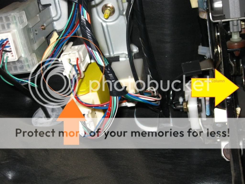

Basically the only relay I can see with four wires does not have lavender... only red, red/blue, blue, and blue-yellow.
OK, just in case anyone out there has had the same problem as me:
The one circled with the orange arrow above is indeed the relay you're looking for. It seems my color scheme is different than the OP's. The red wire is the one I connected to the spade connector. I did not wire it so the fogs will stay on with the high beams though. This was a super-simple wiring job, but sweet. I finally have day-time-running lights!
