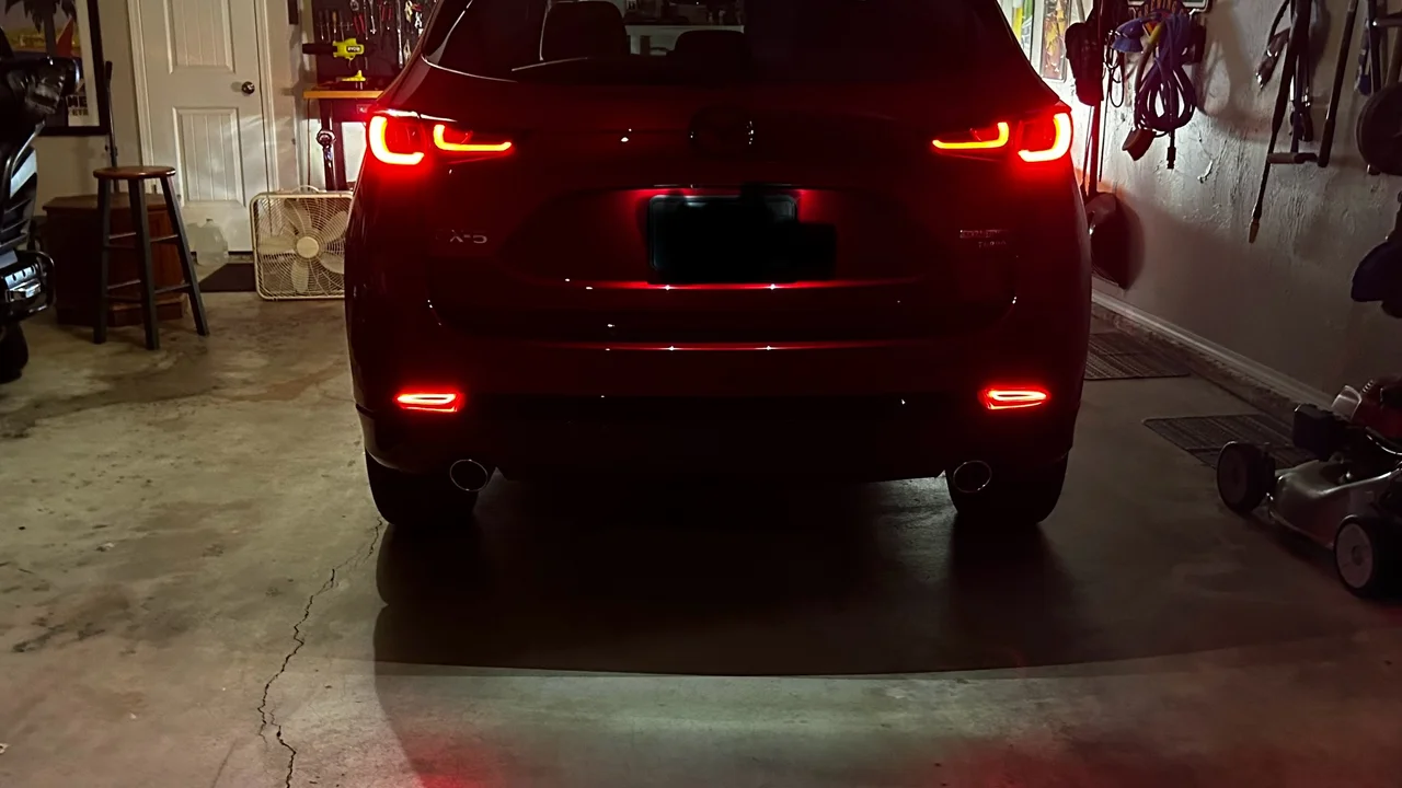

Are you referring to the leds that replace the bumper reflectors?

no I am not (even though I actually just ordered those), I bought an actual LED brake light strip but I’m sure the wiring is the same as the reflectors. Did you install those on your car?
Yes. To wire it, I pulled the side panels in the cargo off a bit to acsess the oem wire harness for each side. Then I used the irwin wire stripper to expose each lead without cutting the wire, then soldered the leads from the new light to the correct color of each oem lead. There’s a map of the wire function on the circuit board of each tail light assembly. Just remove the tail light assembly and unplug the connector. Then you can see what wire is brake, running, turn and ground.
