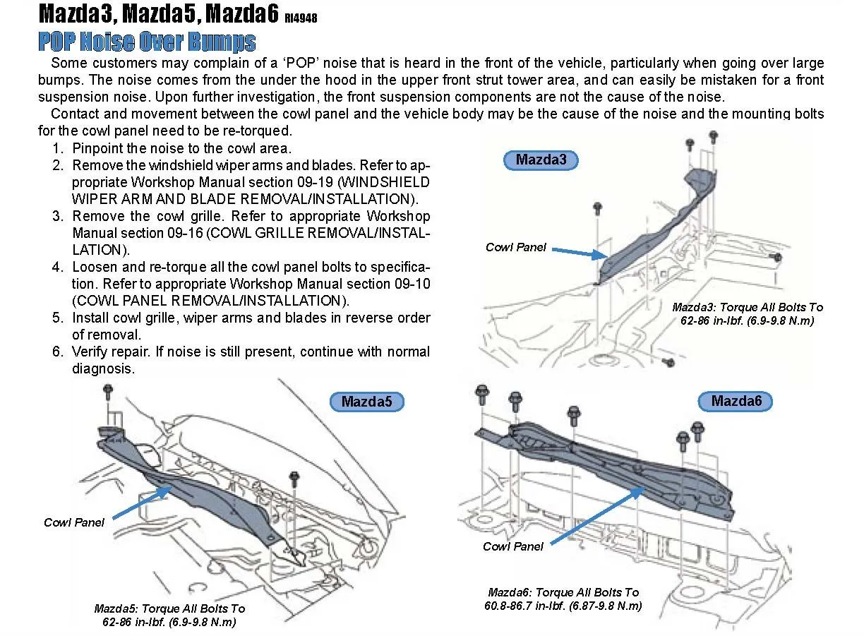

I had a popping noise going over speed bumps and through dips between streets where I live. I just had them re-torque my cowl panel bolts.
