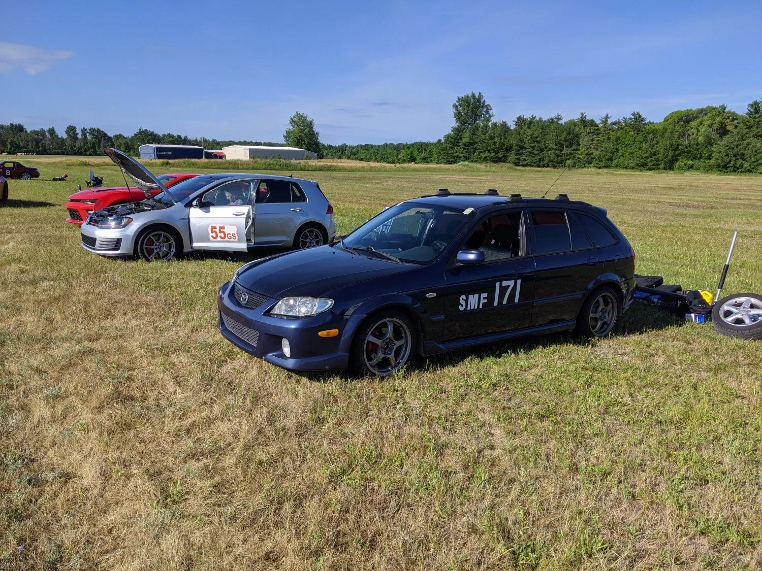

I autocrossed it and,
It didn't break!
Much excite.
Day before the event I decided to switch the power steering suction hose from the heater hose material to a 3/4" I.D. fuel rated hose. I don't have absurdly high hopes that this hose won't begin to ooze over time, but as a stop-gap measure, it worked well enough to get the car to and from the event without fuss.
Overall I was impressed with the car. Going into the event, I was slightly put at ease due to my friend's parents' house being local to the venue. If anything super broke, I could at least limp it there and work on it as time permitted.
Running now four-year old RE71Rs put a small damper on things, as there could have been more grip, however they handled the added power rather well. One thing that stuck out to me is the different driving style that comes with having an LSD installed. I found myself getting more comfortable directing the car with the throttle as the day progressed, and fell back into my "lift off and let the car rotate that way" driving style when it suited me. There was a Chicago box that I couldn't really figure out, so that was a bit of a bummer.
Comparing this to my mate's NA 3.0L swapped SVT Contour, I would have to say on this course, he probably could have had me easily. The added torque the 3.0L has down low allows it to really pull out of corners. Nevermind the fact that he's on Hoosiers.
I think I'll finish out the rest of this season on the existing tires and reassess what I want to do come the winter time with regards to refresher projects. Throwing on a modified OE front strut tower is relatively high up on the list as I never did get around to putting that on. Other than that, I could go ahead and start taking weight out, but I really don't mind having an otherwise stock looking car both inside and out.
Anyways, TL;DR here's a video of my fastest run
And a picture before the event.
Looks fun! Those appear to be some sticky ass tires! I've only ever ran all seasons and basic summer tires and also rarely been at track events. Do you ever plan on getting the KL swapped p5 dyno'd?
They are stickier when newer lol. I try and budget in a good set of winter tires and a good set of summers as I tend to drive the car hard when it's nice out.
I want to, but would like to get the exhaust put on first. That way I have a decent baseline for if I decide to tune/build it up more.

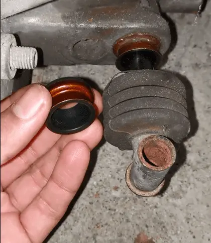

Update on the "do it" seal:
New replacement in hand. Of course, further inspection reveals that, indeed the transmission must come apart to correctly R&R the seal.
Older transmissions, by my observation, had provisions to remove the seal without taking the transmission apart. This however, is not the case here.
Hoping to get the transmission on a bench and apart this coming weekend. May put the 'box back in while I'm home, as that would shorten the to-do list whilst the weather is miserable out.
Fixes; tenatively. I'll put the lump in next weekend.

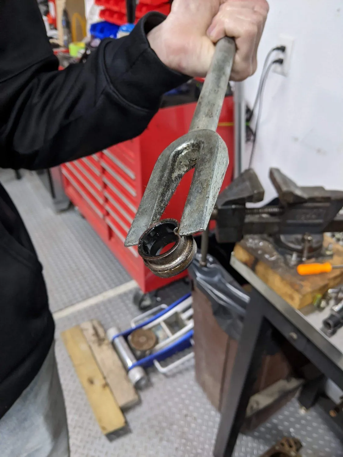

Note: a pickle fork and force applied in a shear motion will pop out the shift-shaft seal. Accurate application of force? No, probably not. But it worked, and didn't damage anything beyond repair!
Pickle Forks are an awesome tool.
Every kitchen needs one... Lol
Regular forks don't work very well at all.
The pickles just bounce around in the jar.
You gotta stab one. Lol

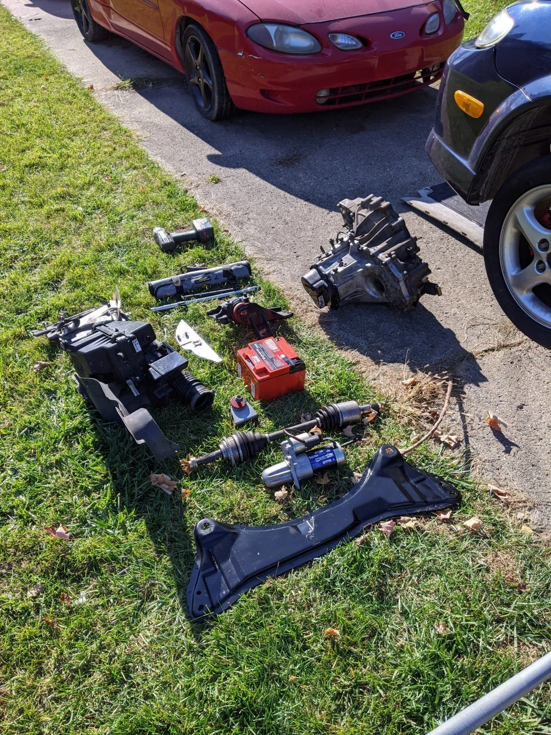

A rather frustrating update: transmission is in
BUT there's a noise, a new noise, that my mate reckons is the 5th gear rubbing on the case cap.
On our friend's road-race car, this is a chore to remove the cap due to the stiff motor mounts from AWR, but since I'm running a Rockauto replacement passenger side one, I reckon pulling the front mount and transmission mount should afford me the room I need to inspect that area.
That's a task for when it's warmer and I want to deal with it again. The warm snap is leaving in a few days, and working on cold metal isn't my idea of a fun time...

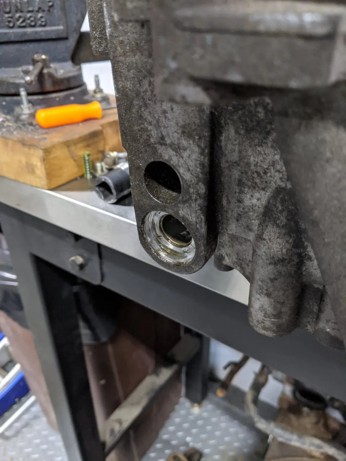

Bad news, but news nonetheless.
I think that I may have cracked the transmission right in the area where the VSS plonks into. This may have all come about as a result of beating on the thing at the autocross almost a year ago, but I was chasing the issue thinking it was the shift shaft seal (it wasn't) and then moved on to the o-ring that seals the VSS into the transmission.
I would clean the backside of the bellhousing up, start it, leave it in neutral; no issues.
I then put it in gear and left it in gear for a few minutes and that's when it would start to weep. But it didn't weep in a "normal" sense out of the o-ring.
I mis-diagnosed it as the shift shaft seal because the fluid would run down the back side of the bellhousing next to the rear motor mount, and then it would run down and around the shift shaft seal.
Numerous times I'd re-sealed the VSS o-ring, with RTV, and it would still leak.
I looked in the bore after suggestion to do so by my mate and there's a diagonal score in the bore that continues into the transmission case further.
I'll take the transmission out and assess what to do from here. My own fault for not running a trans saver brace. I genuinely didn't think they'd do much, but I'm now discovering firsthand that they do. I'm not sure if others have suffered a similar fate on the MSP given relatively similar power outputs with the added torque being applied down low? I can't be the first person to experience this failure, but I've not seen this particular issue mentioned much.

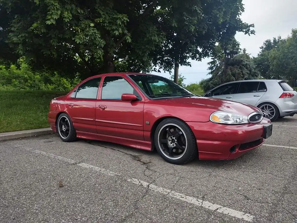

In other news, I now own this...
1998 SVT Contour. I think that it'll be a welcomed change from the Mazda. Maybe make me appreciate what I have with the Mazda as far as simplicity goes 😂😅 It needs some TLC mechanically, but the chassis itself is near immaculate. I plan to keep it stock in terms of the interior. Scored a 3L engine to go with it, so that will be the project for the summer while I keep an ear to the ground as to what the scoop is with the KL transmission. That motor needs some refreshing too.
Now I'm not on the road for work, this should be an easier feat, fixing things, and breaking them again!
Dang that's a nasty, weird leak! Good to hear you've narrowed down where it's possibly coming from.
Excuse the ignorance, where does the trans brace normally sit?
Never seen a Contour before! It's like a mixup of the Probe and a mk1 Mondeo front end, neat!

I know! I was seriously irked thinking it was the shift shaft seal. Realistically that may not have had to been replaced, but here we are!

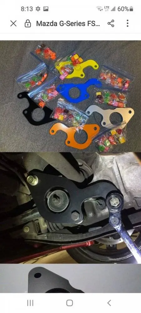

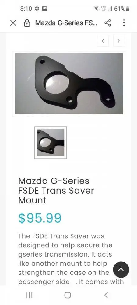

I hope this is allowed; this is a seller who's got a photo of the brace. Looking at it, the brace sort of secures the differential housing a bit better from behind. Hope the pictures on the site help/show up!
Oh heck yeah! So the Contour is our Mondeo "sister." It was meant to be Ford's first global vehicle. I might try and put another thread together for it. Expect slow updates for that though - I'm going to take my time working on it :)
I'm sure you're fine. I post all kinds of links and pictures. Lol
Yup.
I see them...
Holy Crap !! 96 bucks !!!??
I'm sure that Lanki can fabricate his own brace for free.
So do those braces come with packages of glitter so that you can customize the artwork ?? Lol
... Looking at it, the brace sort of secures the differential housing a bit better from behind.
I'm not questioning the value of having the brace.
I'm questioning the value of having that particular brace.
It just looks like a $16 part with an $80 paint job...
I did just spend $113 last week to have my car undercoated again, so I guess it's sort of the same thing ??
I've spent more in the past two years undercoating my car than what the car is worth as scrap.
I laughed at this. When I saw the price, my reaction was "Holy crap, only 96 bucks?"
I guess the aftermarket autoparts industry is used to making custom things and selling them at a huge profit, and I'm used to seeing that price as normal. Sometimes RockAuto looks like a scam until you realize that the other guys are the ones marking it up.
I can definitely see this part being easy for a machinist to do in a day for much cheaper than $96.
Yeah, each one is custom made.
If all P5's had a transmission brace, they would be mass produced for cheap.
I'm no machinist, but I would try to make my own if I needed one.
I've got a drill press, a grinder, and a dremel tool. Lol
I actually have a half a mind to have the shop where I work laser out a brace out of 14ga ss material... I had a skid plate made back in 2012 that I never did install made of 14ga ss, and to say that thing could have survived a boulder impact would be an understatement. It's only got to add some stiffness. I could double them up if needed too...
