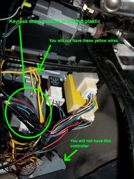

I'm having trouble finding the keyless entry module. I see the yellow door lock module but which I can't find the keyless one? Can someone give me a better explanation or take a picture?
Here's a nice big image for you. (beer)
...and since i'm nice- there's a slightly smaller version attached
