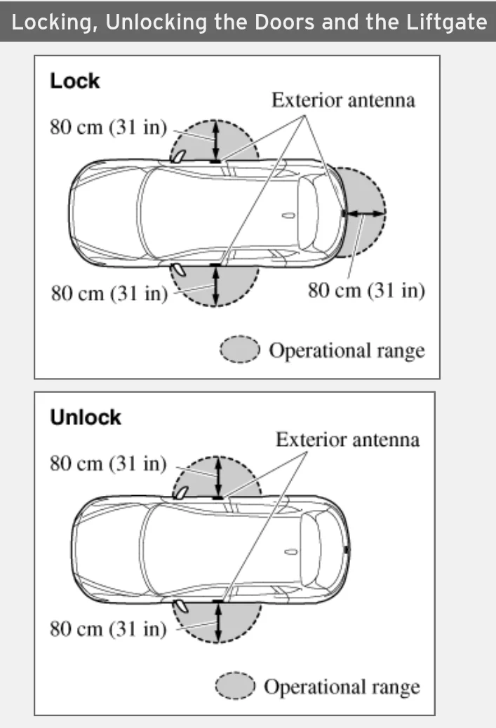

At least in my 2019, the doors will only automatically lock if the car can detect the key outside the car when the last door closes and if that's the case, it will beep once when the last door closes and once when the key walks away and it actually locks.
According to my manual, the key has to be within 31 inches of the driver, passenger door, or tailgates to detect it.
So I just always listen for the beep when I close the door and hit the lock button if it doesn't beep - that happens when I'm in a rush and too far away by the time the door closes.
