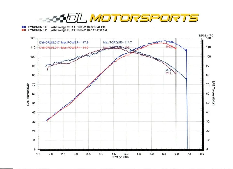

Everyone, check out my dyno chart. I know it may be a different power curve than the FSs, but the principle is the same. In my 1-2 shift, the RPM drops 3000RPM. If I shift at peak, which is 6500(where I make 117whp), it'll drop to 3500(where I make 70whp). Now, I make about 107whp at 7400RPM. For that entire band between 6500 and 7400, I make about 30-45 more hp than if I had shifted, and ran from 3500-4900(where I still only make 104whp). So in my powerband, there is not one spot below say...5200RPM, where I make more hp than at fuel cut. My point? Just because you're past peak power, doesn't mean you're making less power than 3000RPM earlier.
