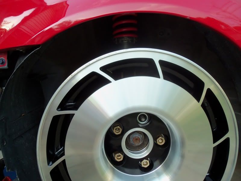

not between, the guy wasnt even sure if he could get to it, so i had him polish the whole facem including the black center
Wow, those are some huge wheels, Simon. I'm very curious to see how they turn out. What rubber and size do you plan on running?
I dont think I should tell you...it'll prob make you cringe lol i was looking at 205/40's, not sure on what brand yet, have to look around. I was thinking kumhos (had like 4 sets of them on my car and never had any problems) but I dont know how well those stretch

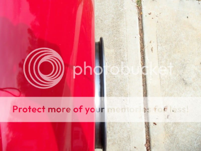

Ill take better pic of the fitment, that pic i posted on the car makes them look alot bigger then they are

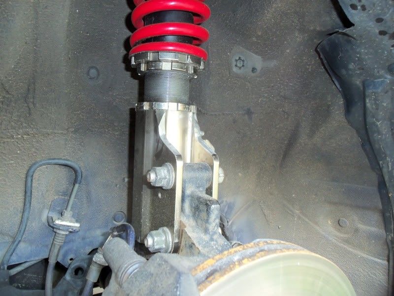

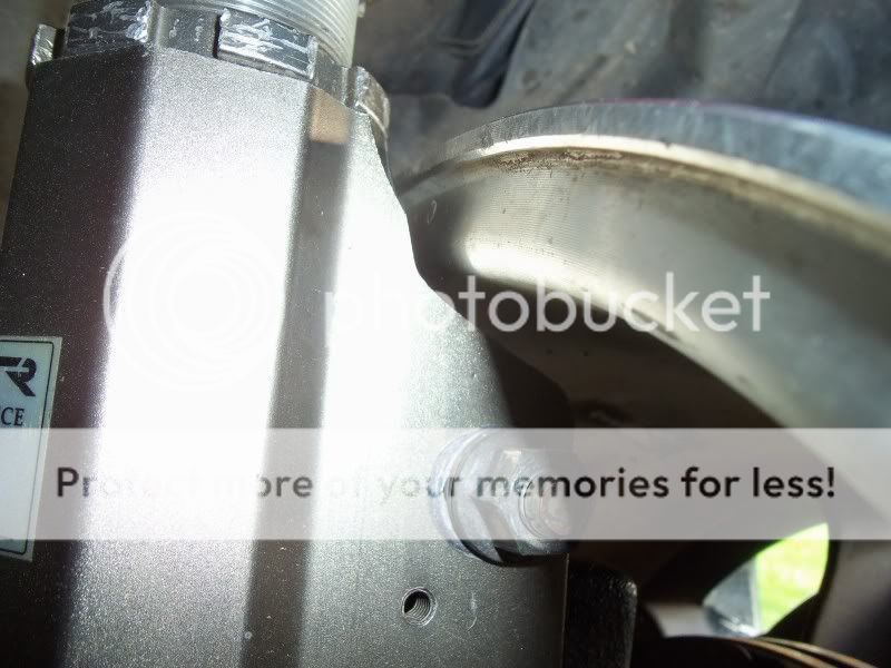

Right now ive been working on grinding the strut mount down to clear the wheel, I was using a dremel, but then remembered I had an angle grinder lol its going pretty good, ill still need to run a 5mm hubcentric spacer and hubcentric ring to get the wheel on there perfectly. I may have to splurge on some AWR camber plates too...slots arent going to work with a wheel this wide.
i actually think the wheels will look good, but i think youd be a lot happier with a 215 or 225....
IT FITS!! Just finished grinding down the strut mount, the wheel bolts up perfectly and clears everything. check the pics

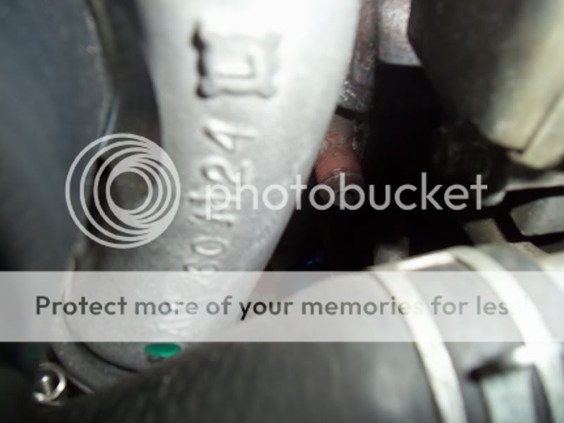

man, im so relieved. I thought my car was ****** up, turns out my EGR cap fell off the manifold. How i have no clue but its gone. I started the car up with the exhaust (just finished videos will follow tomorrow) and the quiet exhaust note let me here a HUGE exhaust leak. No wonder my car was running like ass.
Buying one tomorrow before work if i get up early enough, then un doing what i messed with on the map, and going for a drive :D
(2thumbs) It's always that weird little s*** that breaks. Glad it's an easy fix, mate!
