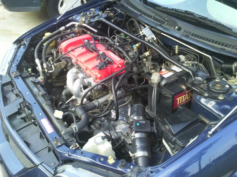

I don't remember who did it, but someone drilled a whole in a large hose clamp and used that so the air temp sensor wouldn't pop out.
wow, great idea^ and in a MSP the MAF and the IAT are both in the intake, but since i relocated my MAF to the pressure pipes, this kinda makes it a problem
but yea, im def going to try that hose clamp idea

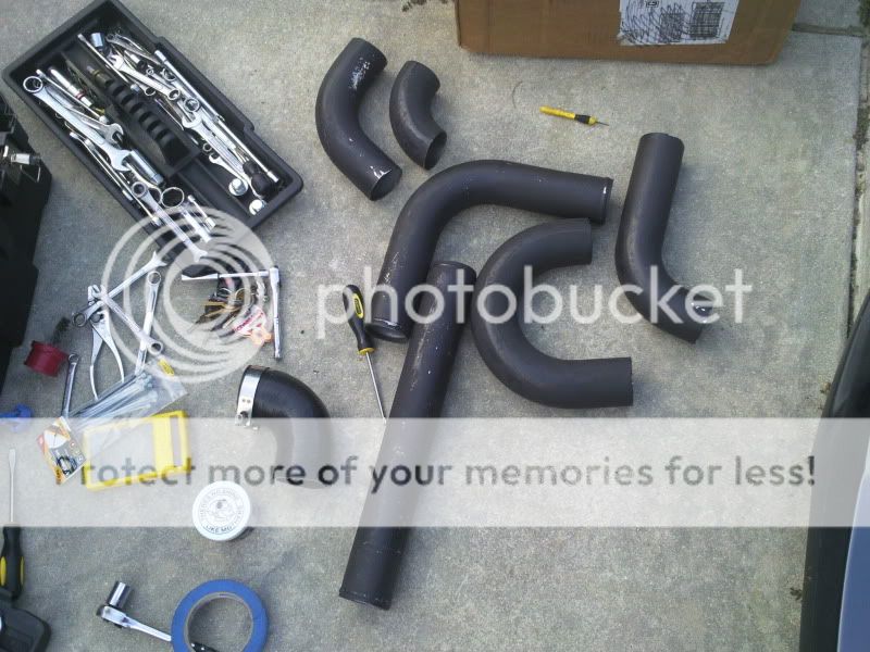

and a little update, got 2 alum pipes on the car to replace the heavy rusted steel pipes
they look pretty good and they are like 3 times lighter lol
ill have some pics in a sec, and the ground clearance is pretty small with the new route i took so i may have to raise my car up and run my 17's for a while
^will do
annd pics as promised
the finish isnt great, but i paid 50 bucks for them, i can take the time to spray them again
the split coupler is just so the pipe doesnt rattle against the frame

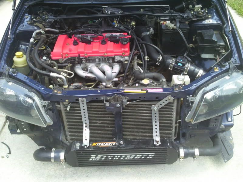

my awesome brackets for my FMIC lol
EDIT: oh btw, this is just temp routing, its kinda ghetto rigged and goes from 2.5" to 2" it a bunch of places
i have to order new couplers so i can put the rest of the piping on
