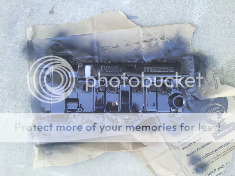

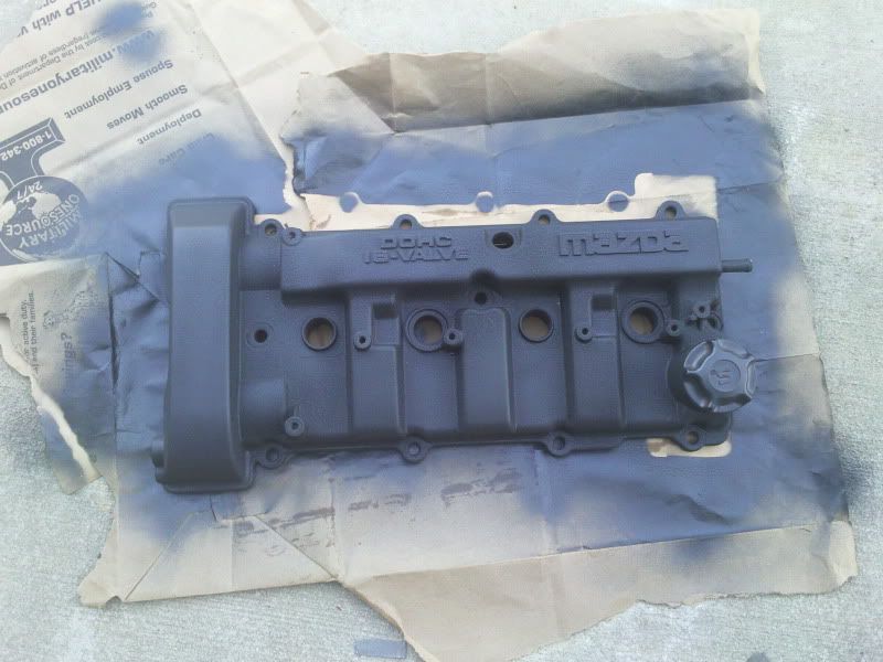

k here are some pics, painted my valve cover again today
old to new
these pics came out alot blurrier (more blurry? idk) then i thought they would

nope lol wrinkle black paint, i was thinking of using rubberized undercoating but i didnt think it would hold up to the heat very well

andddd..i touched up the valve cover, still had some pink showing around the letters, and now it looks wierd where i touched it up..damit, not sure what im gonna do about that

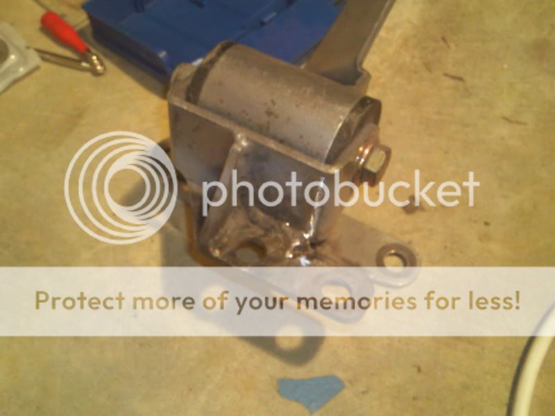

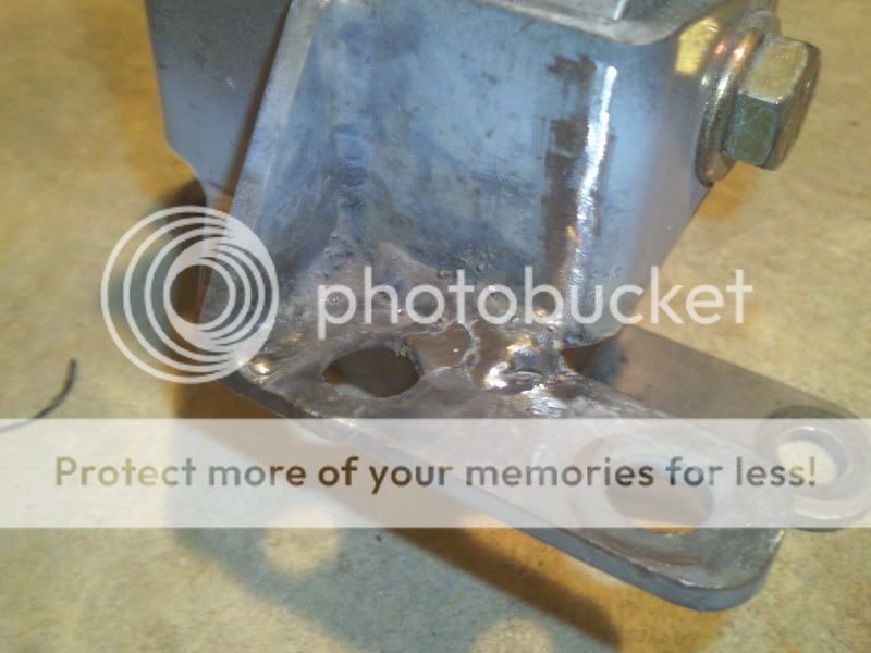

alsoooo, today i worked on my brothers broken AWR side engine mount, here some picsss
im aware the welds look bad, im grinding them down anyways so i wasnt concerned with looks lol
notice the stack o dimes lol i made it pretty there cuz thats really the only part you'll see directly
oh..and i welded a triangle of metal on there to help support the mount, that part broke off twice so the triangle support should help
not sure why the AWR didnt come like this to begin with, so now there is a triangle that the mount came with, then one in between the bolt holes

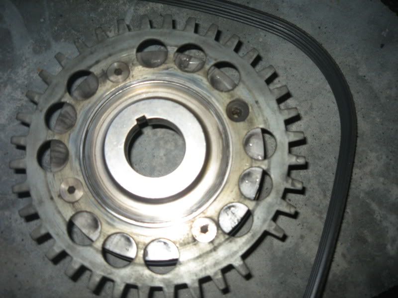

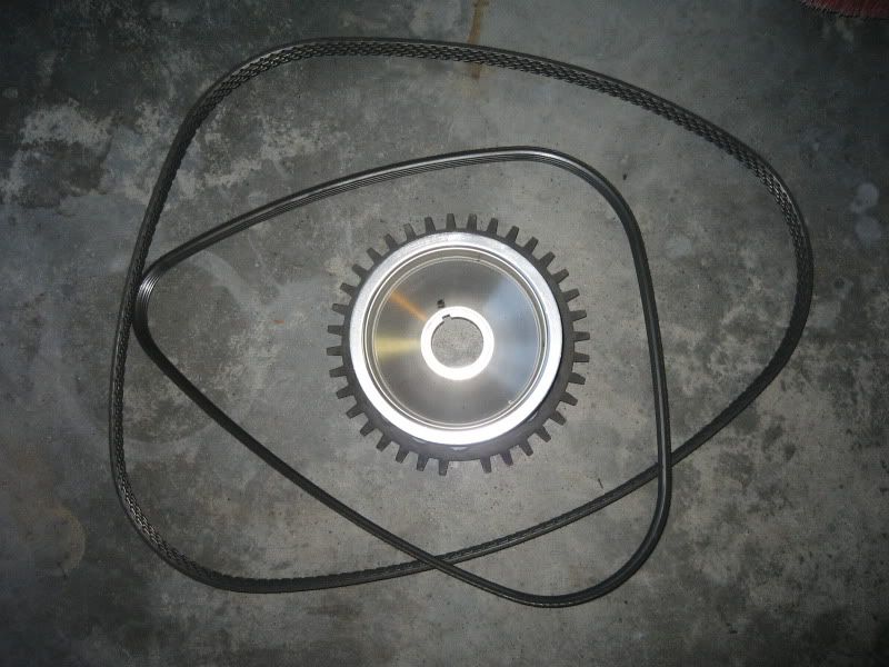

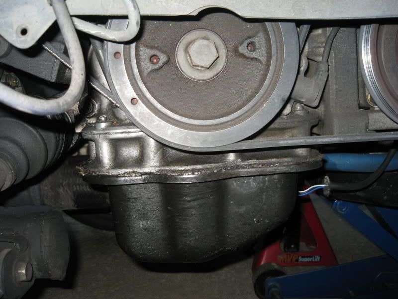

also have some pics of my UDP removal, I was getting a terrible belt squeel sort of noise on take off and i couldnt figure out what it was, turned out a bolt came out of the back of the UDP and was letting the teeth just slap around on the pulley
Ill put those pics up as soon as i figure how to get them off my moms camera....
alright well here we go, got the pics up
stock pulley back in place
UDP and belts off (its for sale if anyone is interested, just missing one bolt)
you can see the bolt that was missing...my timing cover was pretty ****** up, might have to order a new one

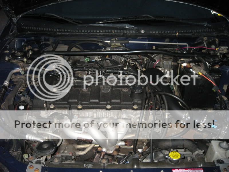

rats nest....as soon as I get some time, im tucking the harness under the IM, and taking the IM off and grinding it smooth
should look pretty good, thinking about silver paint instead of black this time, might port it a little too

yea lol it was pretty bad, car runs better with the stock pulley, no more noise outside the car :)
