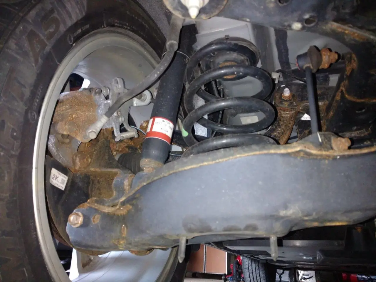

Watching this tread with great interest. I live in NYC and we use road salt here. Looking at the photos from Jaman, IMHO I don't think that is an excessive amount of rust for four Canadian winters. I do my own oil changes, so if I were under the car an observed that I might choose to hit it with a some of rustoleum rust reformer, but honestly to my eye it looks pretty normal for any four year old car in a place where road salt is used, and where no remedial steps (such as post winter cleaning of the undercarriage or undercoating) were taken. I had, and now my GF has a 1998 Toyota Rav4 that spent its life on Long Island. You should see the underside of that thing. Its still structurally sound. Like I said...just my humble opinion. Is there anyone out there that has a 4 year old vehicle from a place that uses road salt, and who hasn't taken remedial steps to protect the undercarriage that has NO rust? As far as the hatch struts, that is certainly a design defect. Perforation corrosion is what concerns me. That undercarriage looks normal....to me.

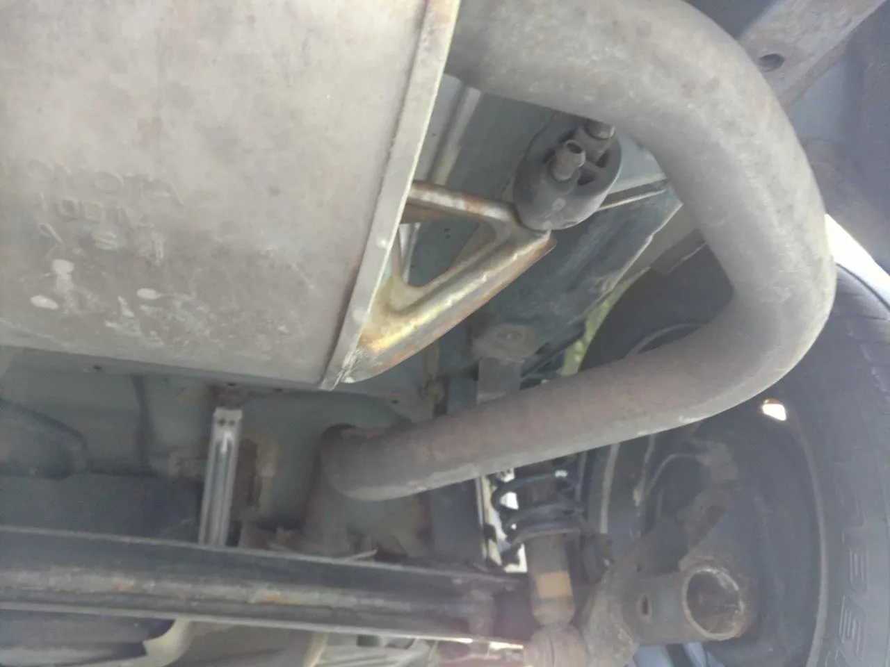

Rust like that after a few years even with heavy use of salt I believe is unacceptable with today's coatings and materials to look worse than a car that is 13 years old is not acceptable. How can Mazda get away with this? I love how this car drives and looks but also want one that will last. Also very happy with fuel economy so far getting around 30.5MPG on my 100 mile round trip commute.
2005 toyota matrix/pontiac vibe - 225K miles driving 100 miles a day
2014 CX-5 (seen 2 winters) -28K miles

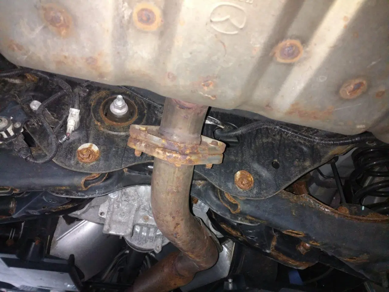

attachment.php

As PVQ said all of the photos above look typical for cars going through Canadian-like winters without additional protection. As soon as you hit the first winter surface rust will start forming on the underside to anything exposed. It's unreasonable to expect it to look new-ish for years in a climate such as ours where the roads are regularly treated with the harsh chemicals that they are.

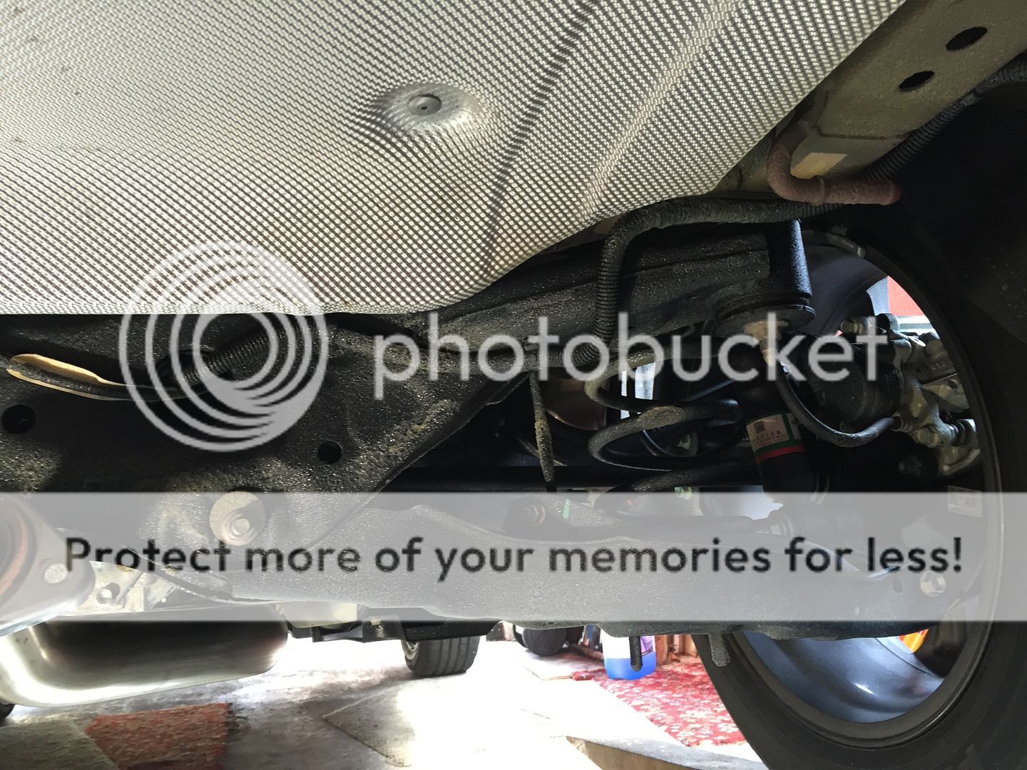

Just checked. Mine looks quite good for two Maine winters. Happy with what I see.
But as usual, I find adding photos to this site from my iPhone to be a royal pain in the ass. I think I've got two rear undercarriage pics in my account but they won't show up in the library. Might not be able to get them into this thread until tomorrow.
Edit- pics added.

It's very reasonable to expect no surface rust formed in undercarriage area after 2 or 3 winters. Did you see OP Fish1 comparison pictures between his 2005 Toyota Matrix and 2014 Mazda CX-5 in the same winter environment? We don't see any rust on these "exposed" suspension bolts and nuts on his 12-year-old Toyota. My 1998 Honda CR-V don't show any rust in the similar area after 19 winters with road salt although it may not as much as in the North. Actually those suspension bolts and nuts, like the bolts used on liftgate struts, do have protection to prevent the rust. They're all at least zinc plated or better galvanized. Only poor quality zinc plated bolts and nuts would show any sign of rust after short period of time exposing the road salt. Not to mention several members have said they've found rust under the seat area which has nothing to do with the road salt!
Edit- pics added.

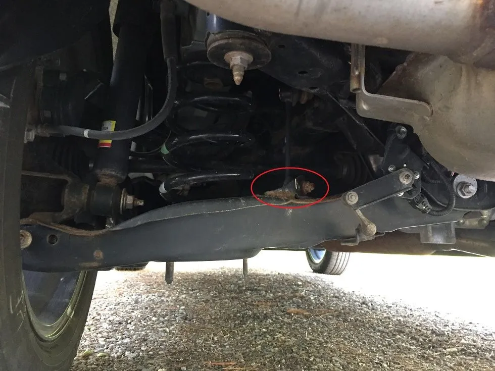

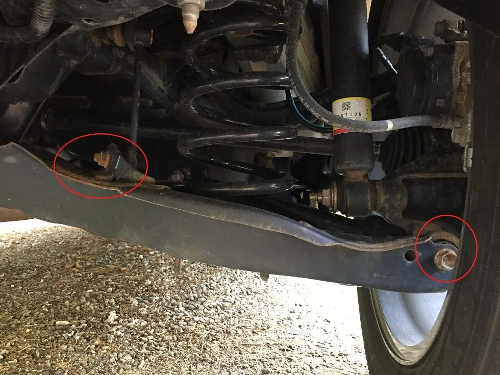

Actually I wouldn't be too happy if my 2016 CX-5 has alraeady had these surface rust forming on few suspension bolts and nuts.
