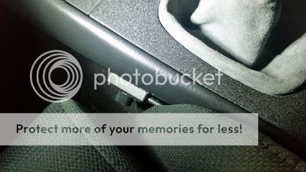

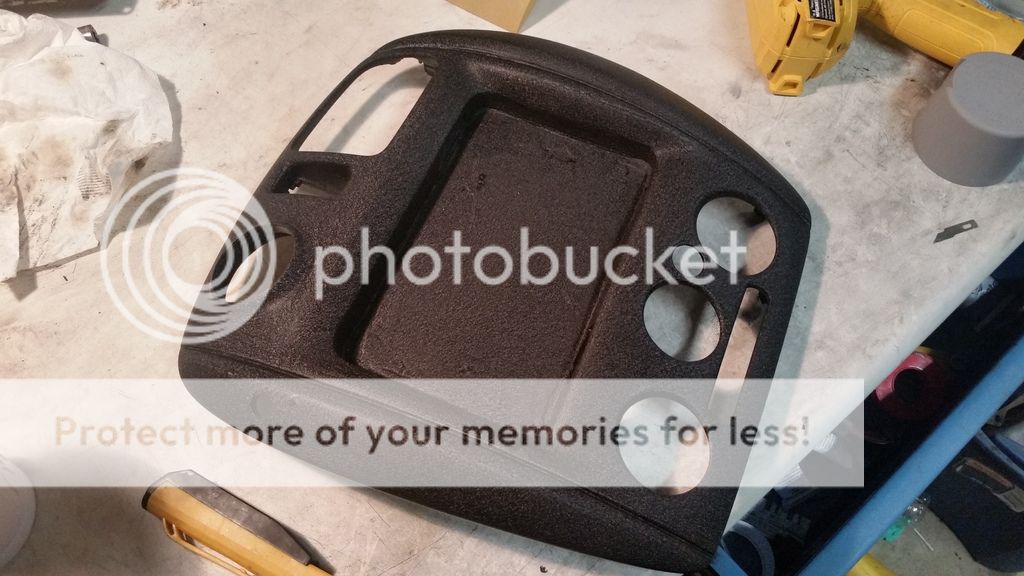

Mounted my remote volume control knob for the tablet that I hope to install soon. Still working on the bezel for it. All it needs are the sides to be grey suede wrapped.

Not a good pic yet, still need to get one during the day, and shoulda turned the tablet brightness down, but you guys get the idea, I'm stoked.
