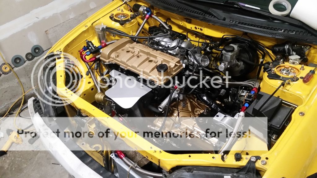

Thanks, I like it alot. That valve cover in the picture is actually a lighter shade of gold than the block/trans. The actual one I have is the correct color. That one was just to keep dust out until it's all put together.
Hopefully the paint holds up.

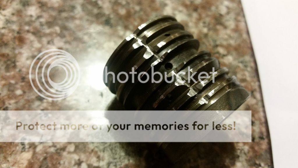

Forgot to mention how I depowered the steering rack without getting the pinion shaft welded. I followed the method used by Maxx Mazda in his build thread, albeit a little less nicely than him, but it should be as functional.
When the valve body is removed it creates room for the joint in the pinion shaft to move a little, creating slop. I don't have access to any welding shops nearby, so I took it out, removed all the seals, and cut three grooves through all the fluid paths. It takes up the slop and won't try to cycle the grease, which would add resistance to the steering. And best of all, it's quick, easy and free!

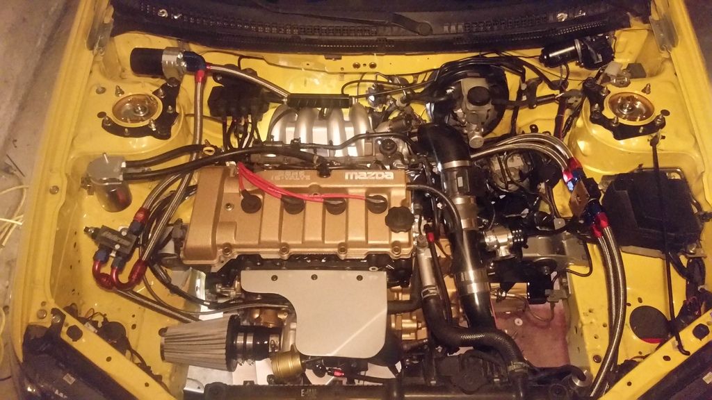

Long day, but it's in. Still got lots to do, and it's a little hectic in the bay right now. But here it is. Also realized that one of my wheel bearings is bad. That was a bummer.

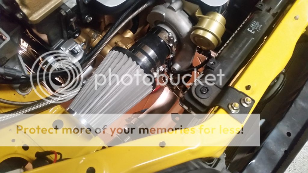

Got the j-pipe installed, clutch bled (act stage 1, which feels great by the way), put on my jdm valve cover w/ a new gasket, installed o2 and wideband sensors, filled oil cooler (about 3/4 Qt capacity), tightened all an fittings, mounted coils and plug wires, remounted fuel rail w/ stock injectors.

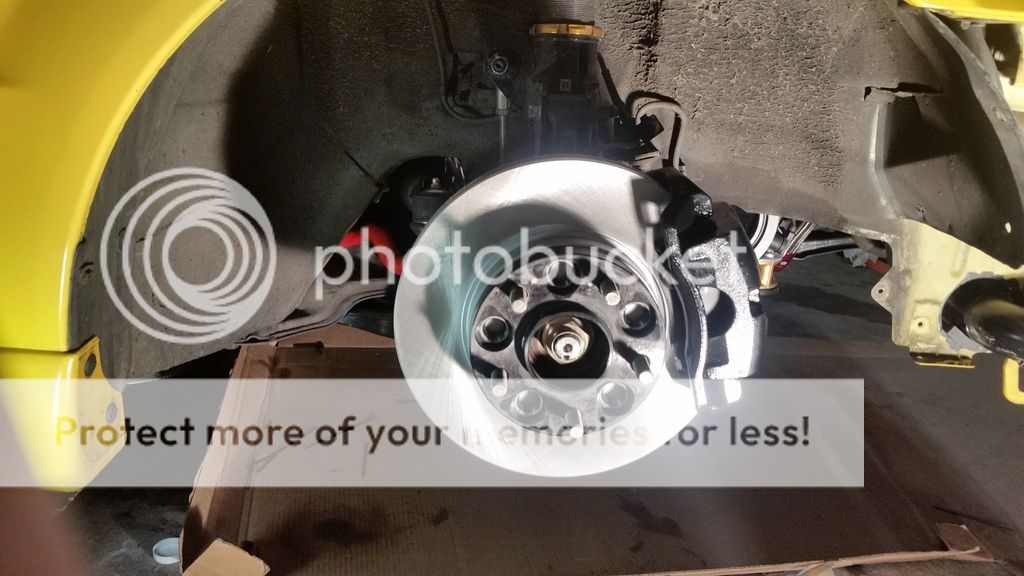

Both axles popped in, passenger side put up a fight though, passenger side suspension and brakes complete. 626 v6 brakes look great. Arp extended lug studs re-installed into the new hub.

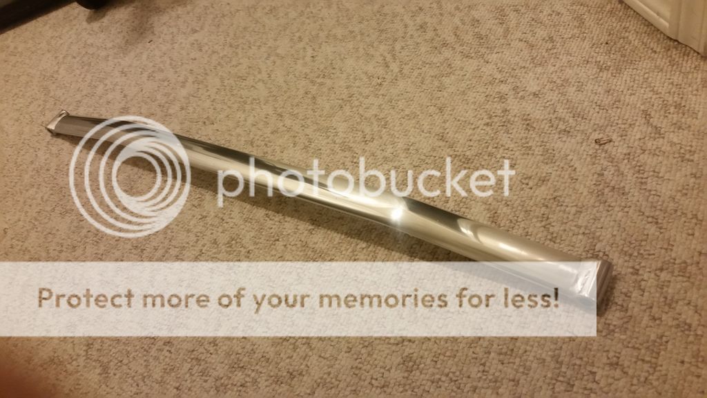

Also had time to fix the center portion of my corksport strut tower bar. Sanded with 400, 800, 1500, then polished. Still little pits here and there, but it came back to life.
