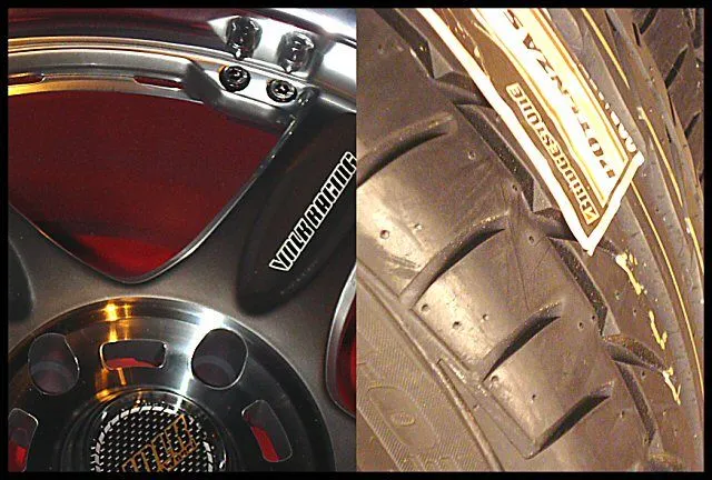

Just a Tease...
They go on the car Thursday.
Can't wait!!! (yippy)
Yup, GT-C. 18x8 +50.
Tires are Pole Positon S03, 225/45-18.
I'll probably be rolling those fenders just to be safe.
Took for-freakin-ever for these wheels to get here, so it's like Christmas for me.
All the online wheel calculators pointed towards +50 being the more desirable offset for our car considering the width of the wheel and tire. I'm like 2mm closer to the suspension and 14mm further out towards the fender.

this is good info, I have debated on rims for like 2 months because this car is a PITA to get the right offset for. Never had wheel/offset issues on my other cars. I was trying to get 42 offset, I was thinking 42mm being a :lower" number meant lower offset than 50mm, shows how much i know about offsets and wheels! I just want it to stick out more and be closer to the fenders. so 50 is the way to go??? How about on a 7.5-width wheel
it will. im running 18x8 +40 te37's
thanks man. i'm looking forward to mine.. 3 months to go lmao
worst case scenario is my fender's gotta be rolled right?
+50 in x7.5 or x8 wheels would fit man. i had to choose between 18x7.5 +43 or 18x7.5 +50.. and i went with the +43. more aggressive but it should fit
