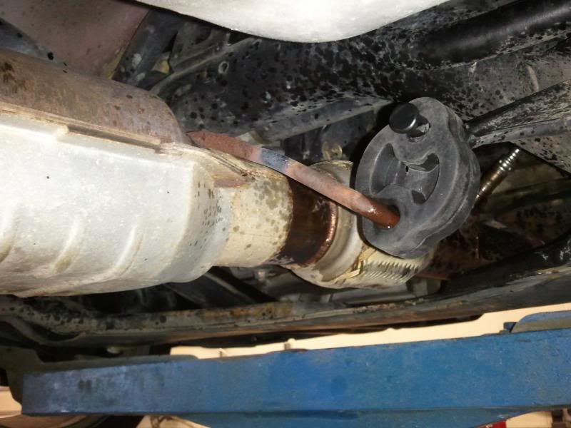

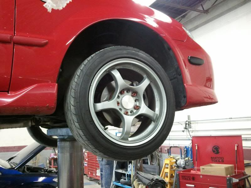

On a good note though, fixed my exhaust rattle, installed my passanger side wheel liner, and also may have found this clunk in the front left I was concerned about. My strut bar wasn't fully tight on that side. Tried to make the clunk on the way home (I can create it at will) and I don't think I heard it. You know how paranoid you are after you think you've solved a problem....you're always on guard, so any little noise you're like..."What was that!? Was that it again!?" hahaha If I did hear it, it was no where near as bad as it was.

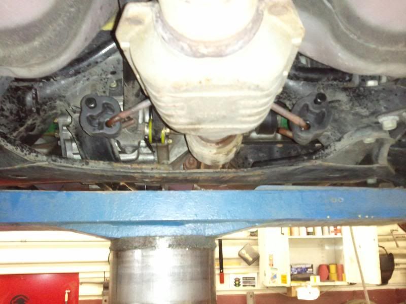

You can see the broken hanger and how the exhaust is ON the crossmember.
All better. :)
I heated up the hanger a bit and angled it down so it would pull the exhaust up. Then installed 2 new rubber hangers.

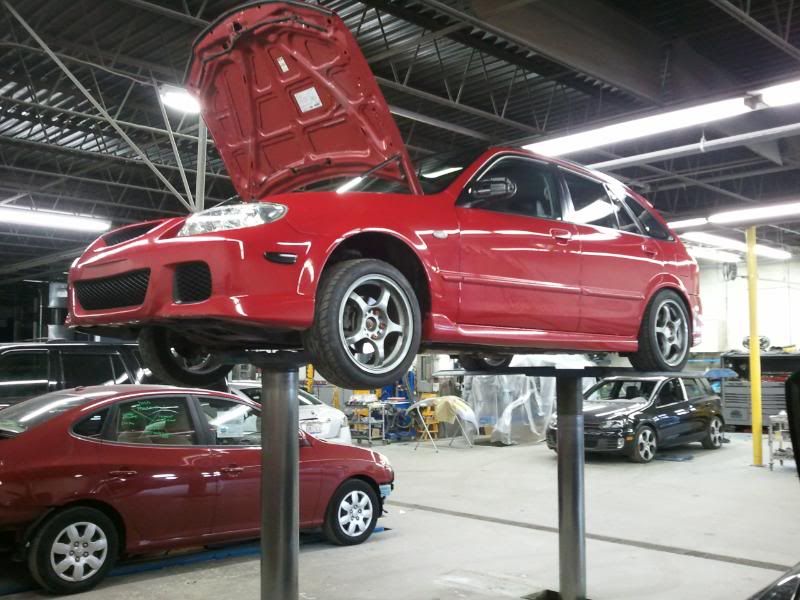

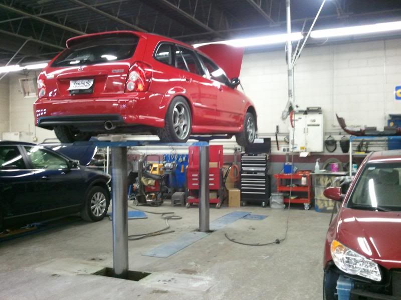

LOVE having a lift in my stall at work!!! Even if they're 40 years old. lol
