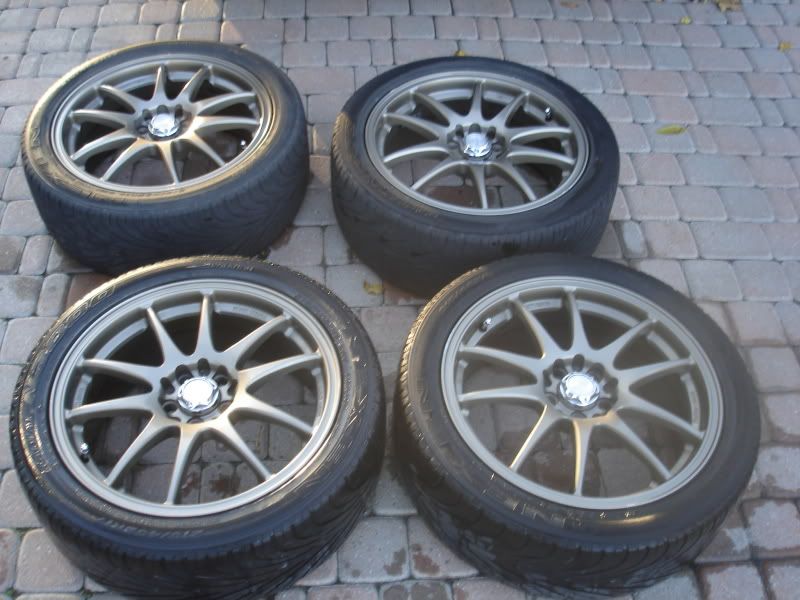

of course the day after I put my winter rims and tires on the car I pull the trigger on a new set of summer wheels.
my fiance decided she was unhappy with the oem rims on her mazda6, so I gave her my 17" mazda3 gt wheels, bought her some brand new all seasons and then picked these rims up for next summer.
they are K speed brand. I think they are like 5 years or more old, but all look to be in decent shape with mounted 215/45/17s..might throw em on just to see how they look mounted later this week. Still trying to find specs about the rims somewhere online, seller did not know the details. they require hubcentric rings and came with a set of tuner lugs. trying to source some blue anodized tuner lugs to replace the chrome ones that came with the rims.
