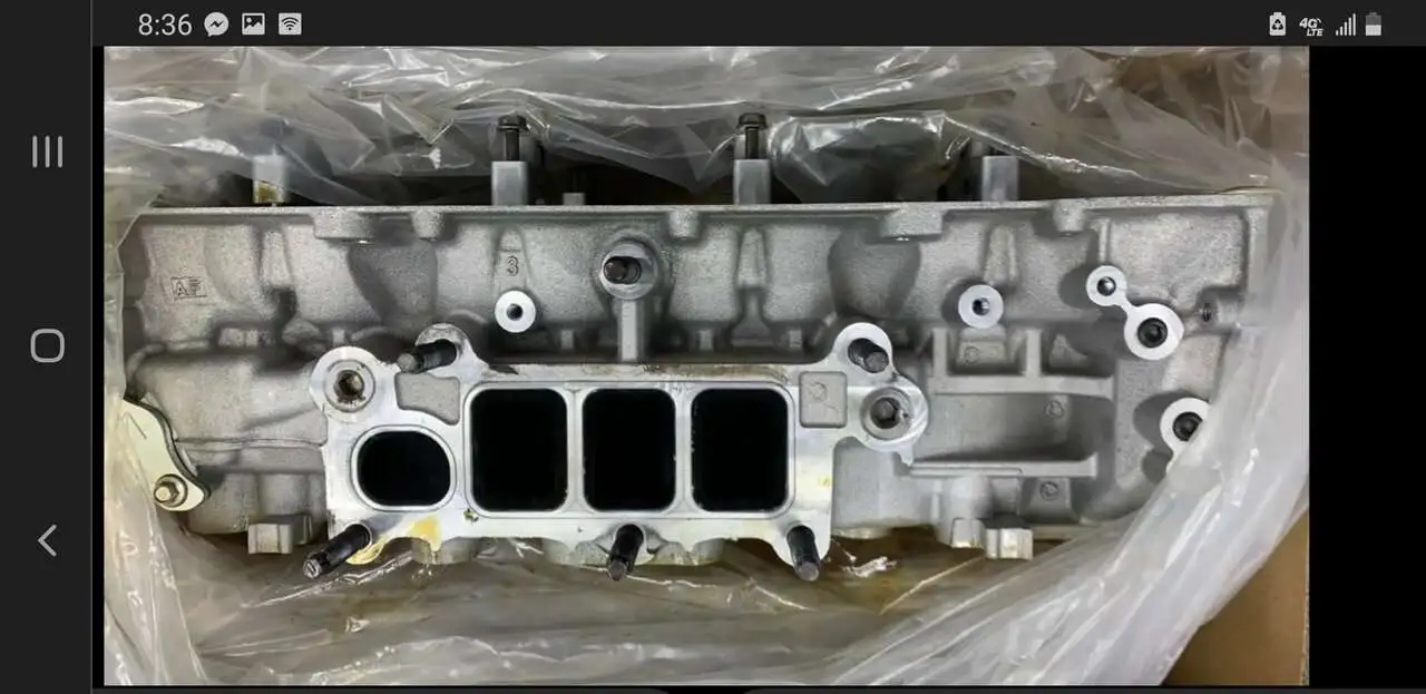

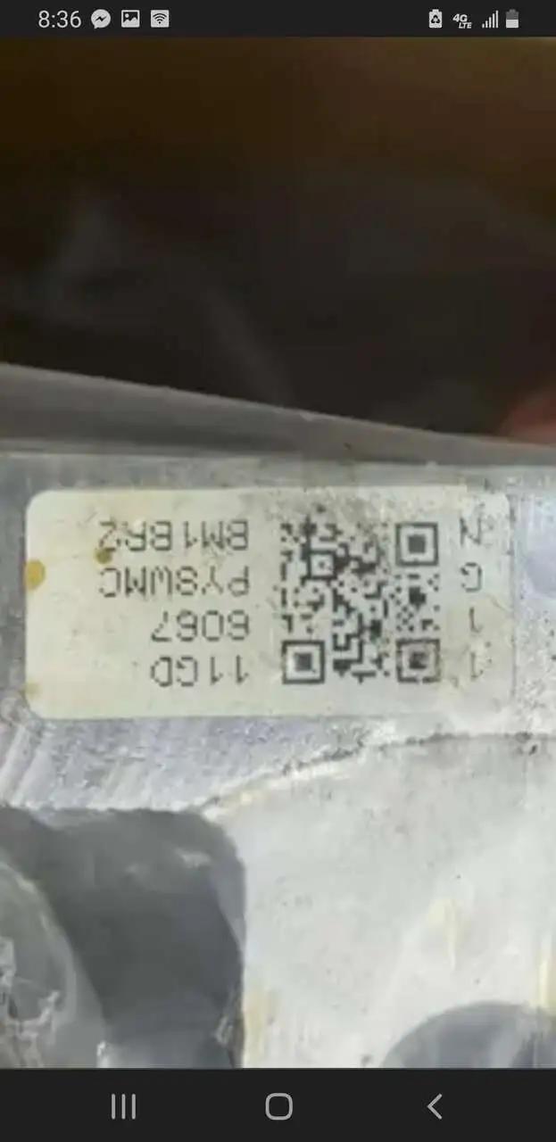

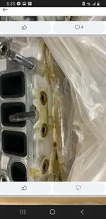

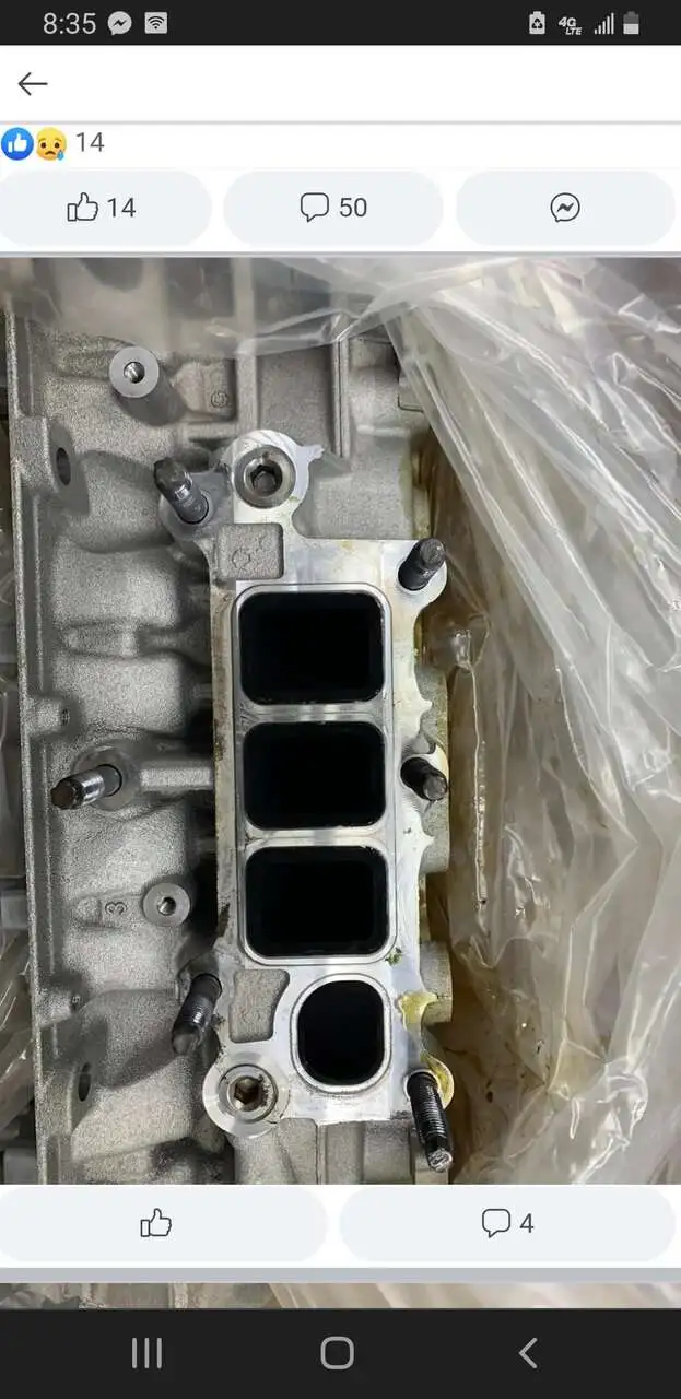

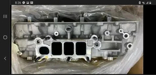

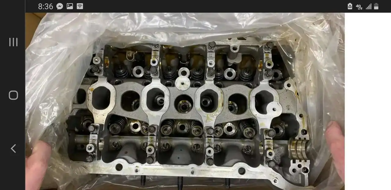

This car was built 6 months after the tsb. Should have the updated head. Facebook post says dealer pulled this cracked head off a CX9 built Jan 2021. I spent a ton of time looking at the castings and comparing it to the TSB but it looks identical. Anybody know what the changes actually were on the updated head? I know the TSB said the exhaust gasket was changed. I wonder if all they did was just put in deeper exhaust studs? These pictures are from the head that was removed from his CX9, built Jan 2021, that was leaking coolant. He said he was not told the location of leak which would have been REALLY interesting.

I believe this 2.5 turbo engine is still a solid engine. But being a mechanic my whole life for the life of me I can't see any physical difference on these two heads. I bet some machine shop in California that does head repair or restore probably knows. My curiosity is just killing me.

And what makes this even more difficult to figure out is that the stamped part numbers on the head are only partials (PYFA on mine). The full numbers must be contained in the QR codes, and I haven't been able to determine what's going on with those either. No complete part numbers that I've been able to find - so far anyway.

The head changes might be increased thicknesses of aluminum around the exhaust studs which would be difficult or impossible to see visually. You would probably have to section some heads to see the differences.
Yea, thats kinda what i thought they did. But if they added aluminum around those studs, it wasn't very much. Fingers crossed on my 2022. Just wont do any dukes and hazard jumping and I will be fine! Haha
