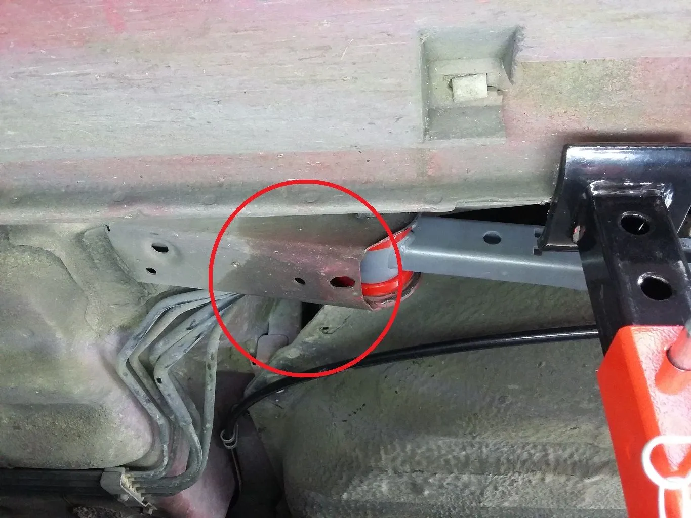

The rear jack point is directly in front of the trailing arm mounts,

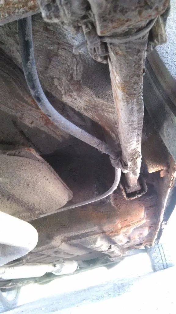

I used the proper rear mounting points but my car is so rusty that the T-stands punched right through the metal.
I can't use the cars scissor jack at the proper lifting point either.
It also punched right through the body.
I don't know what will happen if I need to change a tire on the side of the road?

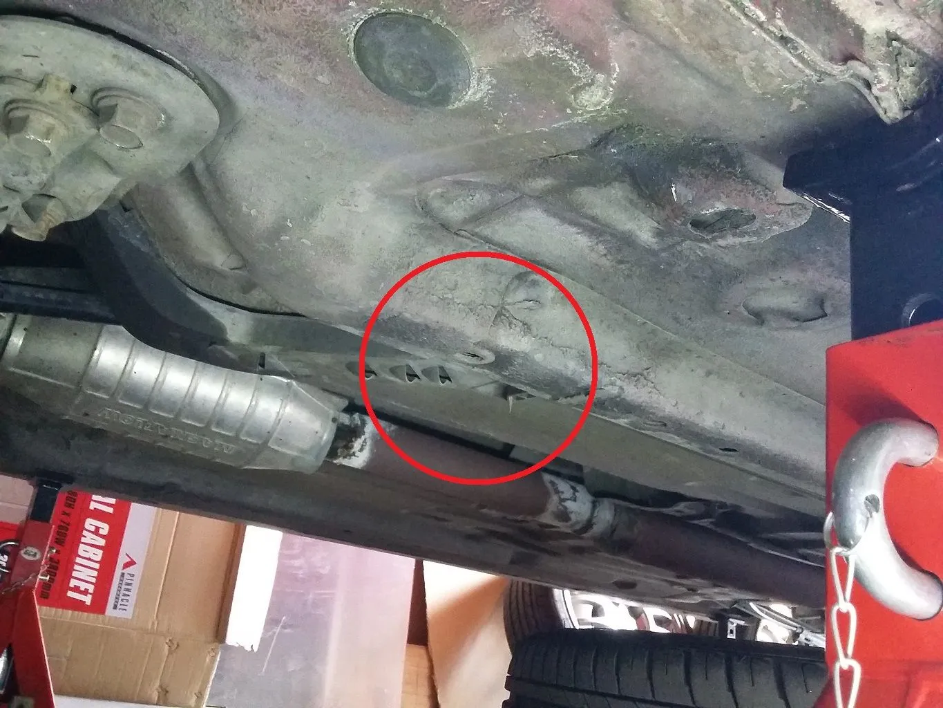

Pics from a slightly less rusty car :) PCB, a big steel plate between the jack and the car will stop the jack punching through
This is the front stand point (I think)
This is the rear stand point

I did have a piece of metal welded in so my trailing arm doesn't break off.
With that much rust in your car I'd park it permanently... j/s
It really sucks because the car runs perfectly and doesn't burn a drop of oil.
I've got CAA in case the wheels break off or something but if I'm ever in an accident the car is gonna crumble.

subframe option?...................might be option for krusty cars. Scissor jack should work there too......Depending on what surface car is on tho..............
Yeah, that's where I put my T-stands now.
I guess I would try to use the scissor jack there too if I ever needed to change a flat on the side of the road.
I don't know if the whole rear end of the car would lift off the ground though.
That would be dangerous.
