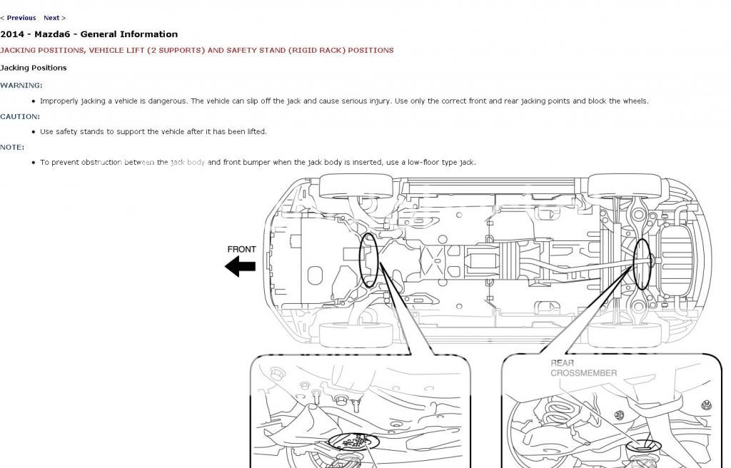

I've got a regular floor jack and i'm not wanting to use the frame rails near the doors i hate how poeple crush the lip and make it look like crap. I just dont know where else to jack the car from. please help with photos of locations you have used to jack up the car i dont want to put a hole in my undercarriage.

BTW: I'm asking abou the 2014 Mazda 6. i know i have a 3 in the sig, i haven't switched it over yet.

Front subframe center. Front suspension lower arm mount (cast steel) that is connected to the front subframe. I have not been to the back of the Mazda6 yet.
