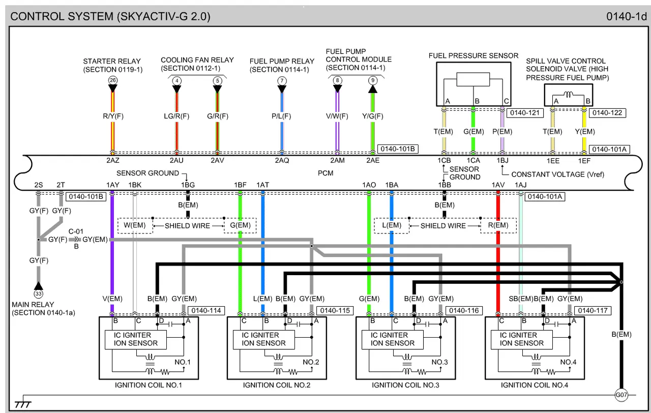

Ion sensing circuitry malfunctioned in your after-market ignition coils?
Looks like the coils do have ION sensors.
