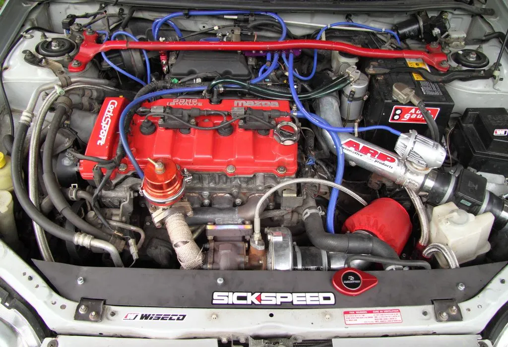

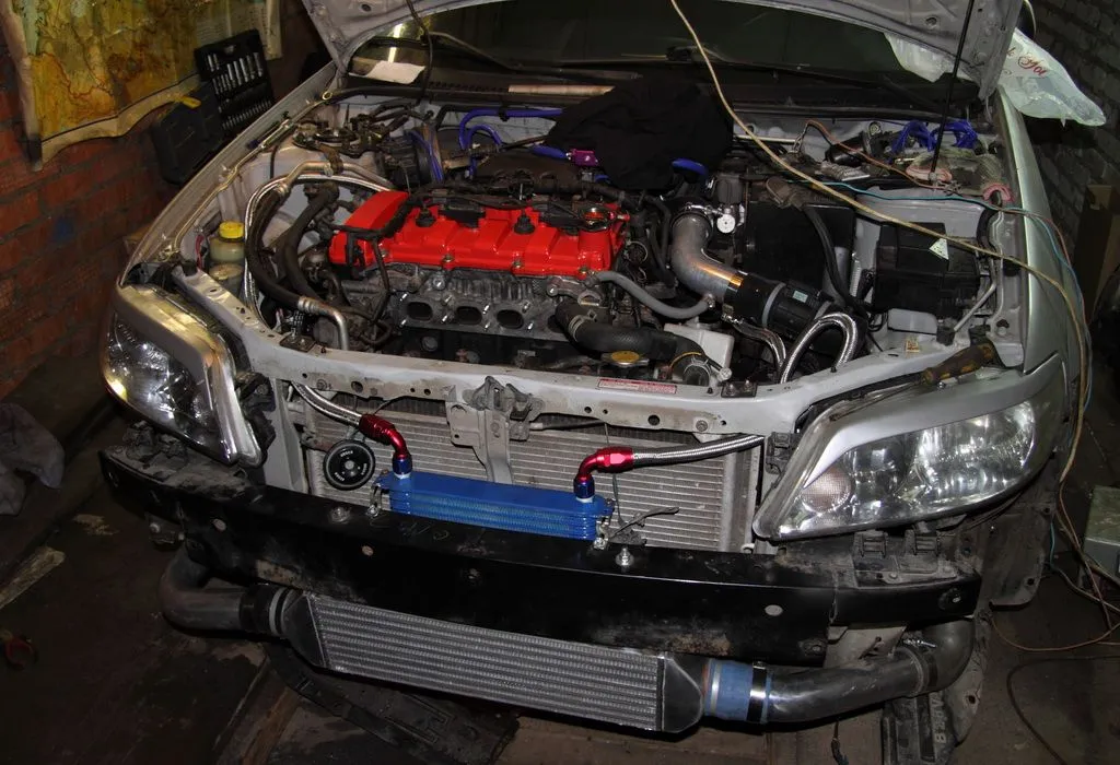

Hello from Russia everyone, in our country i see 2 Mazdaspeed protege cars in very bad condition. I have a Pro 5 and i like this car but i want more power. This is my work which i made with my car.
My mod list:
Engine:
Forged motor w/ Wiseco 9:1 pistons K1 rods
T3/T4 T04E gibrid turbo
Custom turbo manifold
Custom 63mm downpipe
Turbosmart 38mm wastegate
Hks SQV v3 bov
FS-ZE intake manifold port and polish VICS deleted
EGR deleted
Trust oil cooler kit with filter relocation
FS-ZE intake cam
Corksport exhaust cam
AWR front and rear mount
Cusco oil catch can
Victor Reinz MLS head gasket
ARP headstud kit
Spal 12 slim fans
Goodspeed FMIC
SSAFC
Mazdaspeed ECU
K&N filter with wrap
NGK ZFR7 plugs
TRE 255 lph pump
WRX 440cc injectors
FS-ZE fuel rail
Autoexe Rear Section Muffler
Corksport Urethane Exhaust Hangars
Weapon R coolant tank
Transmission:
ACT HD clutch kit
Corksport clutch line
MFactory LSD
Suspension:
Mazda 626 GW 275mm front brakes
Mazda Premacy 280mm rear brakes
Autoexe brakelines
Autoexe lower arm bar
Progress 22mm bar
Megan Racing rear arms
Exterior:
Eyelids
Fiber grille
03.5 front lip
Ford Escape nozzles
Interior:
Custom Stainless Steel gauge rings
AutoGauge boost and oil temp gauge
Speedhut gauge pod
Innovate MTX-L
626 Clock and amb temp gauge
Mazdaspeed pedals cover
MPV wiper switch
Custom shift knob and leather boot with ebay short shifter
