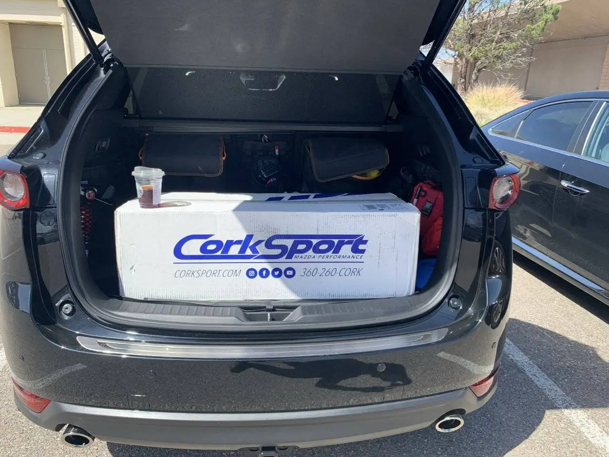

Tomorrow at 0700 hrs, it begins 😚
Test drive before you put the bottom scrape guard trim back on, as they are bitches to get on and off. The bumper is weirdly easy to get off and on. Don’t be afraid to remove the crash bars to make it easier to get inside the tighter places. Take pictures of what bolts and clips go where and above all else, the biggest piece of advice I could give, is tighten all clamps and hoses to the intercooler BEFORE you mount the intercooler. There’s more flex in mounting the intercooler than flex in the hoses/pipes.
