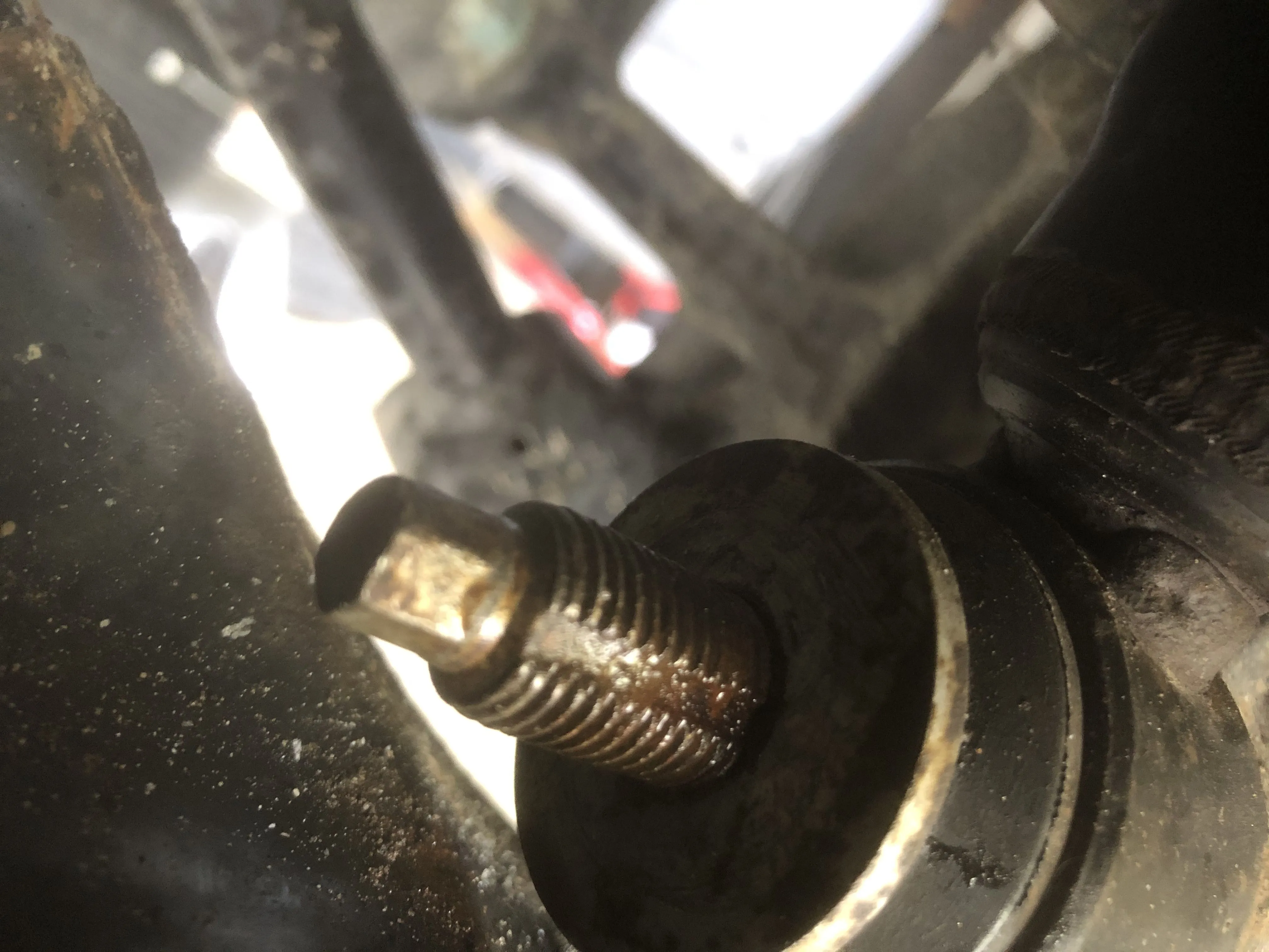

Hey so I have a 2014 CX-5 and I am trying to change out my rear shock. I've got the nut off the back side of the bottom bolt and the top shock mount bolts are loose but I can't get the shock out of the thread and I can't pound the thread out. Any ideas?

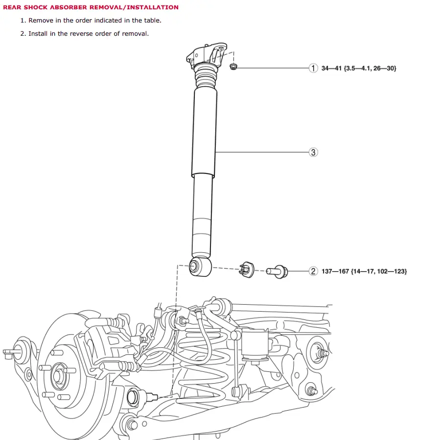

Similar situation on a 2015 here. Doesn’t follow the service manual which calls for a bolt to be pulled from the opposite side rather than a flange nut that I found. The Remaining bolt has an 8 mm hex at the end which is small for a much larger rusty bolt.

Just replaced '13 MY manufactured in 2012 rear shocks. My shock bottom mount is exactly as the snapshot from the service manual above. While I was buying shocks, I discovered that vehicles manufactured after May 2013 have the new mount style (nut instead of bolt) hence the discrepancy with the service manual the users above experienced. The weirdest thing is that there are 2013 MY vehicles that were manufactured with the new mount and the shocks are different. Not sure about AWD models.
KYB Shocks model#:
Before May 2013- 349219 (Verified by me)
After May 2013- 34400313 (info from Amazon review for the above part)
KYB Shocks model#:
Actually there’re at least 4 different versions of OEM rear shocks for gen-1 CX-5, and at least 3 more for gen-2 CX-5. And yes, 5/13/13 is one of the manufacture date having the shock change.

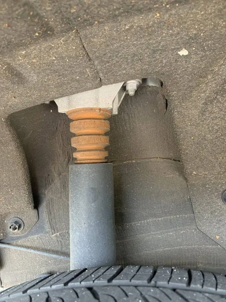

I can confirm it’s made of metal. The original shock mounts on my ‘13 with 95k miles are still intact.
And these white metal rear shock mounts are prone to crack or break ⋯
