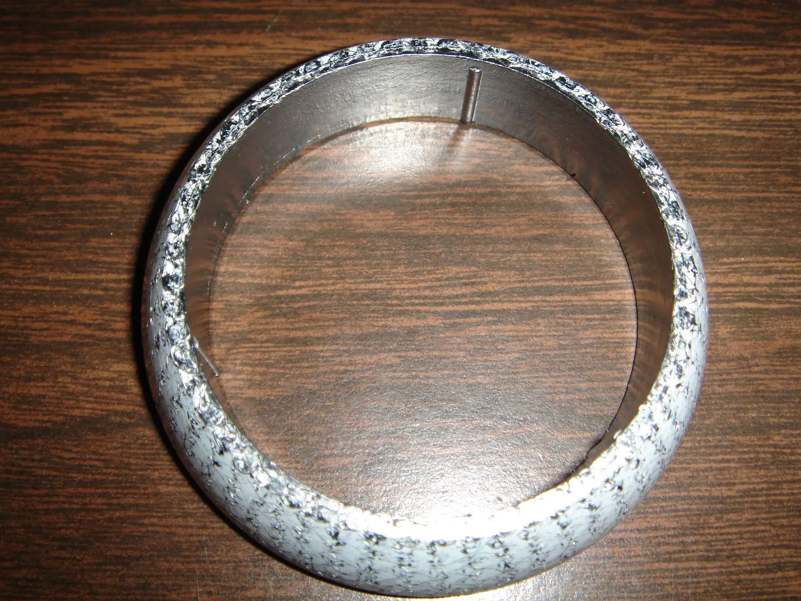

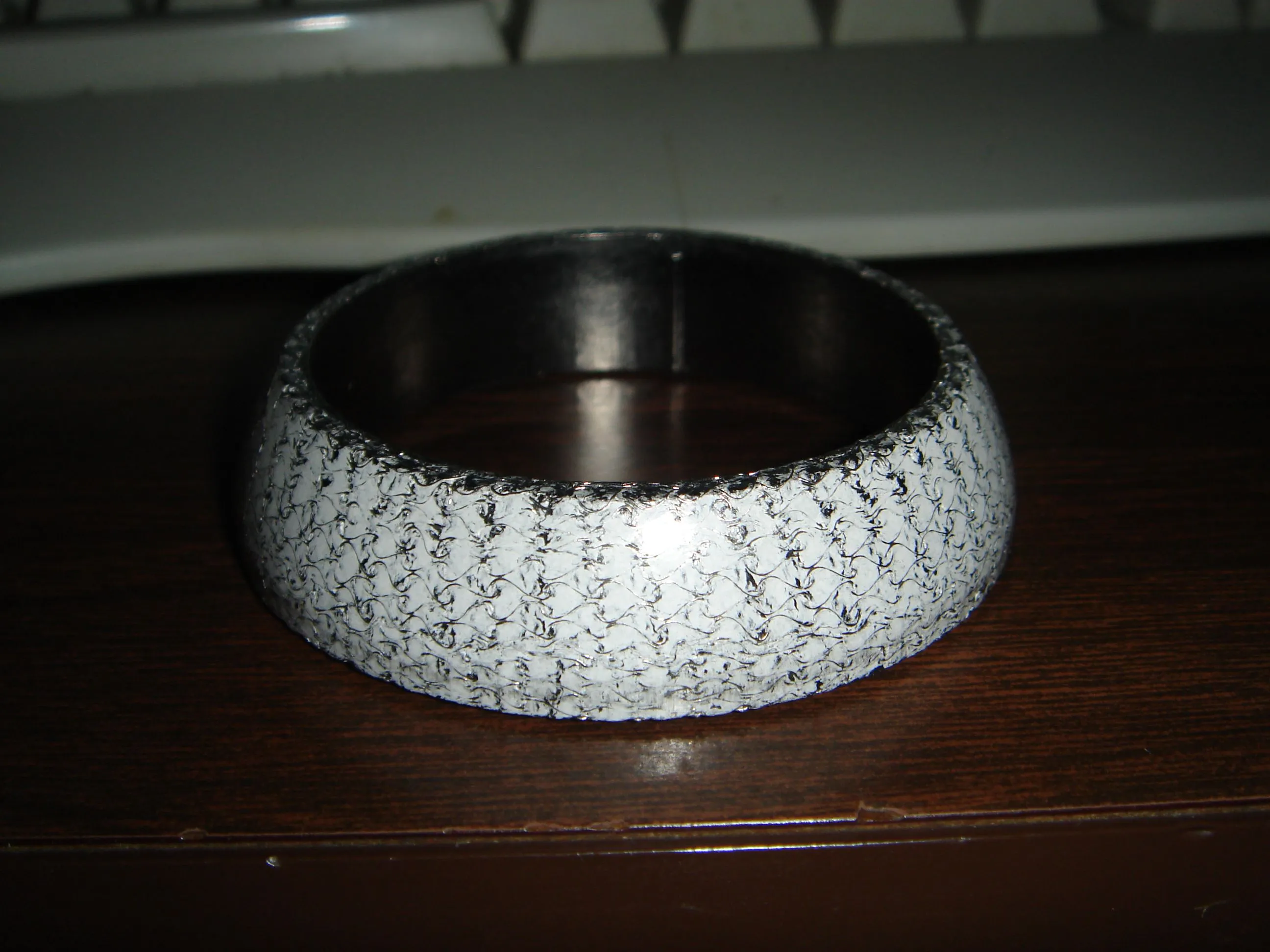

Ok i got the part from the dealership but I don't think this is it. The part number is BP48-40-581A this is what it looks like. is this the part?

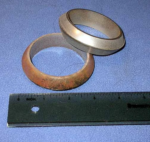

thats a donut gasket. it goes on the the end of the header, where it connects to the midpipe/second cat
