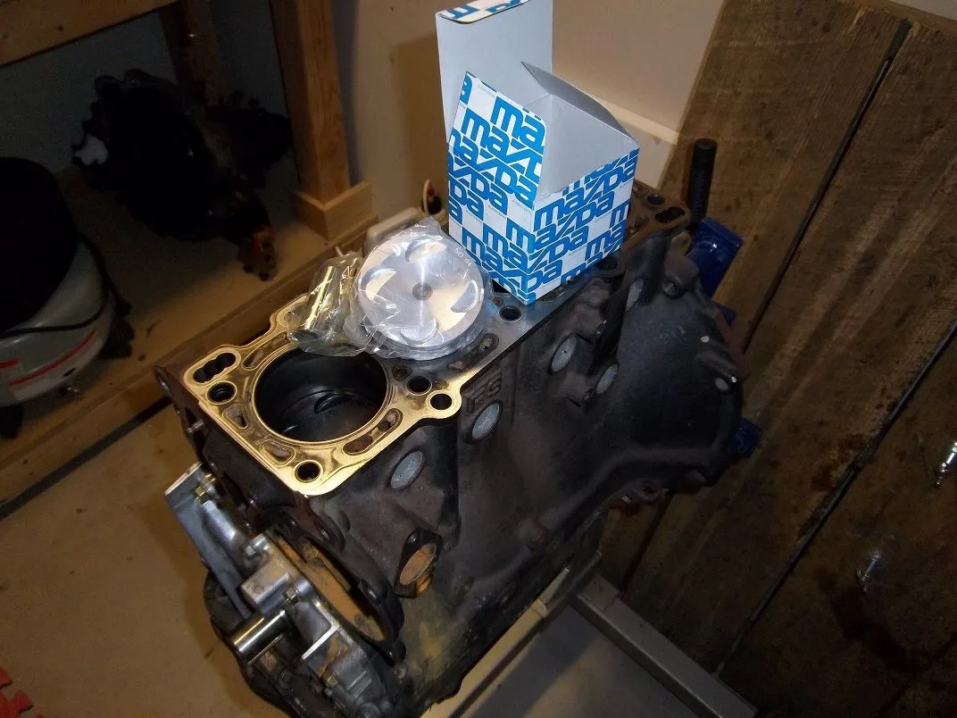

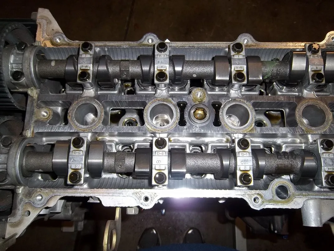

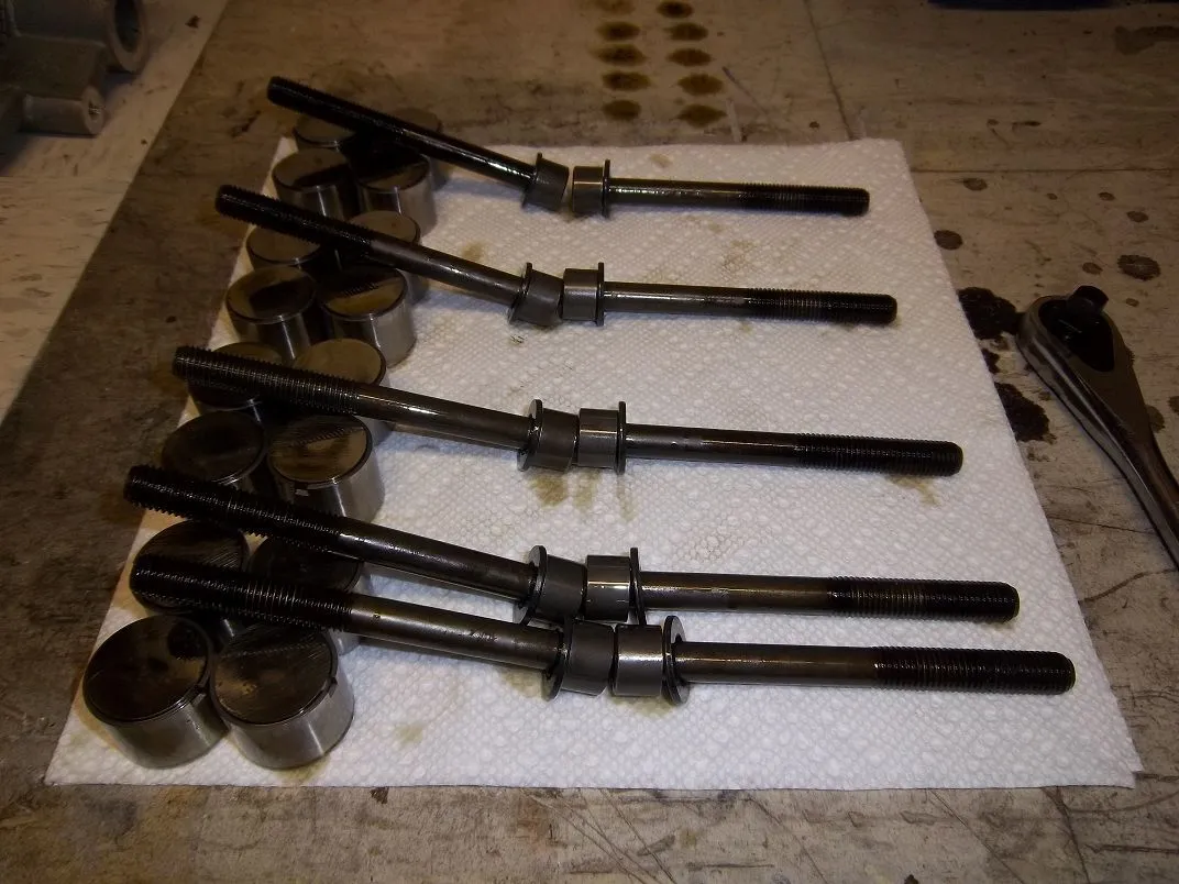

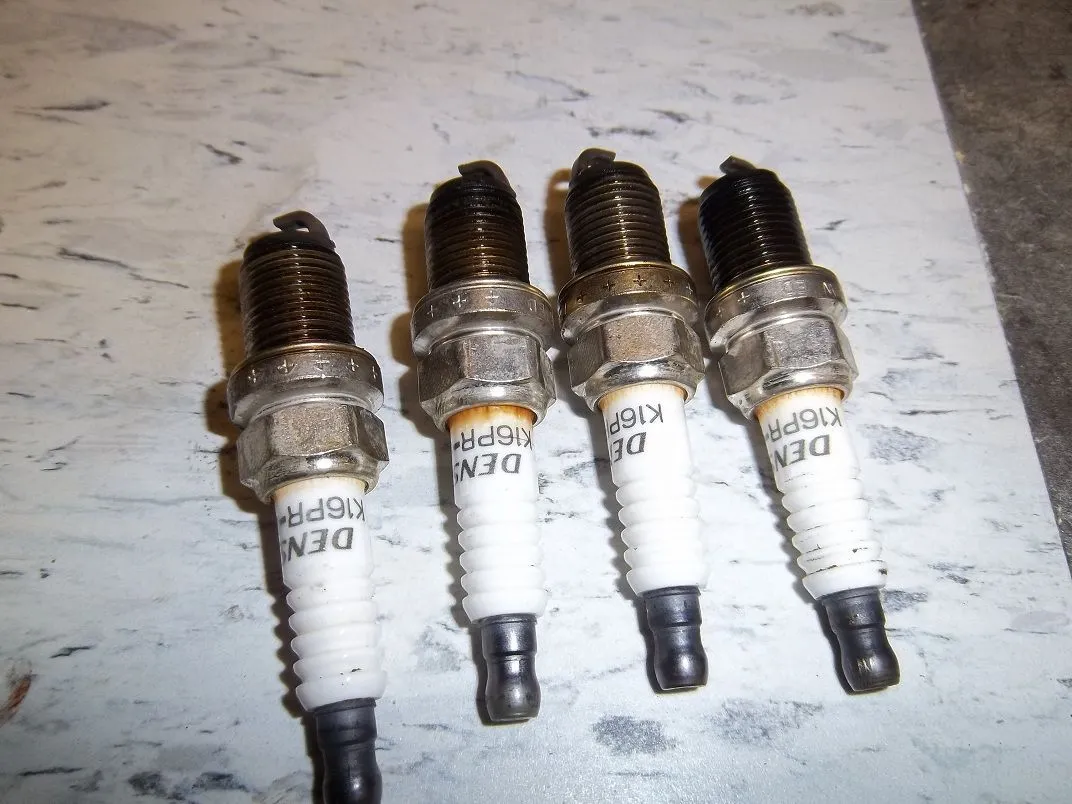

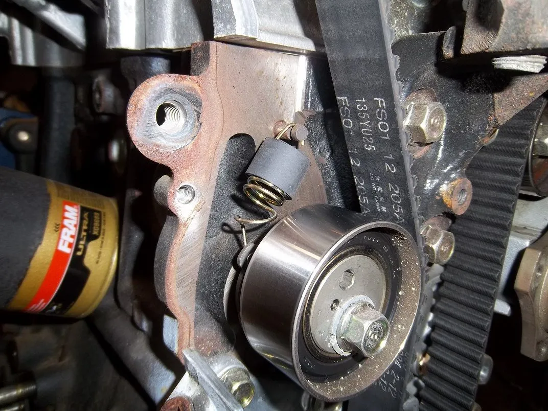

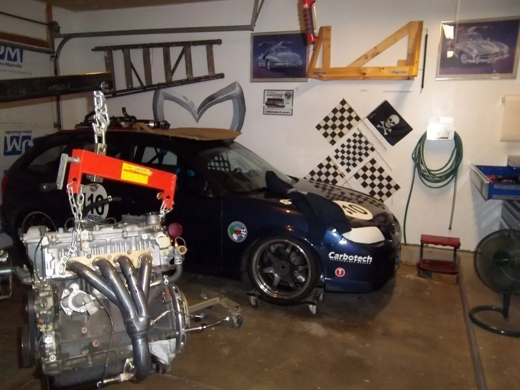

OK, thanks to all that have helped me so far. I have now got the motor down in the shop and took a few pics along the way.

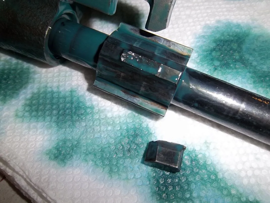

The original reason for pulling the motor again is to fix the trans. That is done and stored away. Got pretty good at getting that knocked out quick. That is due to the fact I can't contain myself when shifting in the races and I snap selector parts frequent.

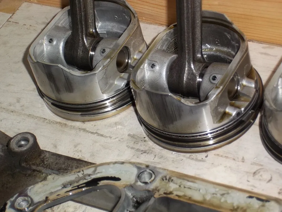

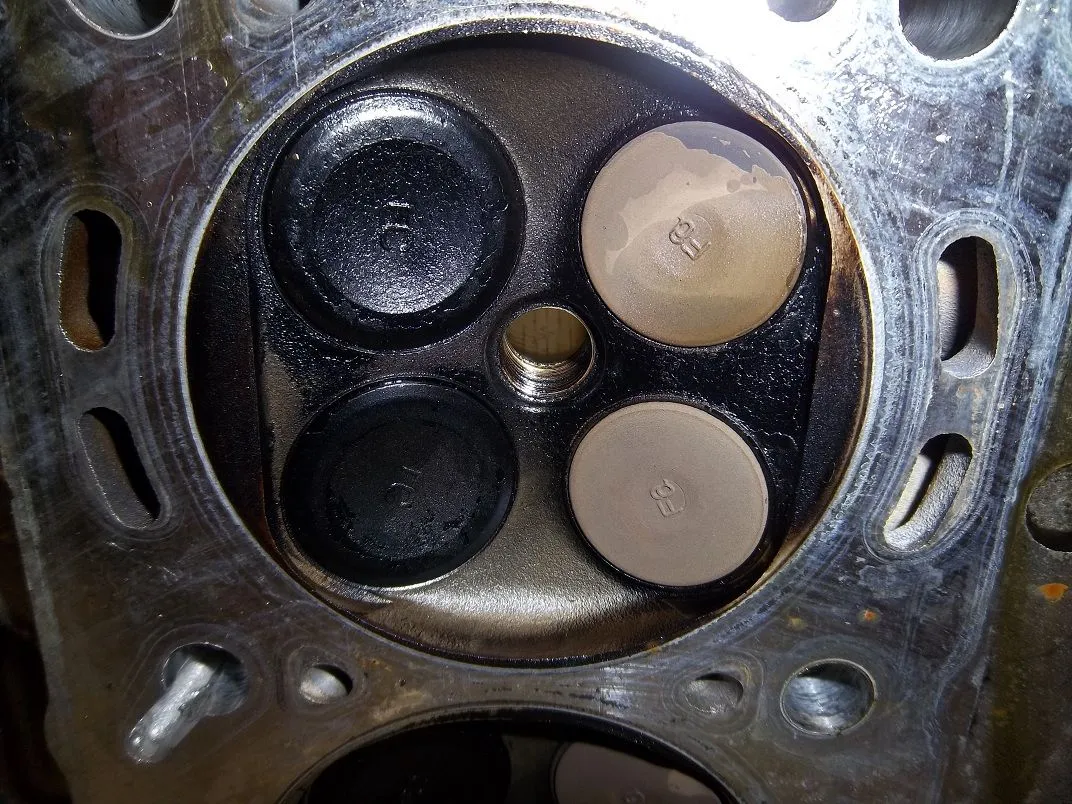

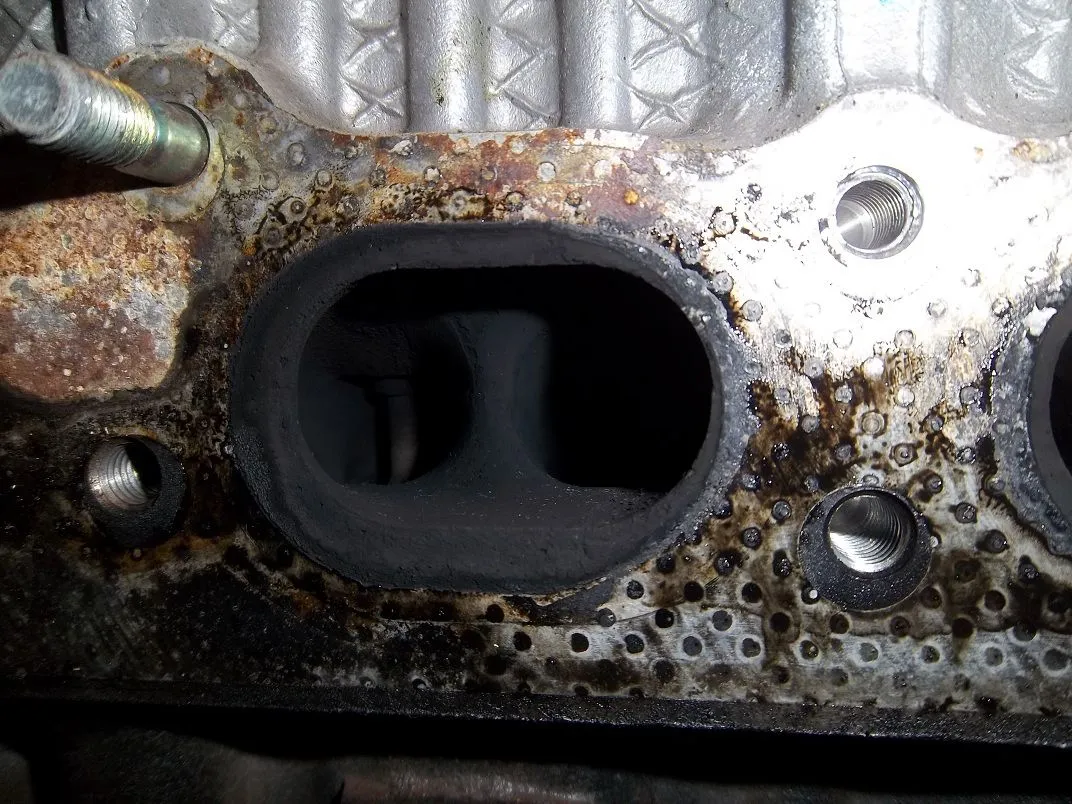

Also the motor smoked on start up. It looks to be the valve seals on the intake side are leaking. The intake vales have a nice coating of oil on them. So I will most likely have them replaced or replace them myself. Also when I mounted the motor to the stand I found that the rear main seal is leaking too. So a few things to take care of in this off season.
But since I have the motor out I figured I could try for some more RELIABLE horsepower.
I don't drag race. I don't circle race. I don't pud around in a parking lot. I road race W2W and its between 10-13 times a year. One of which is 100mi long, and the rest is approx 50mi. So I don't necessarily want to be tuning or wondering if its going to start. I just need to concentrate on driving and accumulating points.
The class is unlimited other than it has to be under 2.3L and not forced air.
Doing this build I have many questions. So please stay tuned, and I will try my best to keep pics coming till the end (very near) to keep you guys entertained.

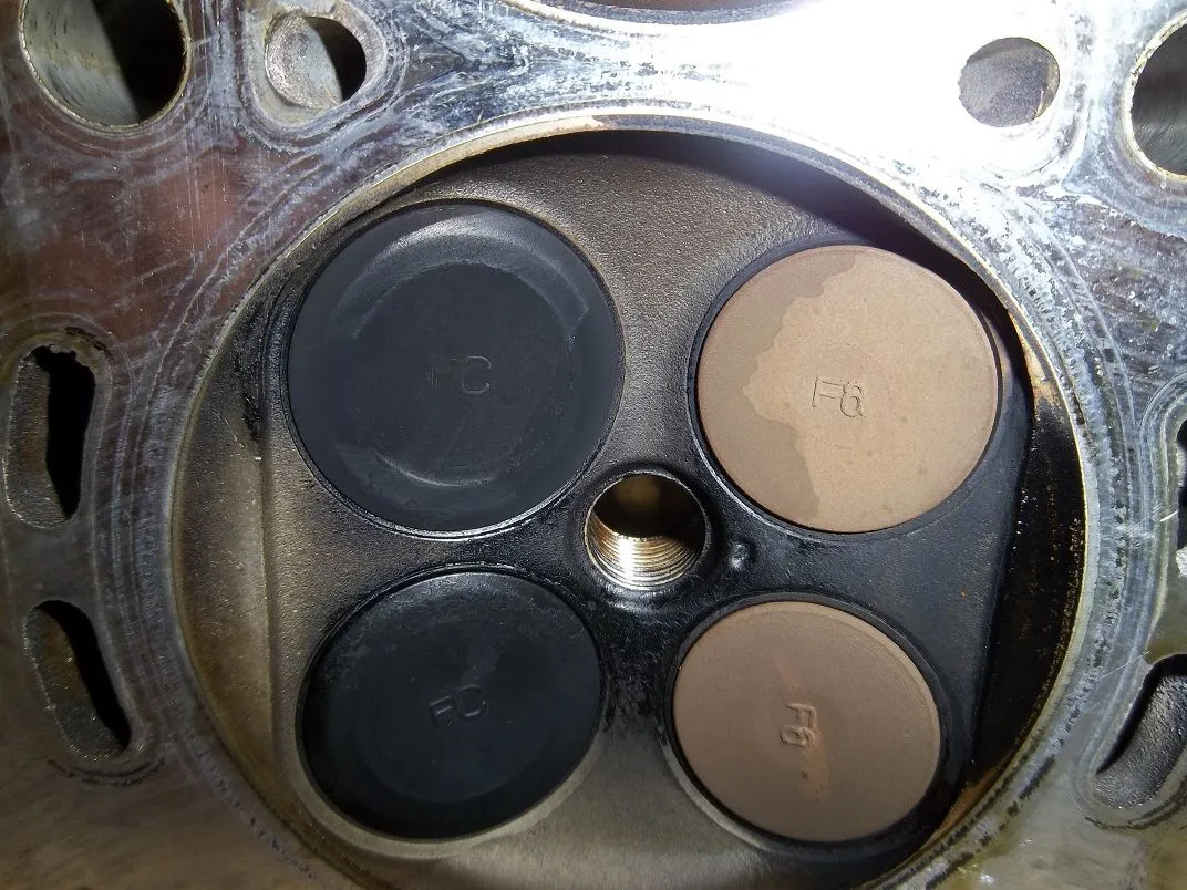

Those pistons... 10.7 or 10.4? It's also a great time to get some ZE cams in there. I'm pretty much using the overhaul as an excuse to get everything in, in one fell swoop. New oil and water pump, new seals, valve, cams, main, etc., ACL race rod/main bearings, head and engine cover gaskets, full set. U got mp3 ecu already so kick the vtcs to hell and remove it. She should run moderately acceptable with those

whats going to get changed: (so far)
de to ze .050 over pistons
block to be bored .050 over
.050 rings
valve seals
ZFR511 plugs
rear main seal
thermal intake mani spacer (had one laying around from another guy)

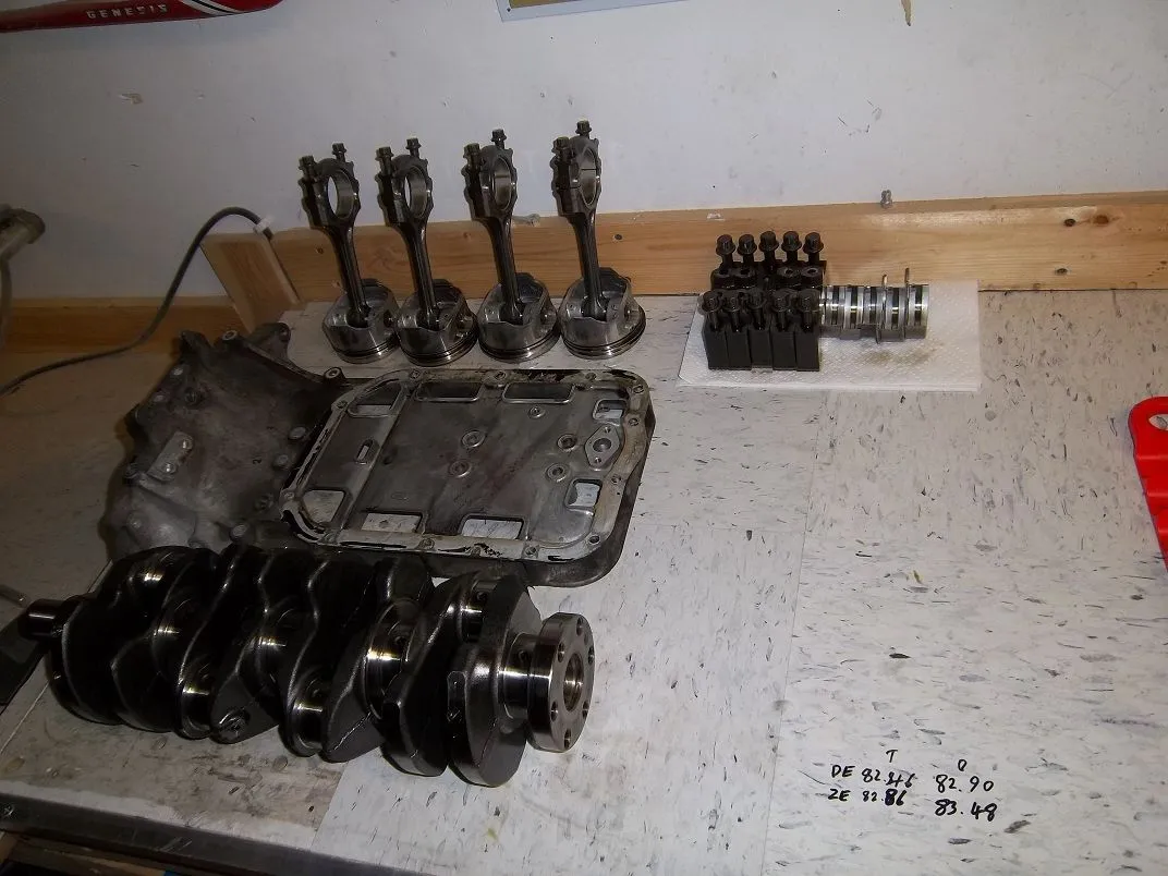

I know we covered the balancing aspect, but what about lighting the rotational assembly? Is this possible with all stock internals and would I really notice a difference? I did notice quite a big difference when switching flywheels.
lastly with my stock rev levels would a valve job do anything worth the cost of doing so?

attachment.php
pretty scraped up for 16K. Racing is hard as fak on cars.

Like I said it smoked pretty bad at start up. And the last day I was out the trans broke in the am right away so it did not get a chance to burn off.

However more pics of the oil burning problem.

OK engine dropped off at a top fuel shop (no joke). http://aesracing.net/ Next week I will have a valve job along with new valve seals at the same shop. Picked up the ze ecu, harness, trigger, an the 4-2-1 header from repthemazdas also. Should have that in a few weeks too.
