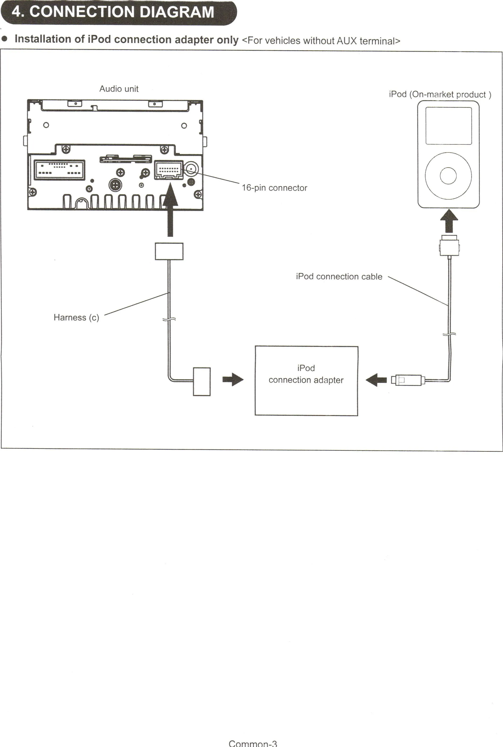

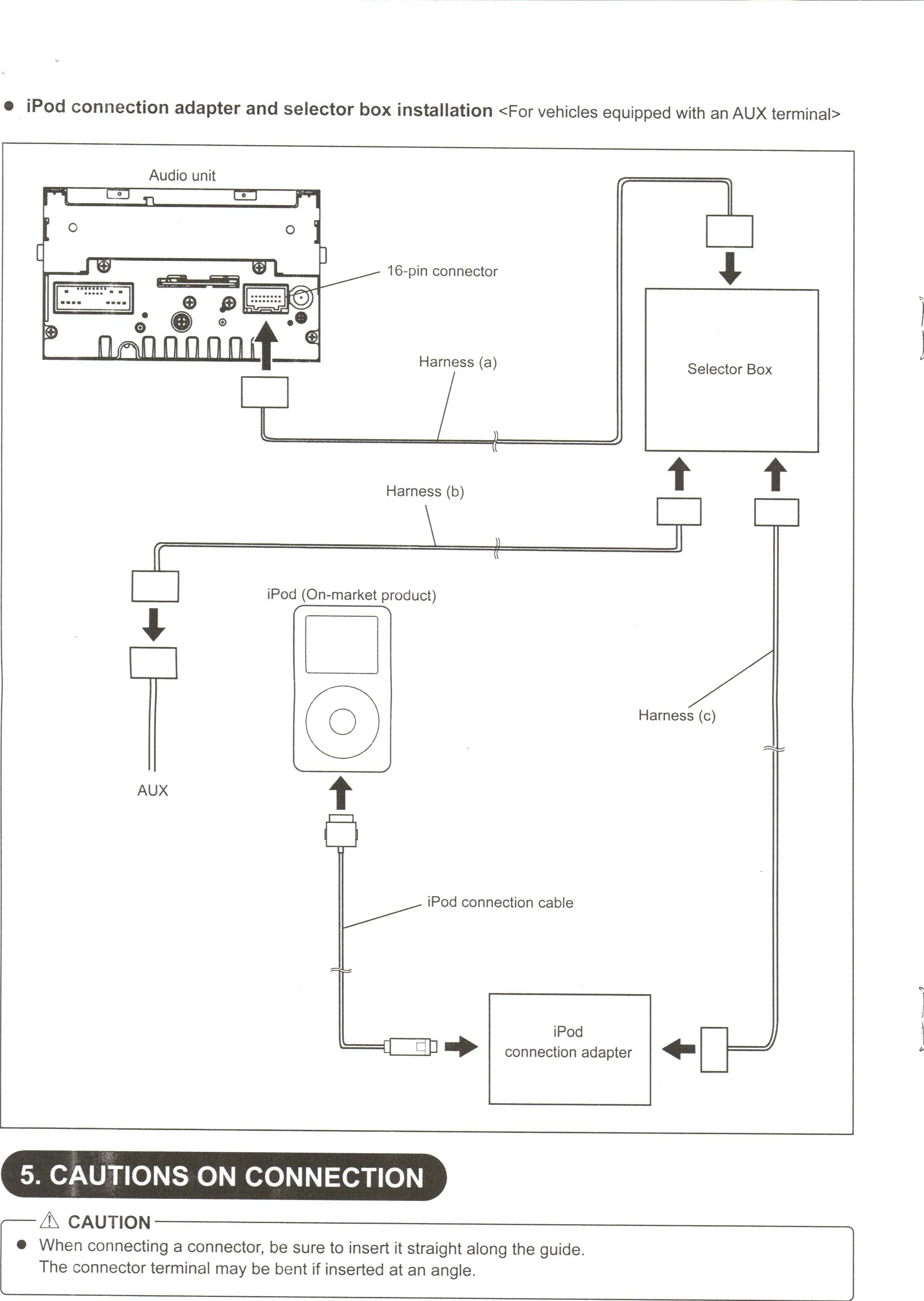

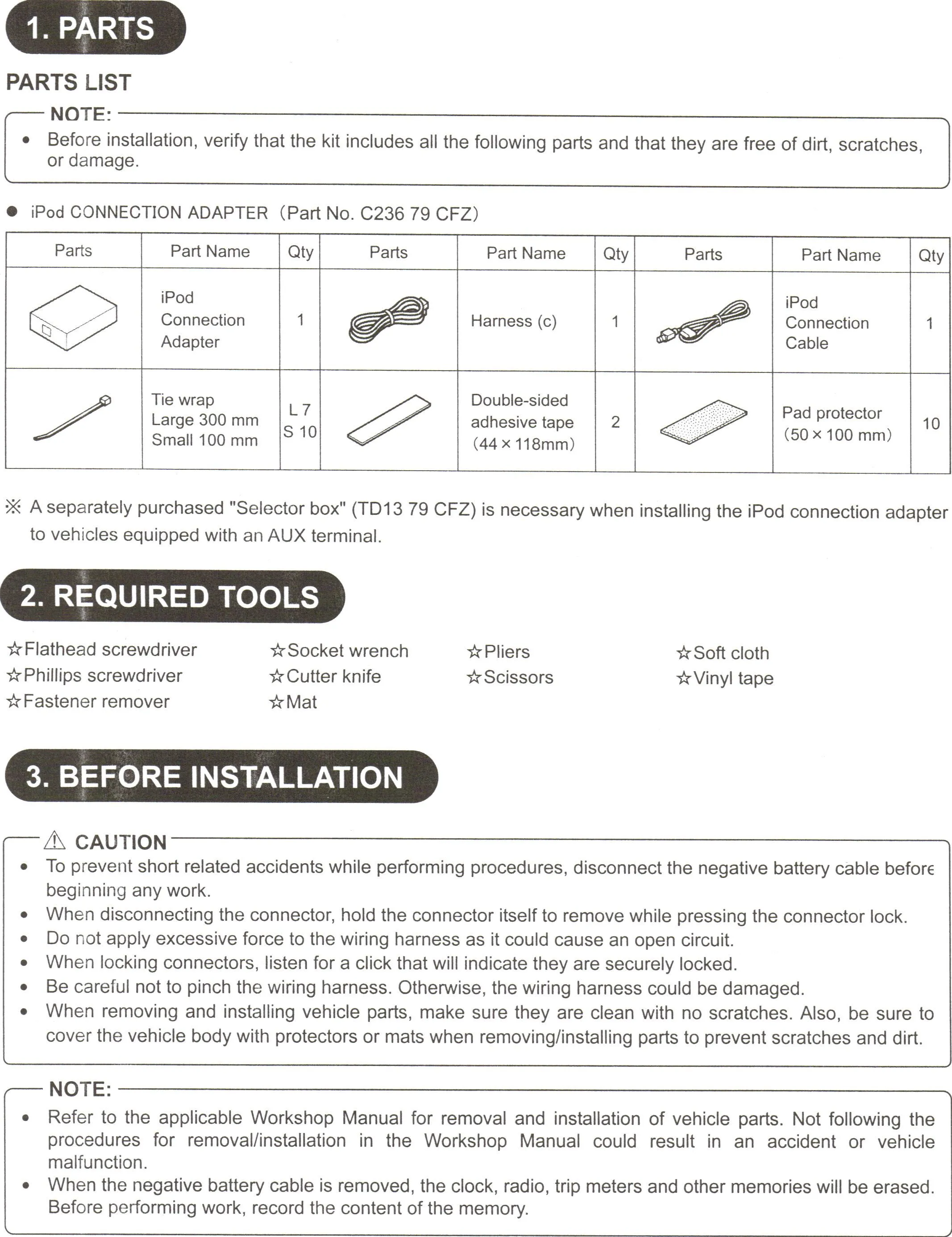

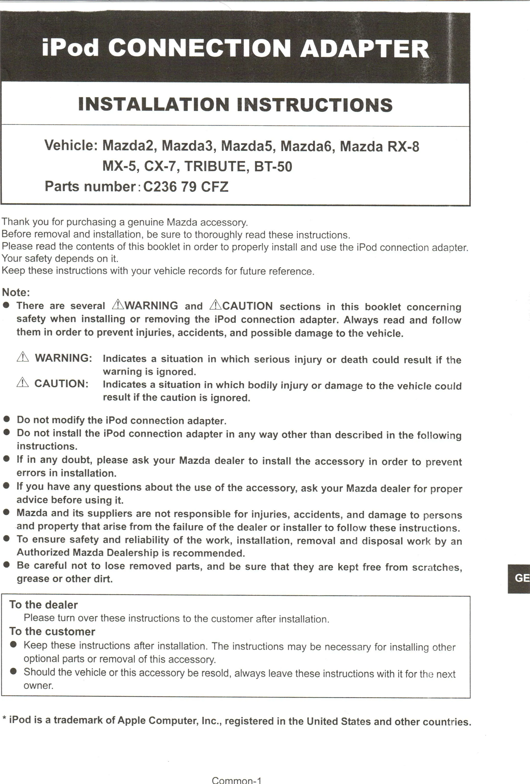

INDEED IT HAS ARRIVED. I had a kit in my hands and read over the installation proceedure and what it is all about. It works for NAV and NON NAV type Mazda 5's. Cost of unit is indeed 185 CDN and installation I was told is 1.5 Man hours (if you are technically inclinded do it yourself)
The adapter only adapts to "IPOD'S ONLY" like the title says. So if you have a reg MP3 player "NON IPOD" then we will have to find a way to tap into the pin out of the ipod unit lol...
Attachments below are just a few scans of the install and kit info. I have the whole kit install process if you need it please call as I will then only scan it in...

Which unit the Mazda IPOD adapter or the other one listed above. In my "scanned" attachements above it states which models of IPODs the Mazda Adapter supports... hope this helps
Mini IPOD Version 1.2 or higher in your case....

Quick question. Does the connector also charge the ipod? I think it does but couldn't figure it out for sure.
Here is an update. I used my sisters 30 gb Ipod and it worked! I am sure all Ipods work, but my Mini was just too used and abused.
Does this plug simply into the back of the head unit? I have auxmod installed, but the diagram looks to be a different port, correct?
rodscalip5- What controls work? Is it just ff and rw? What is displayed on the Mazda's LCD?
Yes you connect to the connector box... there is a separate instruction with NAV systems also
