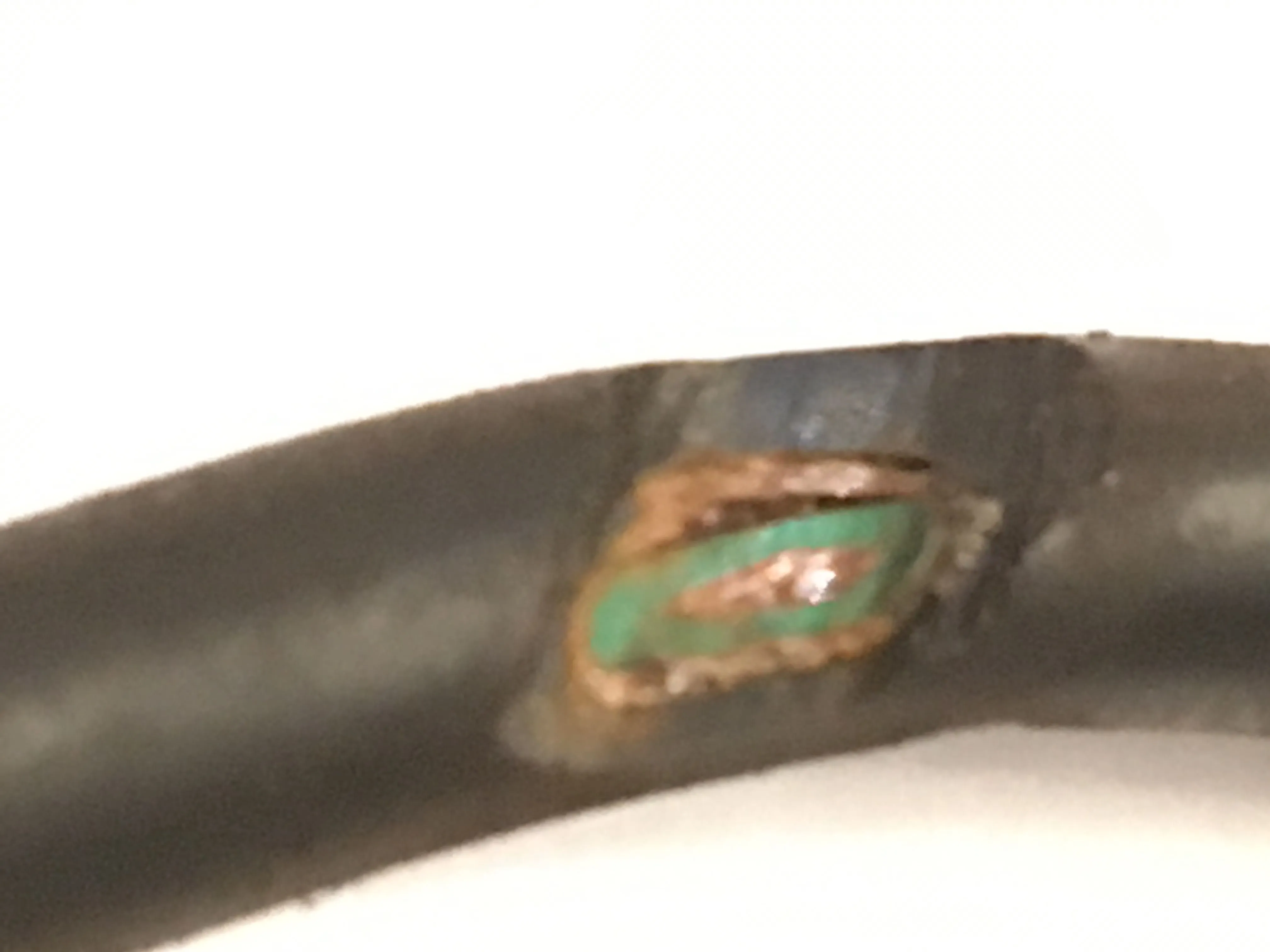

Hello All, I have an update.
I have finally had time to mess with my Mazda, and I may have solved the issue. I know I said this before, but I am like 69% sure that I have found the problem.
Over the past few weeks, I been unable to get my Mazda started. It would crank, start for a half second sometimes, and die. I wasn't sure if my timing belt broke, due to it being able to kind of start, but I decided to check it anyways. I took the valve cover off, only to find the timing belt looking fine to me.
But, when moving the wire harness that goes over the valve cover, I followed the connector and wire Crankshaft Position Sensor down to the sensor and notice an odd route that it traveled. It seem like it was extremely close to a pulley.
I had another sensor to put on the P5, so I decided just to do it sitting at my house, instead of trying to get the car to my garage which is 25 minutes away. I got the sensor off, and I found that the pulley was rubbing on the wire, and shaved about half way through at the deepest point.
I installed the new sensor, routed the wire differently, and put everything back together. I reset the ECU, and the car instantly started, and ran flawlessly.
This was not the first time that I reset the ECU and the car ran better, so I took it for a few test drives, and it ran great, not one moment of hesitation, stall, nor surging. I am not convinced that this is definitely the solution, and I probably won't be until next fall when the temperature drops again, but the P5 was running really well today.
I am attaching a picture of the wire, I am not sure why the wire was routed the way it was, it actually looks like it is supposed to be routed that way, but if there is slack in the wire, it will rub on the pulley.
I am not sure how to mark the thread as "solved", but I have 500 miles on the P5 since finding the damaged wiring on the Crank Shaft Positioning Sensor, and the P5 has been running great since then.
I have driven it almost every day, and it hasn't given me once second of issues.
It also has been so long since driving it, I forgot how much fun it is to drive, even at its old age.
Anyways, that you all for your help, and there is a lot of useful information on this thread for people with similar issues.

I might take a picture and post it to show the old and new routing of the Crankshaft Positioning Sensor cable.
I think the issue may have more to do with the clip on the connector of the sensor than the routing, meaning if the clip that anchors it onto the motor is broken (or just not attached), then this would create slack on the cable, enabling it to hit the pulley like in my situation.
I think if the sensor cable connector is attached to the motor, then there would be tension on the cable, pulling it away from the pulley.
Either way, I re-routed mine, I will take some pictures to better illustrate what I am referring too.
Thats cool you were able to find and fix it. Thats kind of what I was refering to. Mine was chaffed right at the eyelet to lift the motor. Same thing was happening though - it would touch metal short out and kill the engine. And without any code being thrown. Replacing it allowed me to route it securely away from any moving parts and add some extra tape around the area near the eyelet to prevent it from happening again.
The part that bugs me is that there was no code thrown.
You weren't shorting out your ignition to kill the car, you were shorting out a signal going to your ECU so the ECU killed the car.
The ECU obviously knew there was a problem with the crank sensor circuit so why couldn't it throw a P0335 code to give you a heads up ??
Just think how much time, money and frustration could have been saved if the car would have thrown that code along with killing the engine.
Thanks, I should have just replaced it a while back when you suggested it. It was one of the things I suspected, and I purchased the sensor months before actually installing it, now I wished I would have taken a closer look sooner.
I am curious, was the clip that holds the sensor connector onto the motor broken? I am thinking that maybe the extra slack was allowing the wire to rub on things it should of been.
