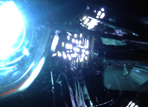

did the DRL LED upgrade on my Sport 6MT today. (non xenon)
Found that they needed the decoders to operate properly.

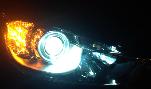

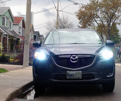

installed a set of aftermarket HIDs (10000K) today - no extra wiring harness needed - plug and play with the factory harness.
no decoder needed
Took 10mins and best upgrade i've done IMO.

CraM, which aftermarket HIDs did you get?
Good to know I'd need the decoder kit for the DRLs!
http://www.extremebrightleds.com/ProductDetails.asp?ProductCode=R-HID-H11
tho there are many out there that are similar - i just went with these guys cuz i know them and i can pick the stuff up from the guy in Markham.
without the decoder the DRL leds would only light when i put on the high beams.
in "regular" mode they were dark.
never any errors on the dash

So you went with 35w hids? I thought the halogens were 55w?
You may be right stromdriver

i picked up some ones on amazon that seemed to be just like the jdm ones but for a lil cheaper. except that it appears that each round emitter actually has 3 tiny points in it instead of illuminating completely.
so will have the wife drive down the street and back towards me to see how bright they are because standing in front if it they aren't particularly bright and barely lit up ground last night unlike kimchei said his do. they certainly don't seem as bright as the pics on the amazon page for them...
