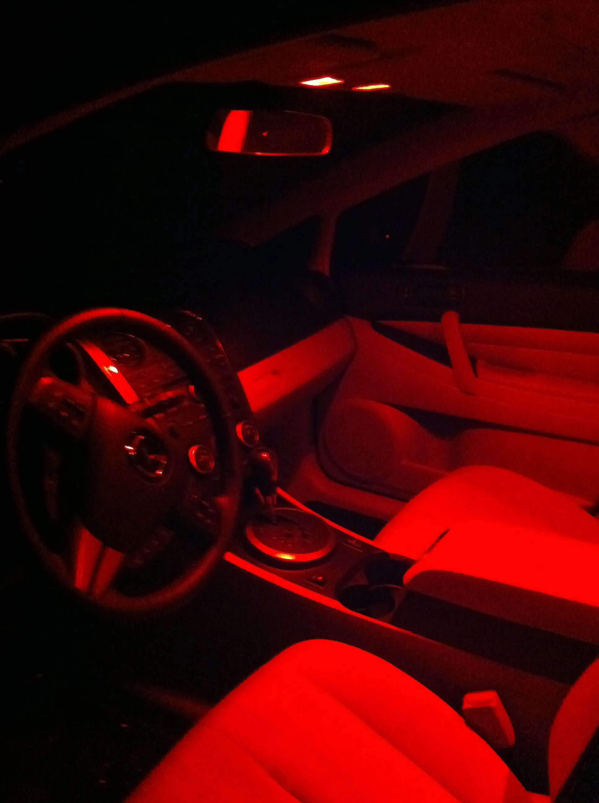

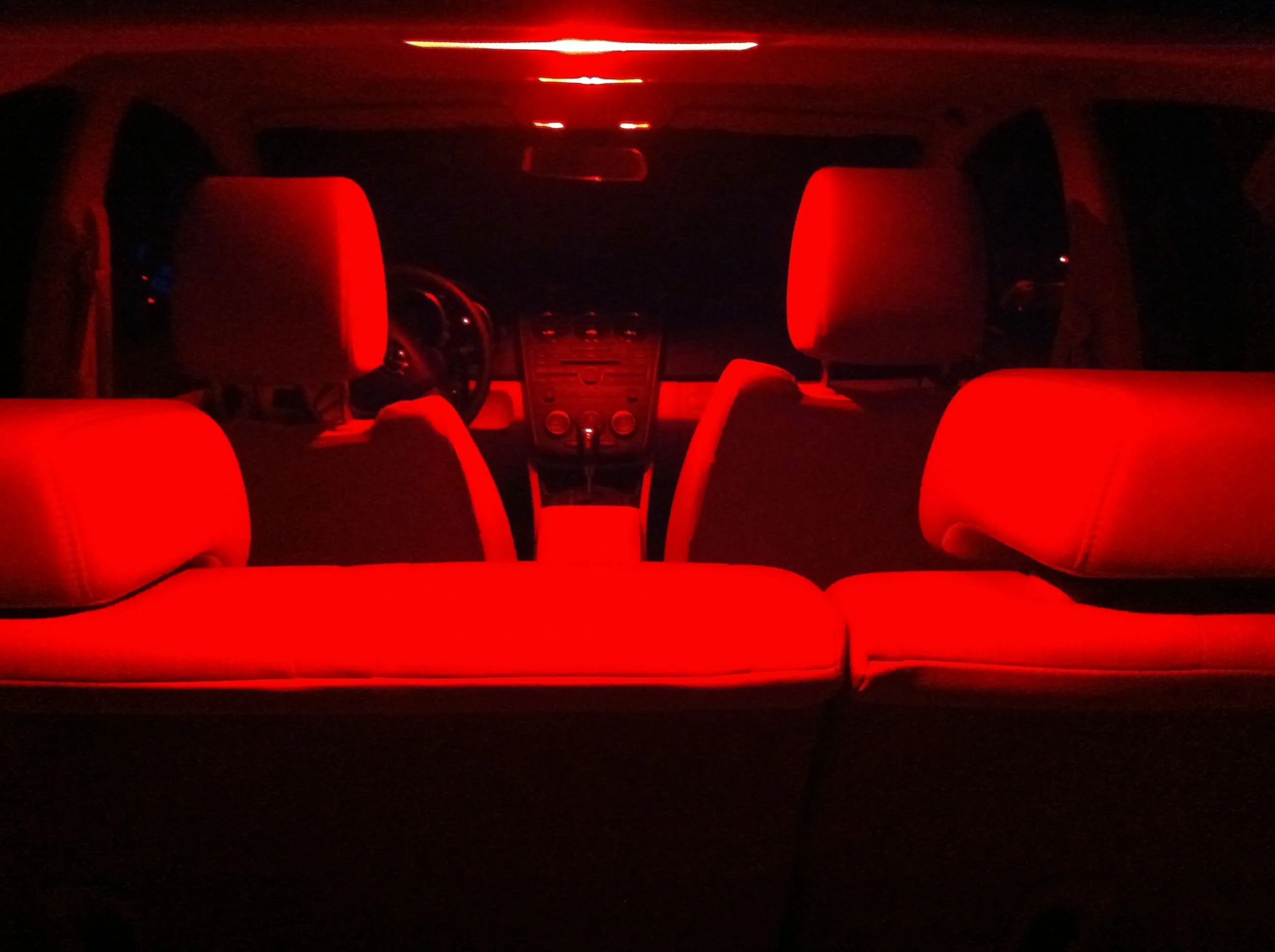

I went with superbrightleds.com. Couldn't be happier, and they're very bright for colored LEDs. I can't imagine how bright the white ones would be! Driver Side.webpRear Hatch.webp
