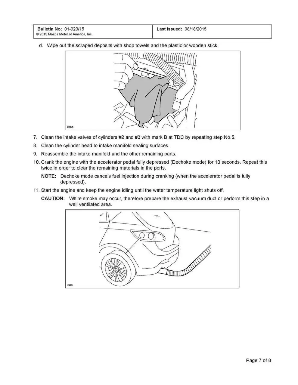

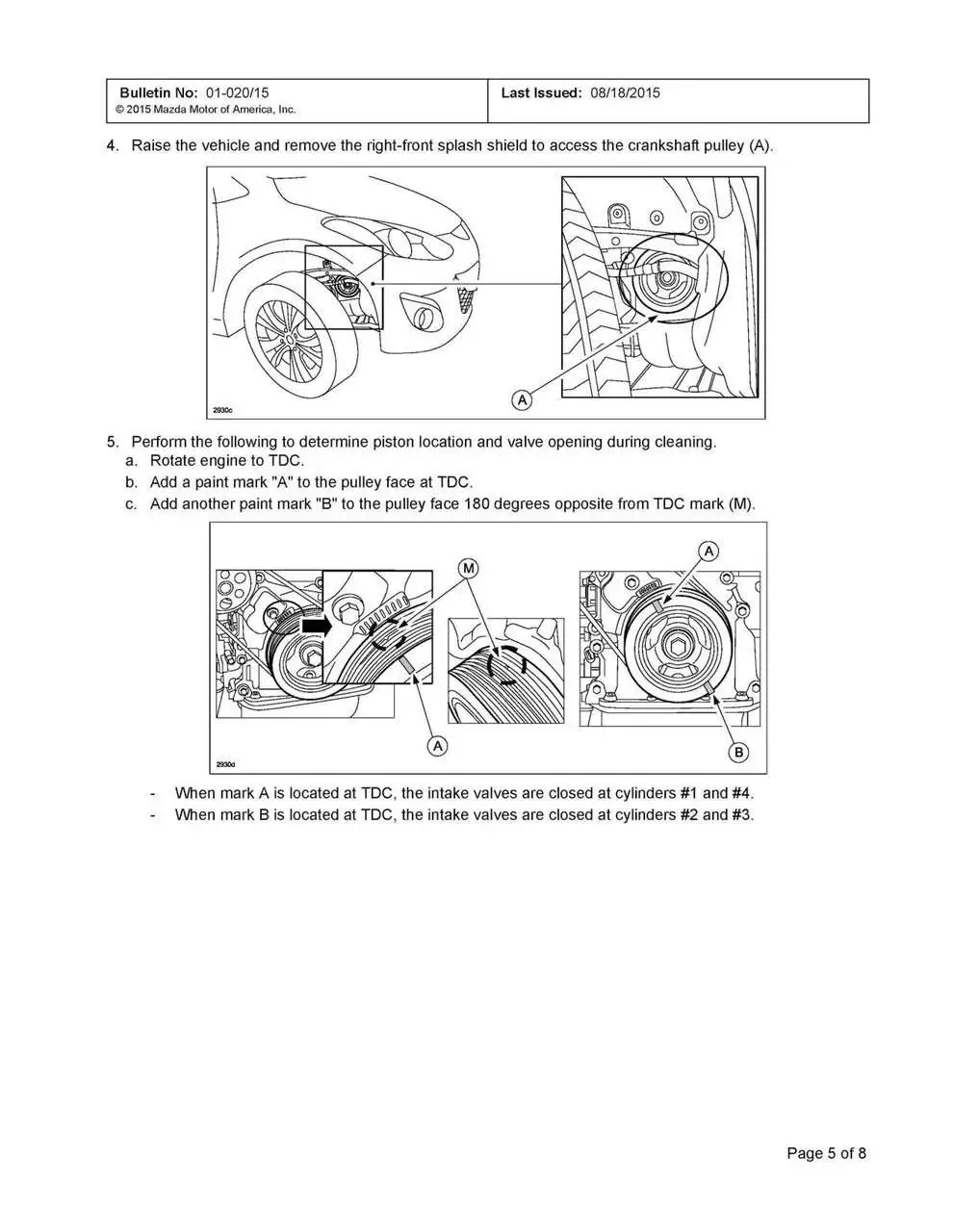

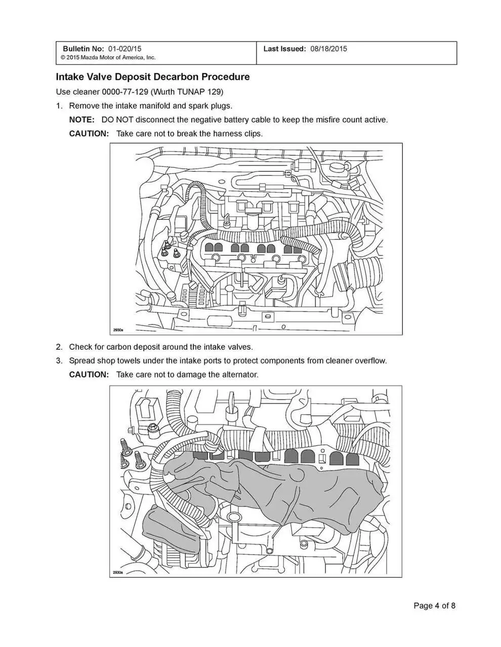

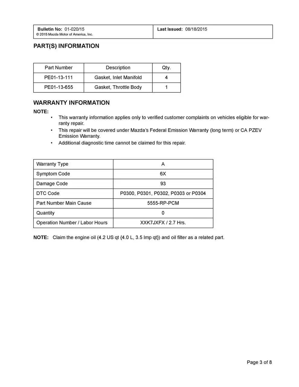

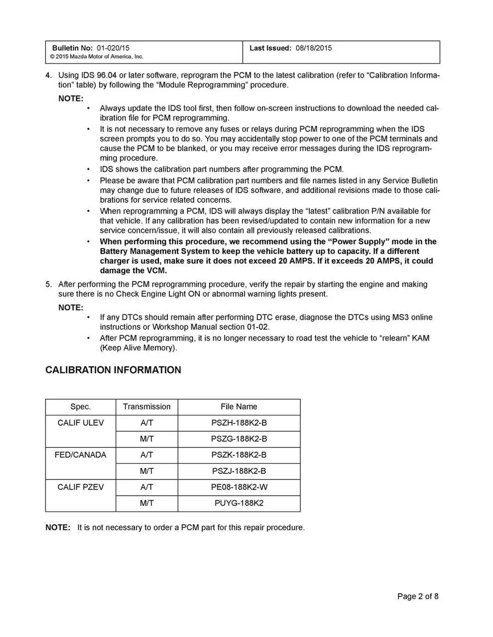

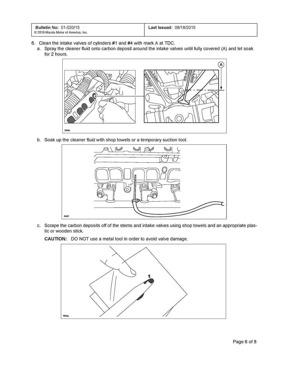

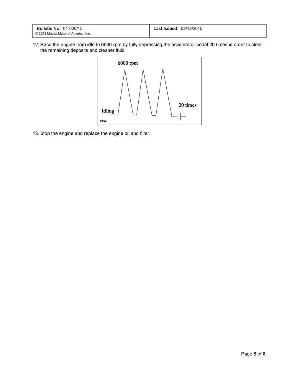

TSB for the early SkyActiv on Mazda3... not sure if this standard procedure at a dealer if you request DI valve cleaning.
