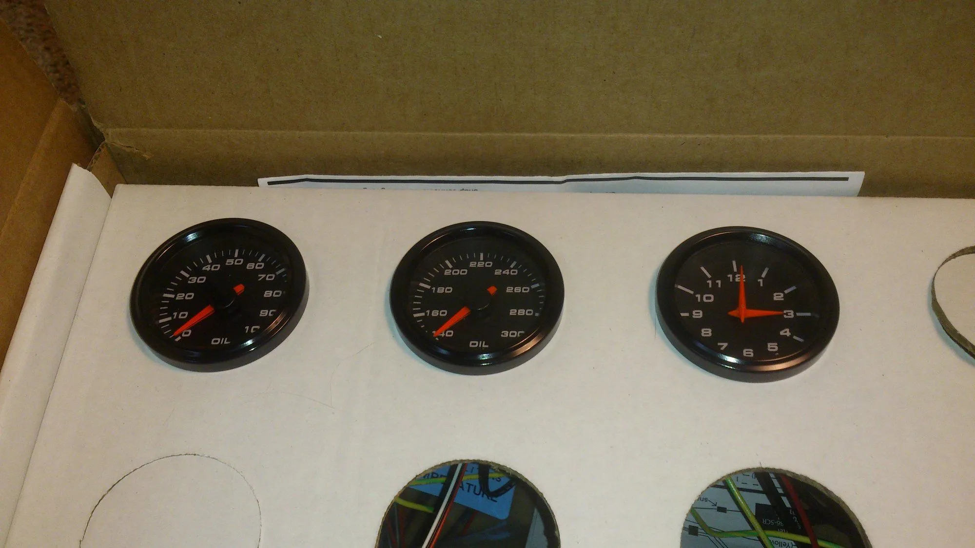

Speedhut custom 52mm Oil pressure, oil temp, and analog clock. (i'm making a custom bezel to put these in the DIN slot above my receiver)

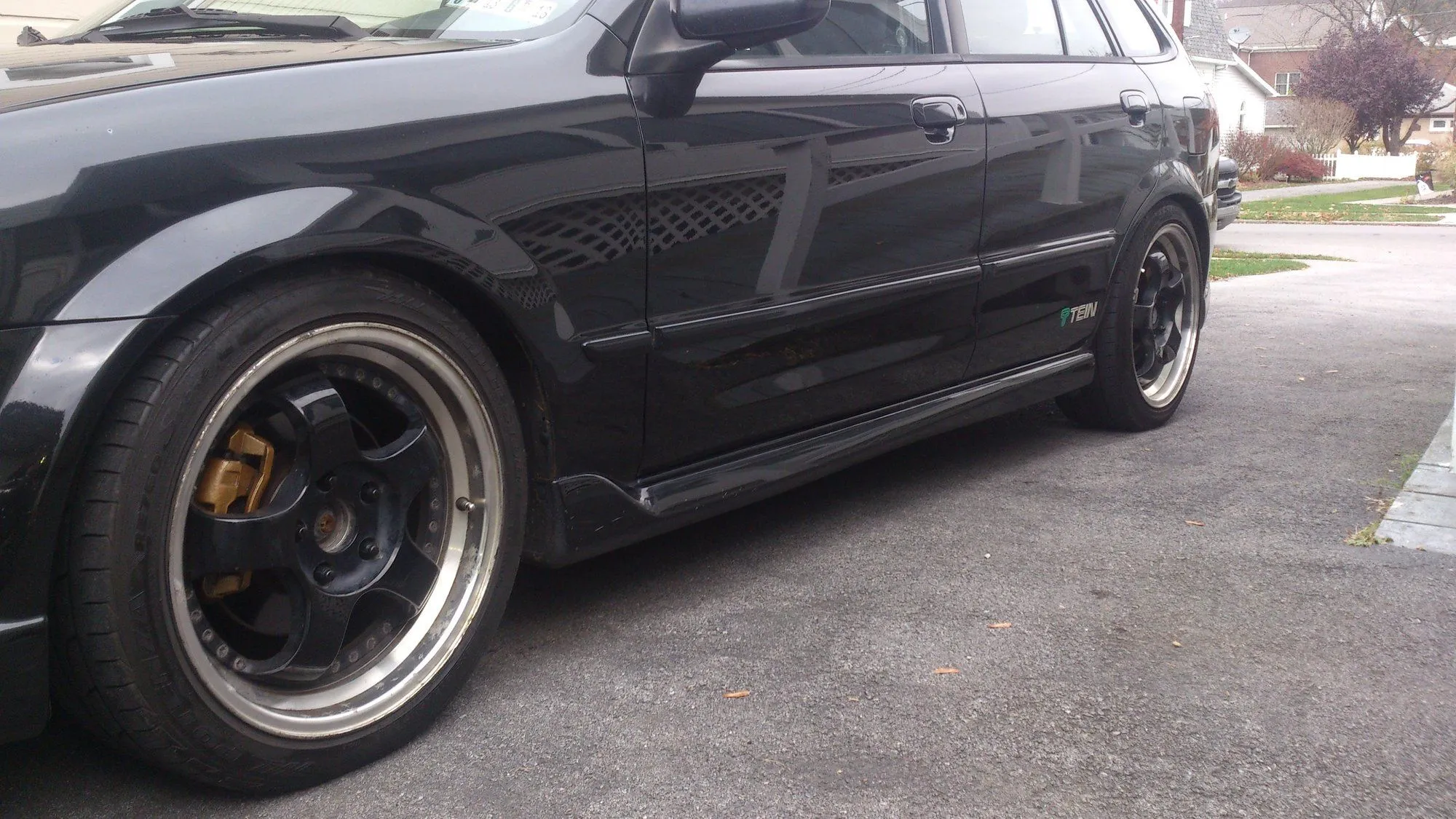

A random pic with the old Rota D2's, before the Tein coil overs (pic is with S-techs, both items will be for sale soon...very cheap!!) This was for a friend looking to buy them, but they wouldn't fit his car, so i'll get more 'actual' car photos soon.

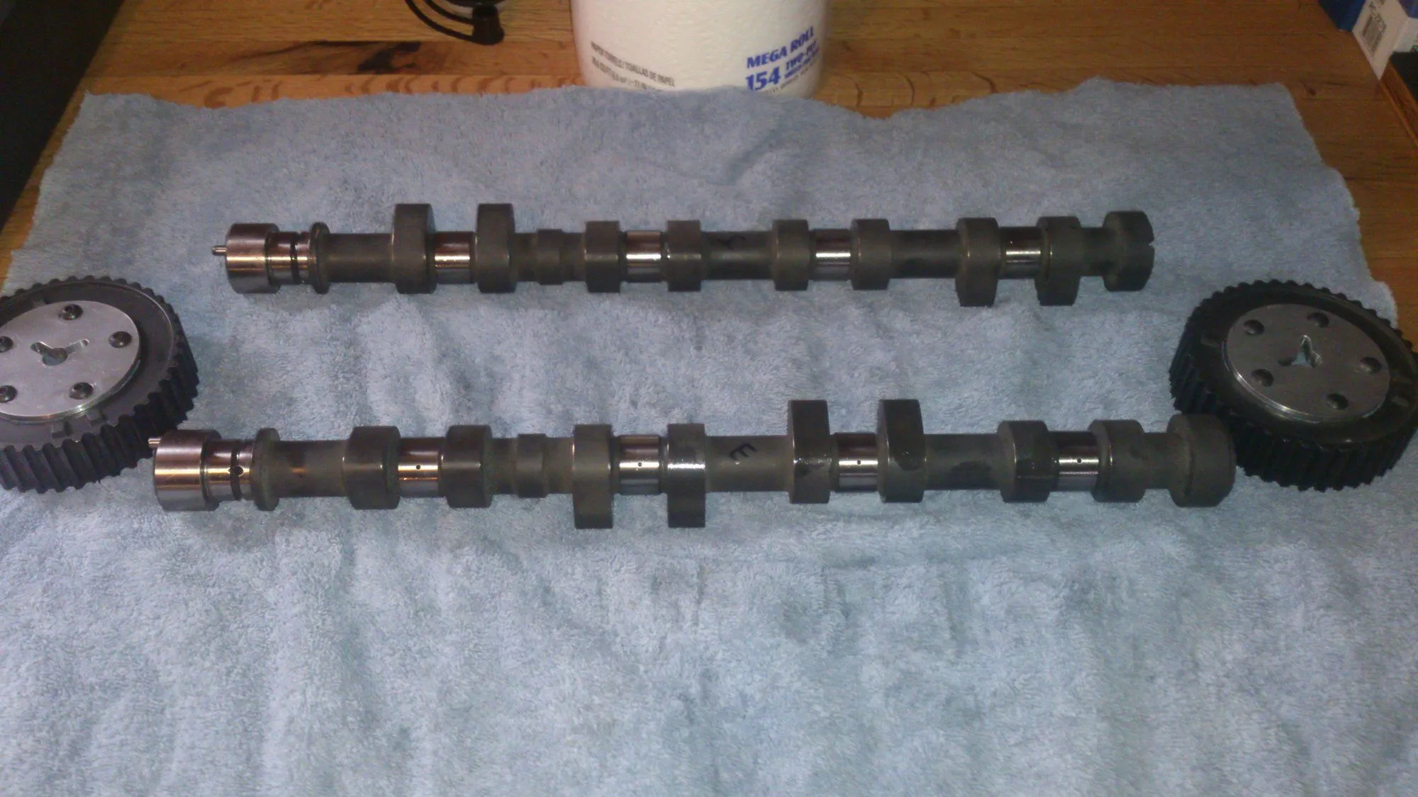

The Twiggy's and gears

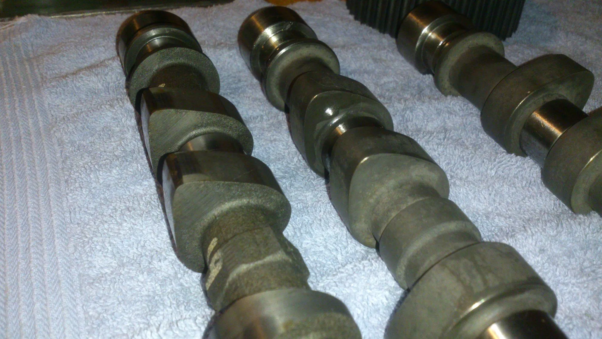

comparison to the Twiggy intake cam with a FS-ZE intake cam (little dark, but you can sort of see how much of a difference in duration these have)
the gauges, i'll have more for these once installed. They were made to match the factory lighting at night. Check out speedhut.com Great prices and they'll do custom overlays and logos if you want. You also pick nearly any color needle, type of font, color of back overlay, type of bezel, etc...for no charge...
