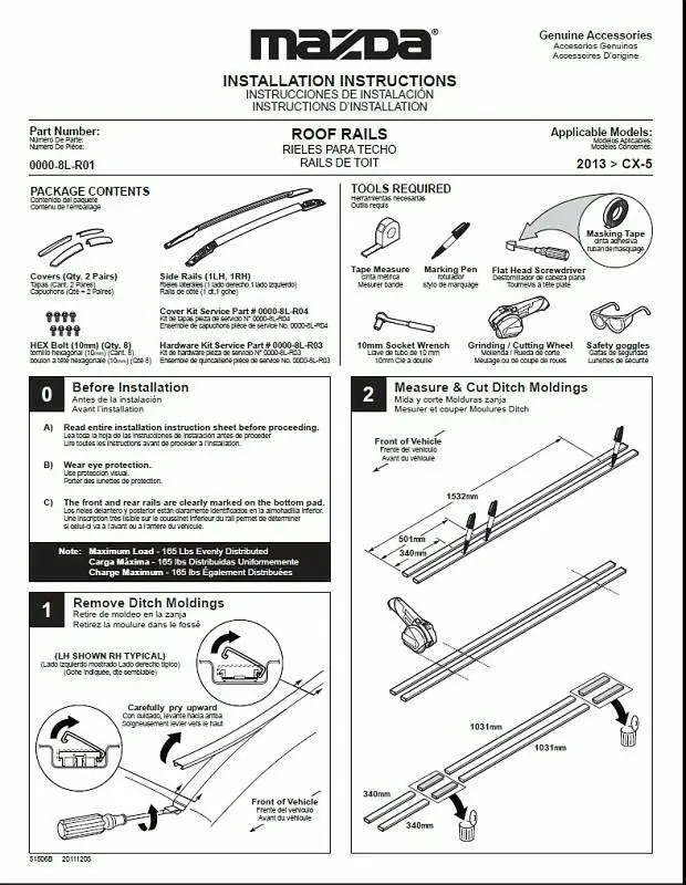

The factory Mazda roof racks when installed by me at the dealership require the metal rails to be cut at the mounting locations and then the front and middle sections are retained and the rest is thrown away. Where as with Mazda 3s, there is a factory replacement roof rail to install.

The brackets are still there, underneath the roof rail. They look the same as the ones pictured in this thread. So you have to pop the rail guard (the black piece) out of the rail and cut it with a cutting wheel at certain points. The in pips back into place and you can bolt the roof rack side rails onto the brackets.

Your vehicle looks to already have the tap out access holes for the factory brackets so that part probably won't help. The factory Mazda3 rack uses a threaded section of rod that goes into each of the brackets (about 4-5" long and then a nut is threaded down to the base of the bracket to lock the rod in place. You could use that technique and pass a roof rack price over the threaded rod and then lock it in place with a second nut and lock washer.

I have a how to here for US-CAN CX5, pictures may help you...
http://www.mazdas247.com/forum/showthread.php?123815898-Roof-Rails
but for people outside US-Can it is another ball game since the black brackets do not exist. I am sure it can be done, but personally if I was to do it I would do it correctly, remove the liner etc.... to make sure there is enough support and isolation.
