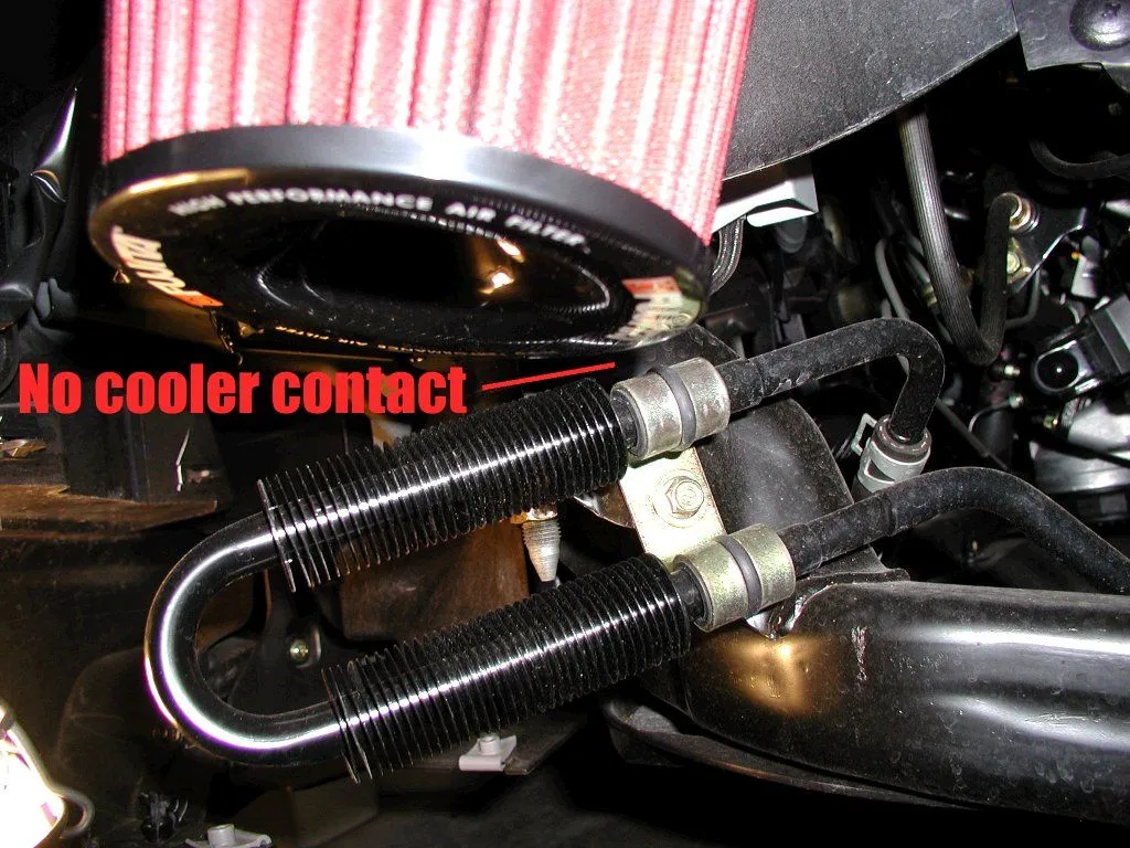

I'm almost done installing the CAI for the Mazdaspeed6. The problem is the air filter is resting on the cooling coil in the wheel well. Does anyone know if this is going to cause a problem, or what that little coil is?
Do you mean this? Coil / heat sink? I do believe it is for the power steering.

Toybiz
yeah I have since redone the install making sure all the hose clamps etc were tight and so forth, now the filter sits a little higher no longer have contact with the power steering heat sink.
