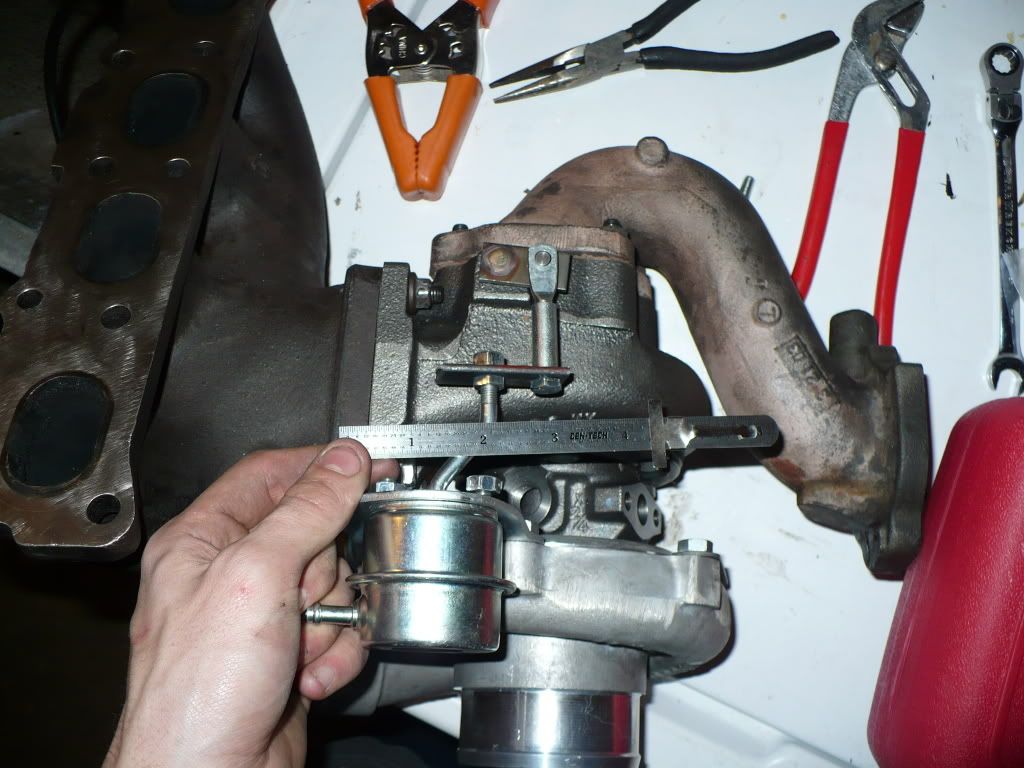

Im installing the turbo now im having trouble with the actuator it hits the bell housing how can I fix thiis
Did you get a specific bracket for the GT28?
If you are still using the actuator that came with the gt28 you can clock it more and just make a small plate to offset the actuator rod.
like so
Got it on I welded an extension on the actuator and modified the bracket but pushing 9psi
