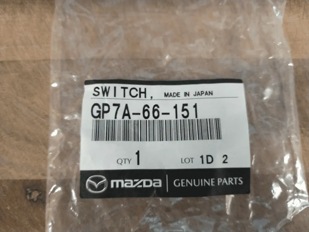

I just ordered an ignition switch from MazdaSwag. It wasn't much more than the Standard or Beck/Arnley part on RockAuto. Got $2 off shipping using code "SWAG."
Part Number​
Part Name​
Price​
Quantity​
Total​
GP7A-66-151​
Ignition Switch​
$41.36​
1​
$41.36​
Subtotal: $41.36​
Estimated Shipping to 75209 via Standard Shipping: $8.93​
Discount: -$1.79​
Total: $48.50​

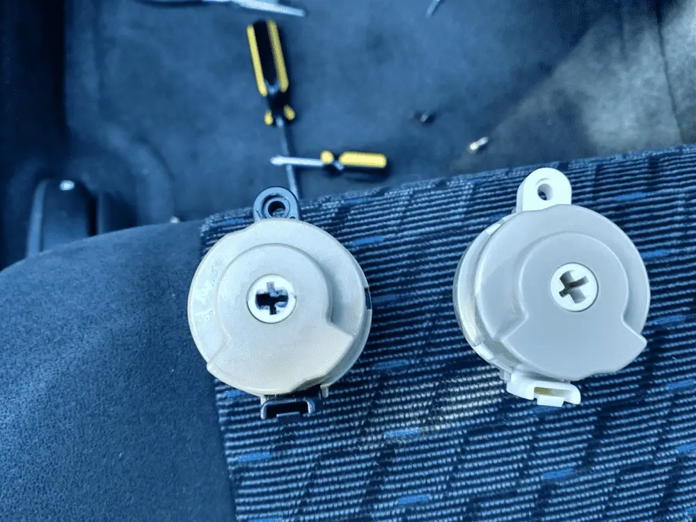

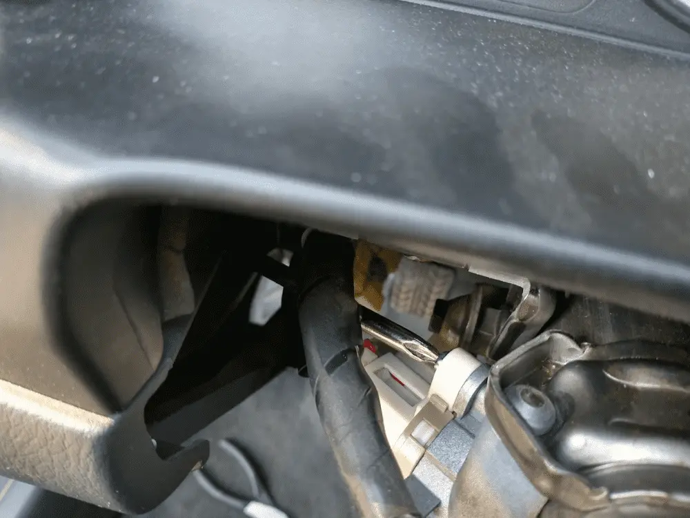

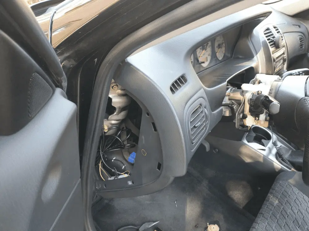

Installed my new ignition switch this afternoon and thought I'd create a new post. In the YouTube video I watched, the guy used a right-angle screwdriver because he couldn't easily use a regular or stubby screwdriver. However, if you remove the access panel on the left-hand side of the dash (hidden when door is closed), you can use a full-length Phillips head screwdriver to pretty easily loosen and tighten that one problem screw. I didn't notice whether this approach had been discussed, so wanted to share because removing that screw is the hardest part of this job if you don't go through that panel. I used trim removal tools to pop the panel so I didn't scratch it.
Starting the car was failing about 10% of the time and that's not exactly horrible, but as discussed it would only have gotten worse. And of course, I could have spent a lot of time (mine - and let's be honest, all of you guys' :p) diagnosing a no-start problem later on if this potential fix had somehow slipped my mind. The part was from Mazdaswag (see above) with a Mazda sticker that said Made in Japan.
Panel:
View through panel:
Phillip's disembodied head:
Old and new parts. (Note the grease on the old which had perhaps migrated from the lock cylinder? There's no mention of lubricant in service manual.):

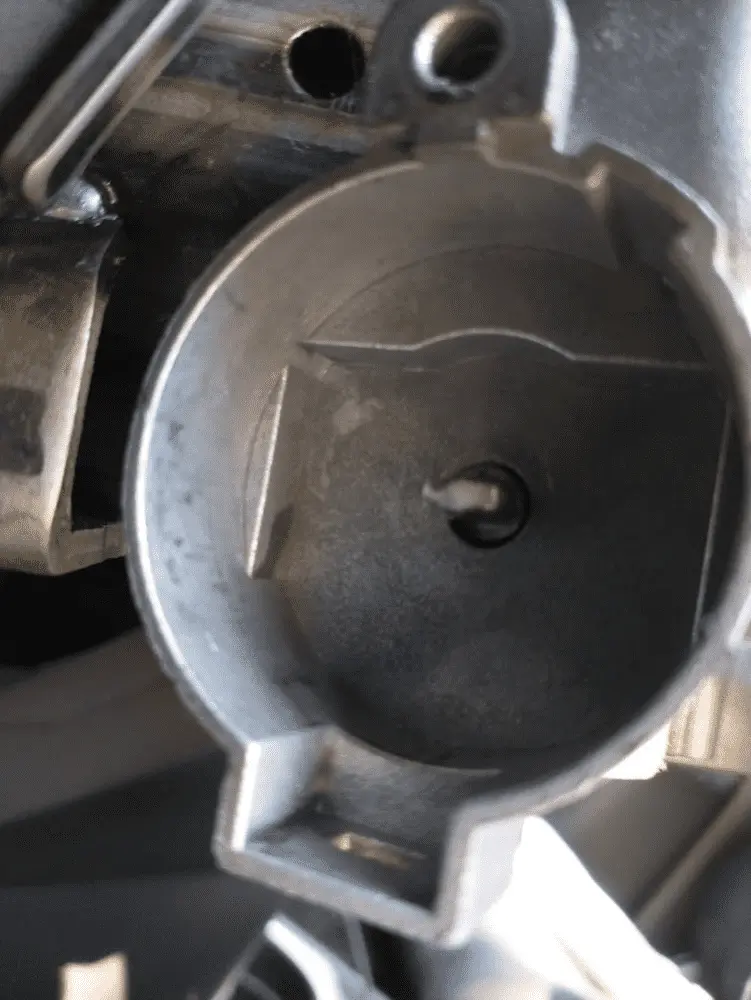

Place where the replacement part goes (grease visible):
Got a good deal so went OEM:
Did mine about a month ago, used a ratcheting 90 degree screwdriver to reach that SOB.

Seems like you bought the OEM replacement part. Is this the kind of thing you'd buy aftermarket on RockAuto to save some money, or is OEM the way to go?
Keep in mind that our car uses JIS screws (Japanese Industrial Standard) and a regular Phillips screwdriver can easily strip a JIS screw head, if it is tight or seized.
If we're comparing Rock Auto's price of $38 and $41 respectively (plus shipping) for the two brands that I've actually heard of vs. Mazda Swag's genuine OEM part that's made in Japan for $44 (plus shipping)... I mean, that was the easiest decision I've made in years. Go buy the OEM part from Mazda Swag! :)
