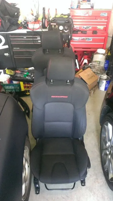

I picked up a lovely set of black Speed3 seats this weekend. :) Got a hell of a deal, too. I can't wait to get them installed!
The bottom cushions only measure about 1-1.5 inches longer than the ones in the 5, but they certainly feel much longer! I think they'll really help. (cabpatch)
I'll post up installed picks when I make it happen. I'll also be installing seat heaters in them before I put them in. :D

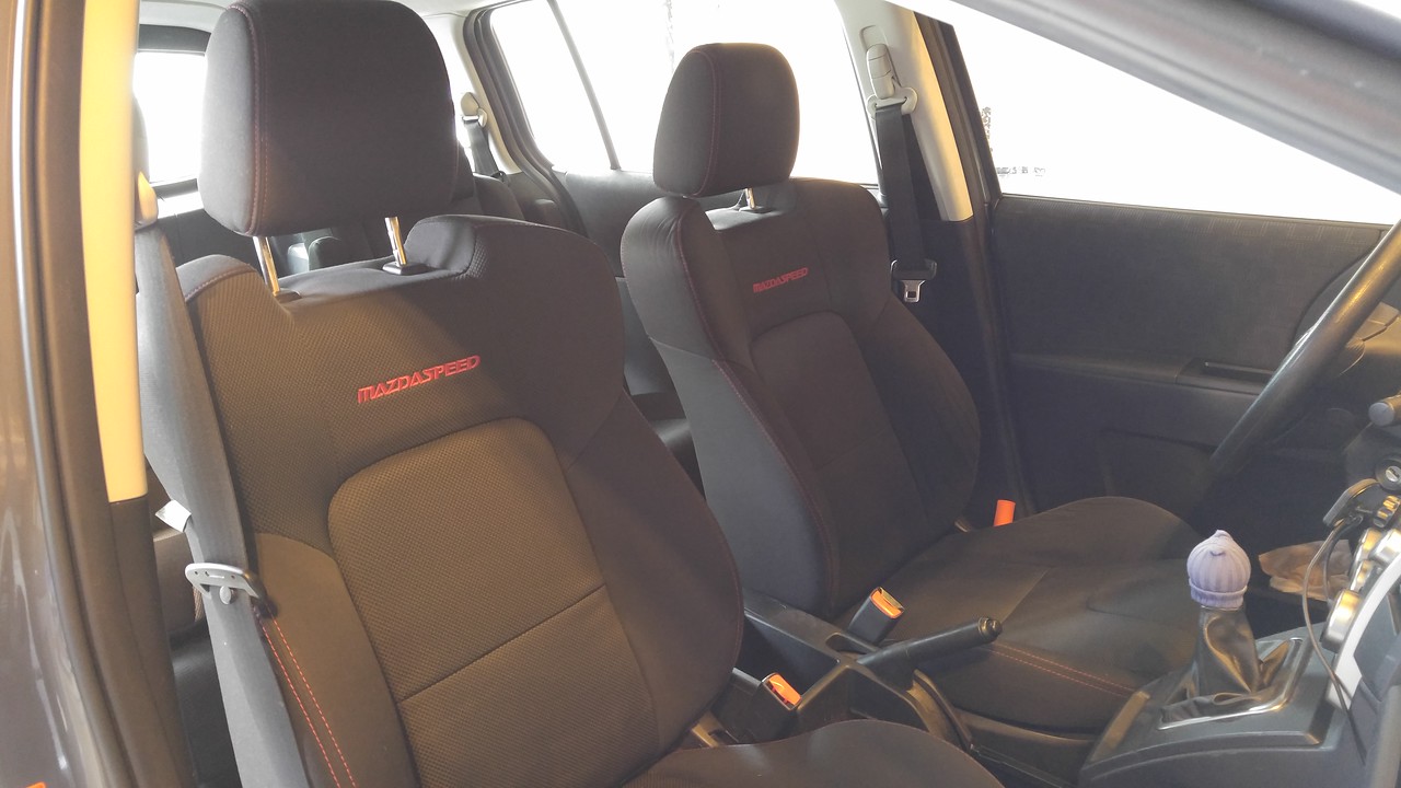

I got the driver's side seat in tonight. I'll report back tomorrow with driving impressions and a few notes about the install to supplement the original post.
Picture! :D
Looking good! :)

Wow Foolish, you waste no time. Looks good!
Thanks! ...and thank you for the inspirational and instructional post!

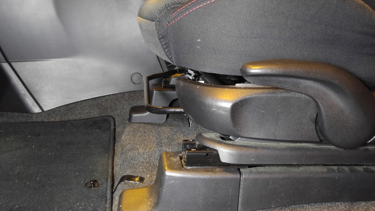

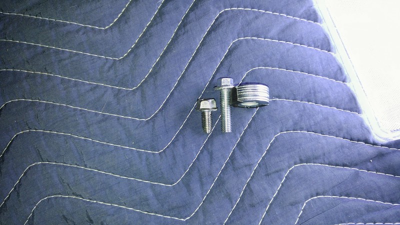

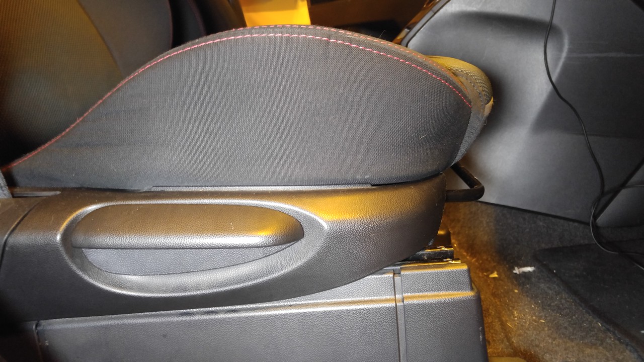

I also raised the front of the driver's seat to try to address the thigh support issues I've been having with this car. The longer base of the Speed3 seats seems to help, but I think raising the front will help more. I bought longer bolts to replace the front bolts that hold the seat pan to the base/sliders. Here's the original bolt next to the replacement and the stack of washers I used to raise the seat:
...All in place:
The gap between the seat bottom and the plastic trim give a good idea how much It raised the front of the seat:
The fit of the passenger side, for comparison:
I haven't had much seat time in the 5 since I did the install, but it certainly feels like an improvement from a short test drive around the neighborhood.
