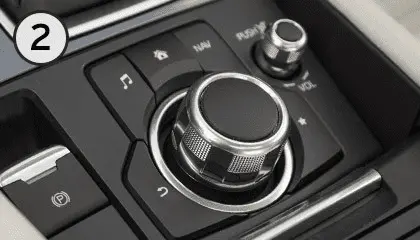

FYI, the shortcut to reset infotainment without restarting car: Press and hold the Back button, the Nav button, and the Mute button for at least 10 seconds.
The other major shortcut to switch between Carplay/Android Auto and Regular Infotainment is to hold the Home button for several seconds.
Chocolate,
I think you only need two with newer models. Forgot which two of the three.
If I guess correctly, no need to hold down *Back*.
