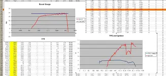

I was looking at the dyno, and looking at where the car starts to loose power. You'll notice the first place in loss of power is right around 4800 rpm. On my logs, I am showing that thats where the throttle plate starts closing, a clear distint difference is in tps voltage as it drops below 4.0 volts.
The second place is where the car falls off pretty significant. This is about 5200 rpm. On my logs, the ignition is cut by about 30%. And you can see the power being cut accordingly.
attachment.php
Next, look at the dyno graph at 5700rpm, that when it picks it's power back up. The Ignition is back up slightly at this point. I'm not sure if the car is protecting itself, or if it's just something weird?
And the Boost controller function worked pretty good today, with my PSI set at 19psi, it just about hit it spot on. It should be ramping up faster, I think one size jet smaller than 0.047 will work nicely to remedy this. I have to order one as that was the smallest I had.

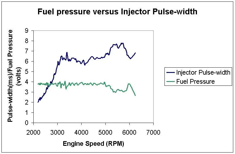

Unfortunately, for power production, there is a ceiling, and it seems to be a fueling problem? I don't see anyone hitting too much more whp than I have without some fueling resolution. Another Speed ownder with upgrades similiar to mine ran into this ceiling as well. I sent Jordan my data, and he posted this. The fuel pressure and injecter pulse width. You can see why my car probably started pulling timeing. You can see the two starting to diverge, as my car started to run into a fueling problem. The high pressure pump was probably done at this point?

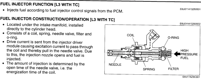

I could be wrong here, but what you see in that post is the increasing of the injector pulse width, along with a drop in fuel pressure. What's happening with the duty cycle is, it's telling us that it's taking longer for the injector to introduce the proper fuel into the cylinder. As this number increases, you start to run into lean spikes and potentially detonation.
Injectors become unrealiable/unpredictable when the duty cycle starts to go above a certain threshold.
But at the same time we see a corresponding drop in fuel pressure. So what's happening I think is that since we have less fuel pressure, that means less pressure at the fuel rail -> less pressure at the injector -> less fuel coming out of injector -> injectos stays open longer to inject proper fuel.
Less atomization of fuel probably as well.
So I don't know exactly what caused this? Wether something throttled back the fuel pump? Or if the knock sensor picked up knock and cut back timing?
The car definetely cut timing by a huge amount, I'm just not sure what caused it? But it seems to be a lack of fuel.

It's gotta be one or the other(injectors or pump)? I think it's the pump that's done.
We've got two.....low pressure in tank, and high pressure cam driven.
Replacing even the low pressure pump might help remedy the problem?
ah..you are right i'm sure. i was almost under the impression that something was cutting back the fuel, not that it was just running out and trying to make up for it with a wider pulse. but after looking at the charts, and reading your explanation. i think thats it.

If I had more dyno time, just for grins, giggles and safety, I would cut the timing waaay back, and make a pull while adding another few percent in that area of increased pulse-width(since you can manipulate fuel pressure with the EMS).....and just to verify the fuel pressure is not being commanded lower by the ECU for some reason.

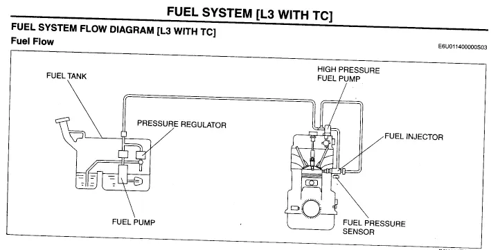

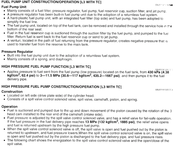

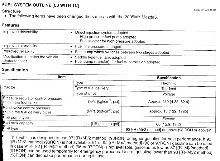

I wonder if its possible to use the SVT Focus high pressure pump inside the fuel tank. If anything, it may keep the volume up to par. I dumped my low pressure pumps in my lightning and went to high pressure focus pumps. It made a huge difference on my tune and knocked the injector duty cycle down by an easy 20%. I didnt have to jump up to 55lb injectors by doing this.
I cant find any info on our high pressure DISI pumps. Ive been combing the net and powerstroke diesal sites all week. Its a tiny little guy with an off connector to the fuel line. Maybe the Audi guys have a solution for their DISI yet?
I've been wondering this as well mayne? Would be a nice solution and seems like it might at least help and get that duty cycle back down and fuel the car for more whp.
Got any links or write ups to guys doing this? I'd like to read up on it.
Hopefully within the next few months, I'll be ditching this car as my daily driver and turn into a garage project.
Did it myself, as with other lightning and 03/04 cobra guys. Head over to modularfords.com and check out the forums. Lot of threads on it. I'd be willing to do it but i dont have the ATP yet. I can give you links to the pumps.
Part number for SVT focus pump: 3S4Z-9H307-BC
http://www.speedconcepts.net/product_info.php?products_id=687
