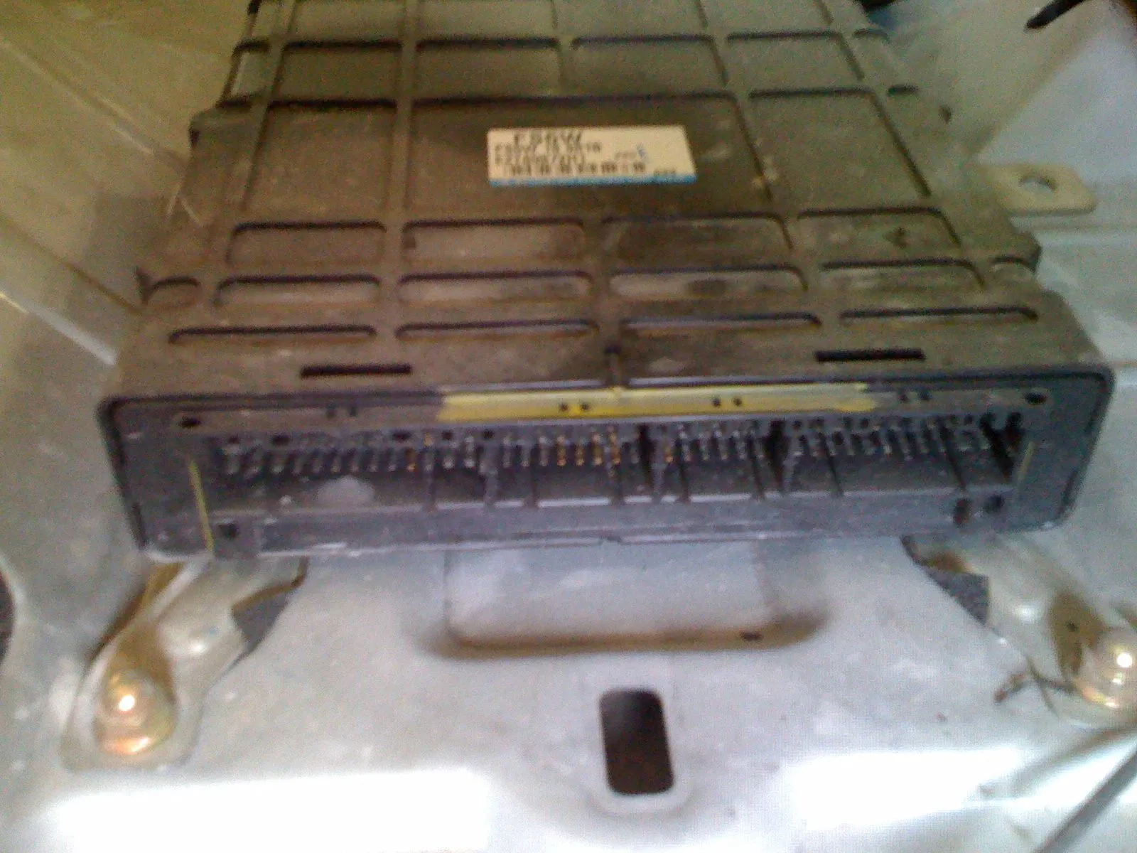

If you have FS-ZE from Mazda Capella always with auto tranny you have more problems. Crank pulley, housing for temp sensor, termostat body, heater tube, throttle body, crank pulley, average pan are the different. You dont need FS-ZE ECU, it made mitsubishi in plastic black house, have obd 1 and different harness connector.
