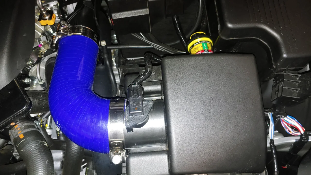

This is actually pretty close to what I want to do: replace the snorkel with a custom one and reduce the number of turns in the air path. I just don't think I'm willing to pay $400 to do so.
You can see the dyno result at the end. The engine breathes a little better. I'd like it to be more straight and larger in diameter but it seems like a solid design compared to many others.

Gee, my $70 AIR BOX CAI mod made this much power, protects the engine, filtration and water and make great low end torque.

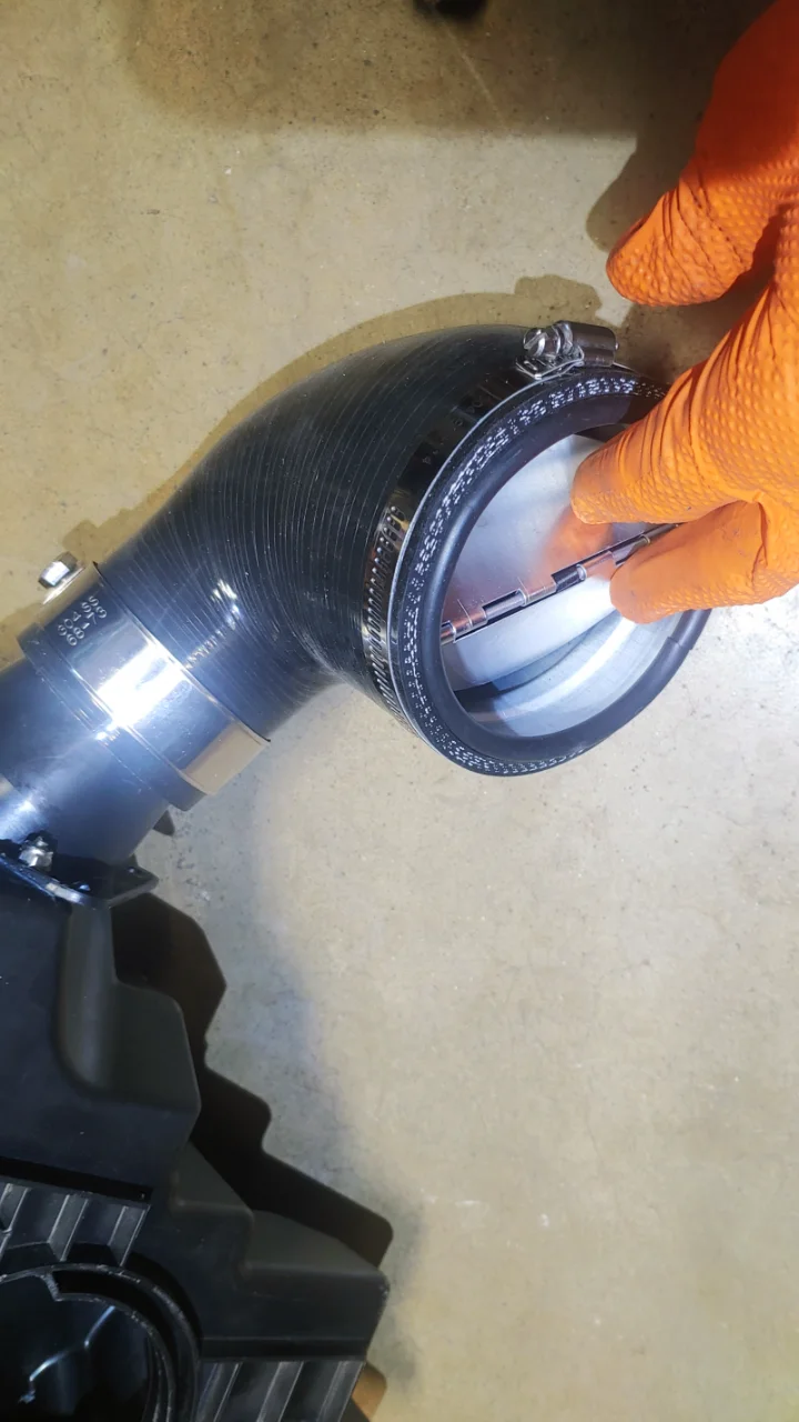

The varrible flow damper idea give the best of both worlds, low end torque and top end power. We first proved this on our Cummins turbo diesels. The same idea works on these baby turbos. Mazda is using a NA air box with a thicker filter....
Variable flow, the damper meters in air based on load....

Don't feel bad, not many of the CTD guys, who are a hands on bunch, build a Varriable Flow CAI...
I like the variable flow idea. Keeps velocity and torque high at normal driving loads, but lets the engine breathe when needed.

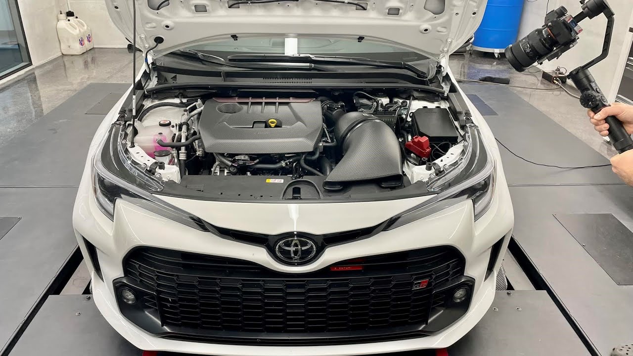

Coincidentally, I just came across this video which shows the GR Corolla has something similar built into the stock airbox. It uses a vacuum solenoid.
I've seen variable damper setups in several OEM intake designs over the year. They were more prevalent in NA vehicle that have no turbo to rely on. Toyota had one in the air box of my old 2000 Celica GTS. NA, 1.8L, 180hp, 8400rpm. It was used to maintain livable low-end torque and allow the engine to breath in the upper RPM while on the big cam. Nissan has them in their intake manifolds of there FWD based VQ35Ds circa 2002+. Ford used one in its Focus SVT of the same year. No surprise it works given how many OEMs used them in the past and in the GR corollas case present! I could certainly see grabbing a 2nd air box and do this mod.

My varrible flow CAI is pretty crude in comparison. I don't know what rpm/boost it starts to open. This could be determined on a chassis dyno.
Since my set up is equal or better than the high priced spread, afe, it must be pretty close and keeps low end torque.

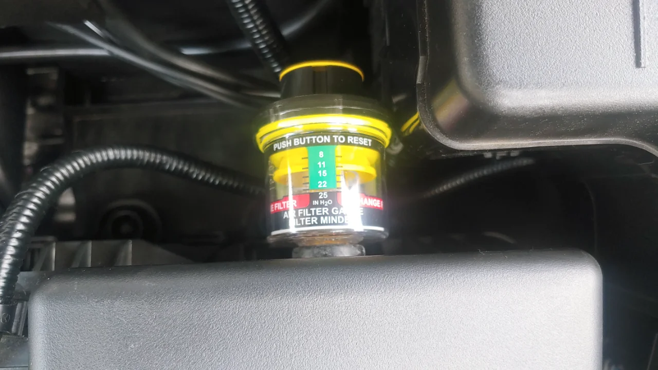

You can install a Filter Minder on your air box. It will show how much vacuum the engine pulls.
This device got me working on a varriable flow set up.
